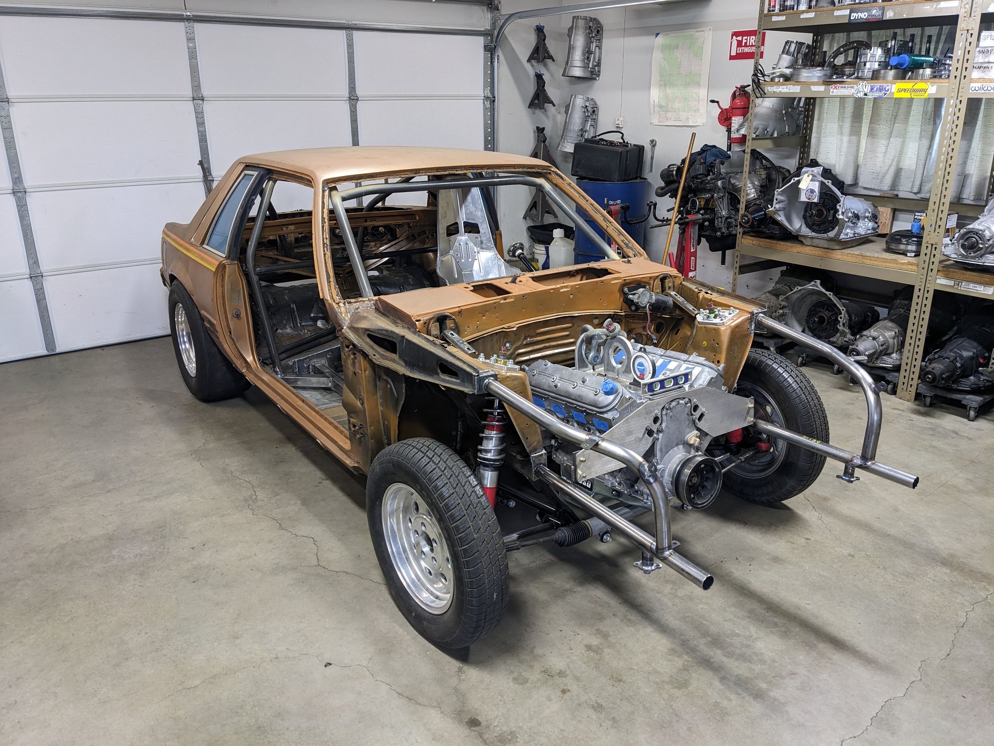

it's been a pretty busy "off season" for transmissions, which I'm not complaining about. Just excusing myself for not having this thing already running and driving.
still need to get the driver position sorted so I can put the door bars in, but it's made some progress!

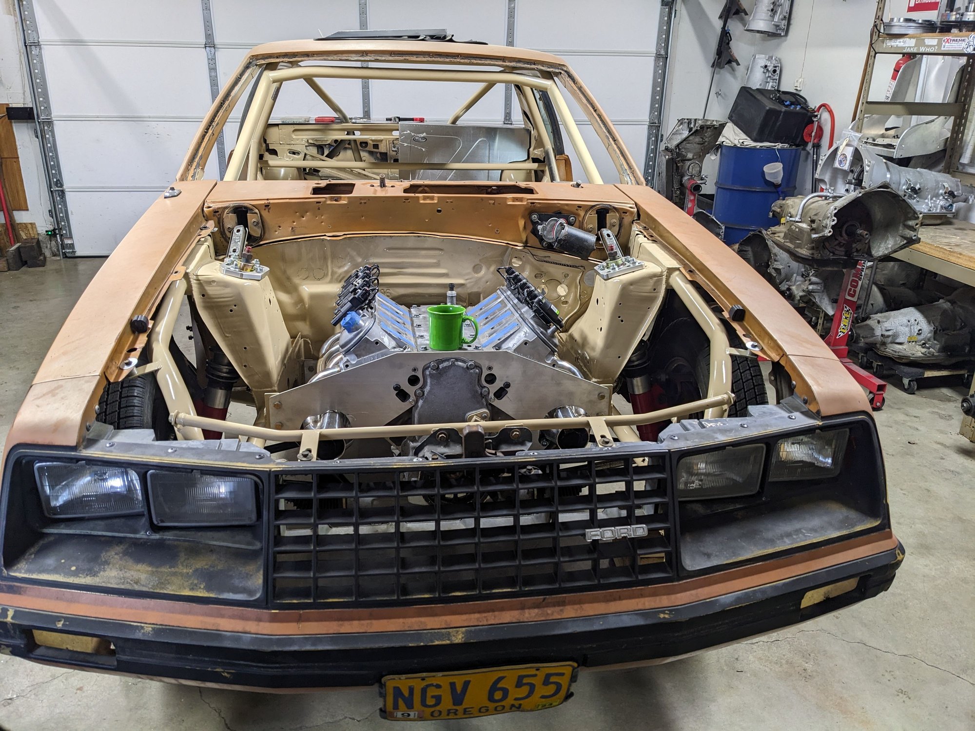

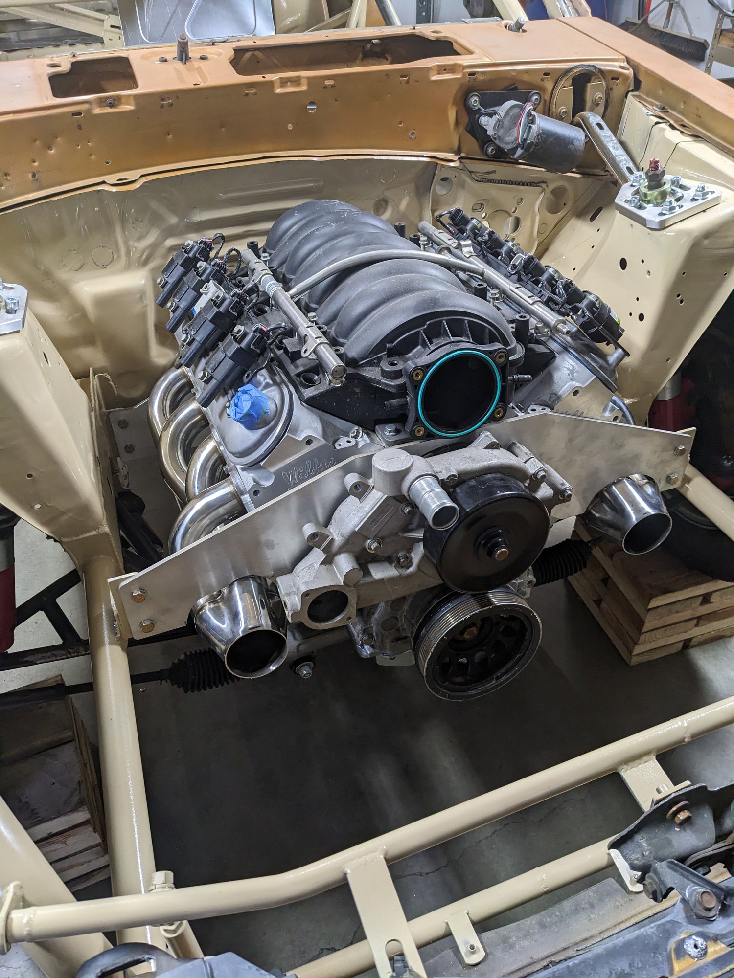

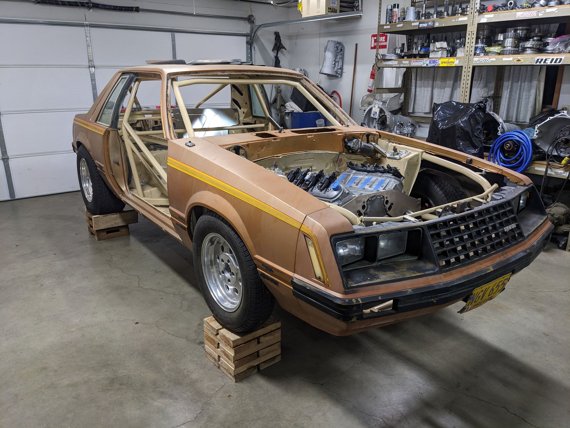

been making a little progress here and there
motor in and trans xmember built. hung some sheet metal so i could check hoot clearance. a TBSS was never gonna fit
pancake inspecting
cut the headers to give me more room for the turbo kit
grabbed a car intake from my buddy Travis (and a waterpump). just need to sort an alternator bracket next

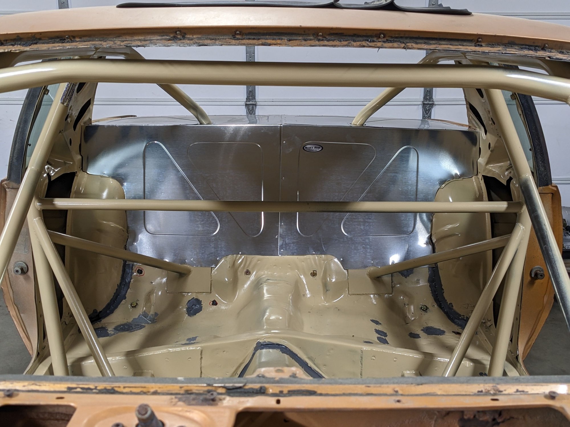

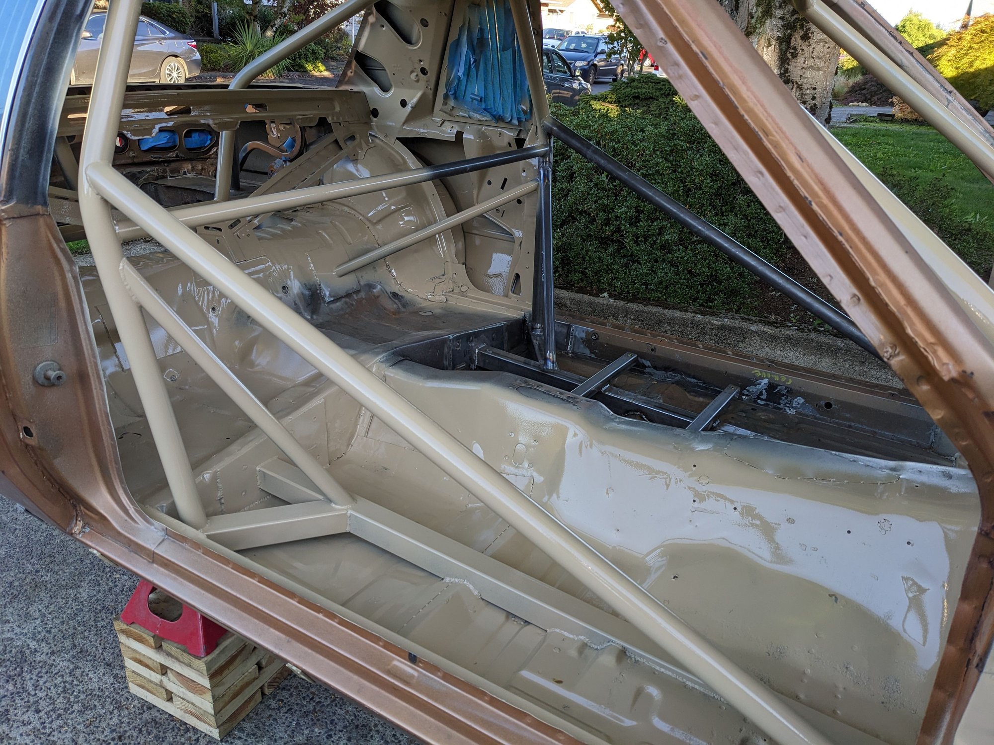

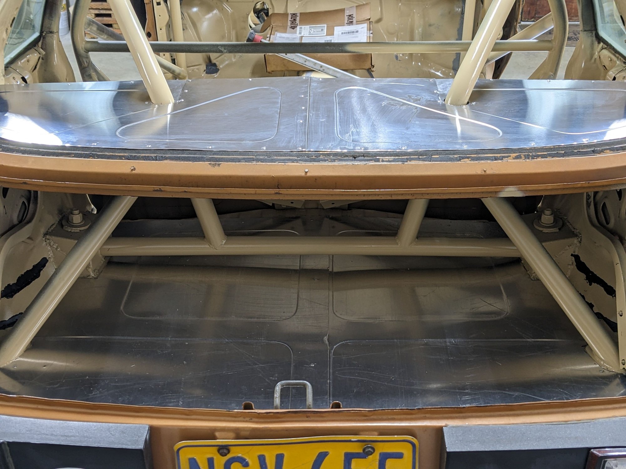

rear seat firewall installed
rear package tray and trunk floor installed
just waiting on some flexible fire barrier sealant and then some paint touch ups and I can move onto the fun parts like turbo plumbing

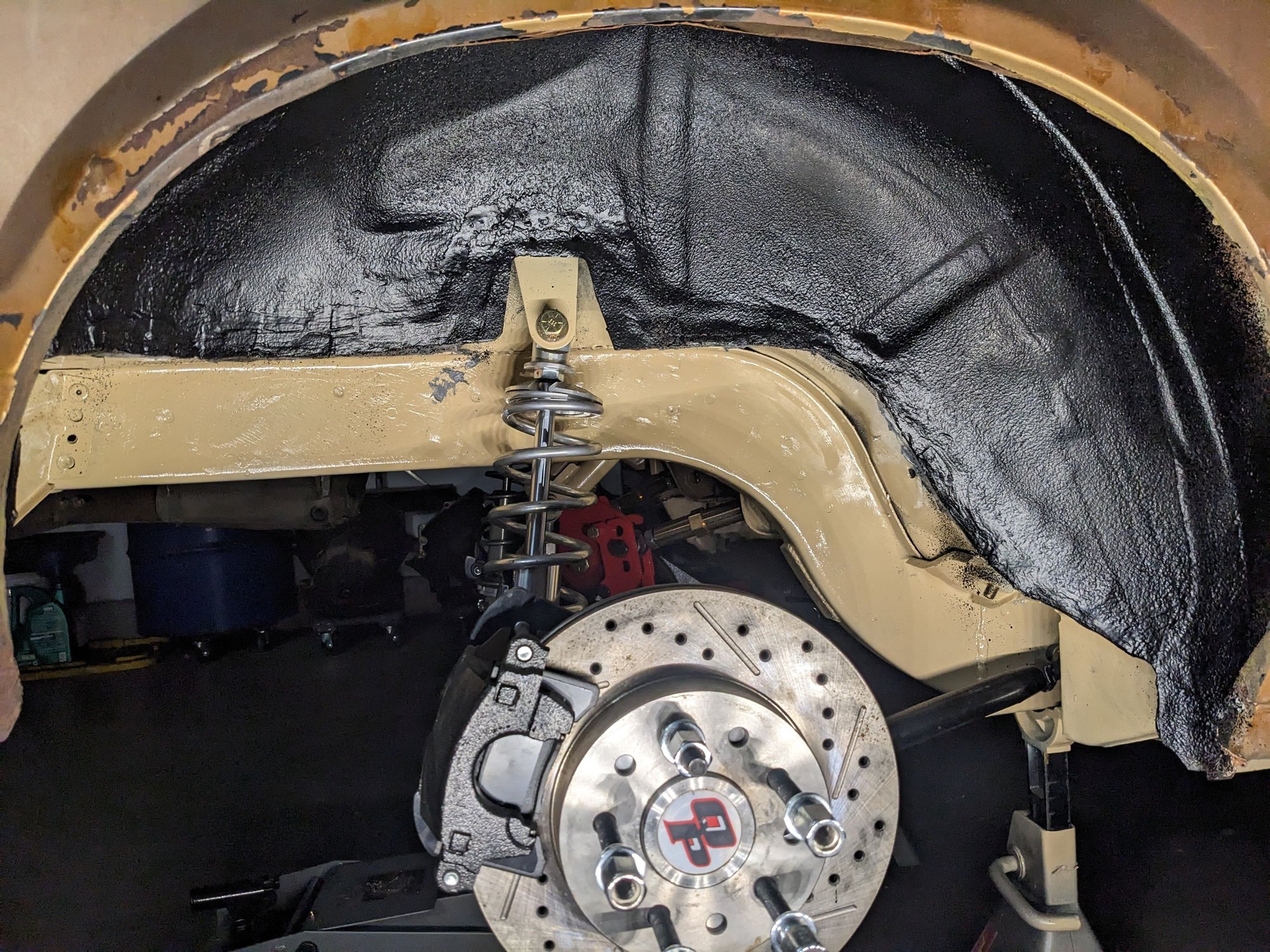

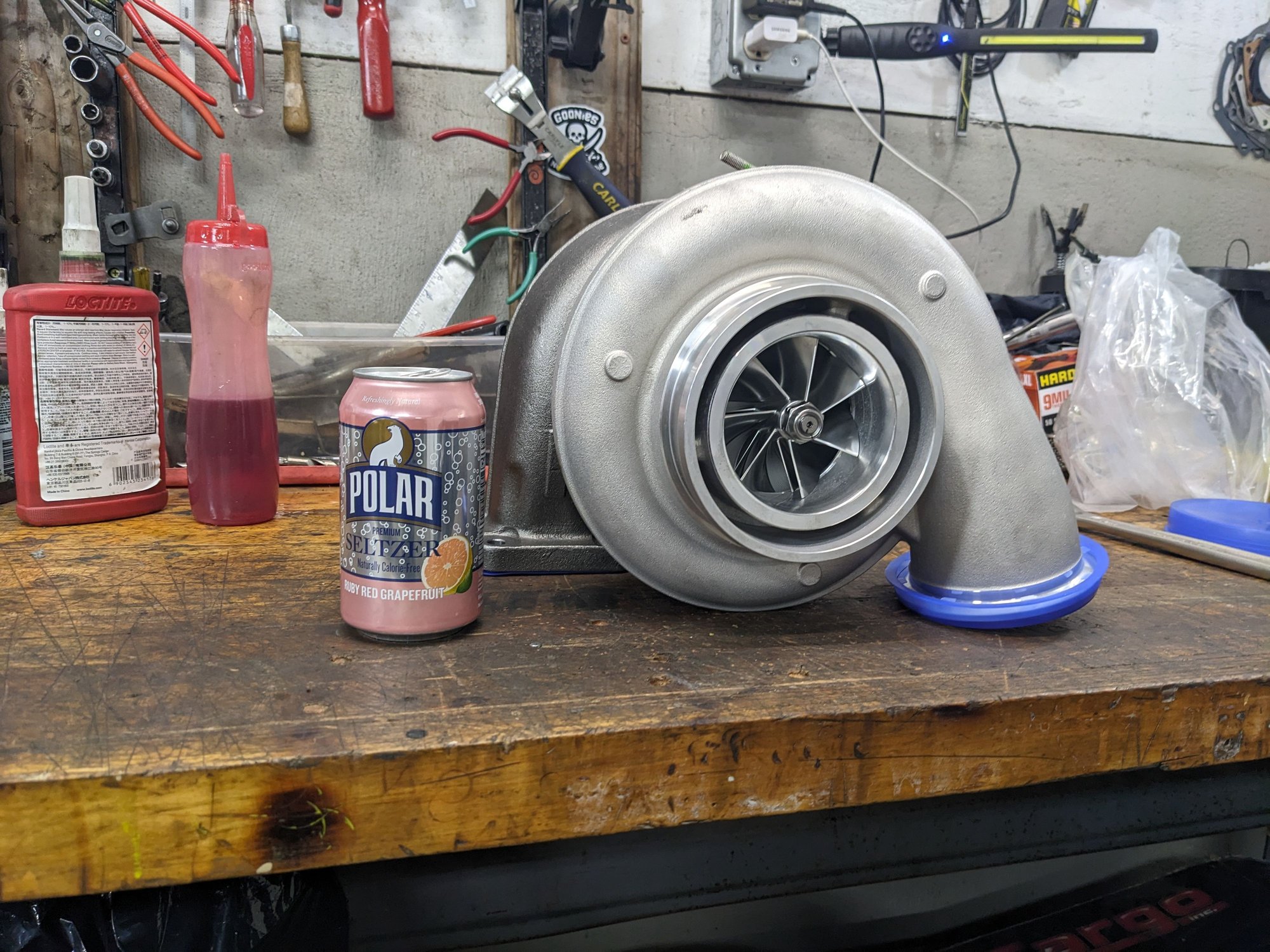

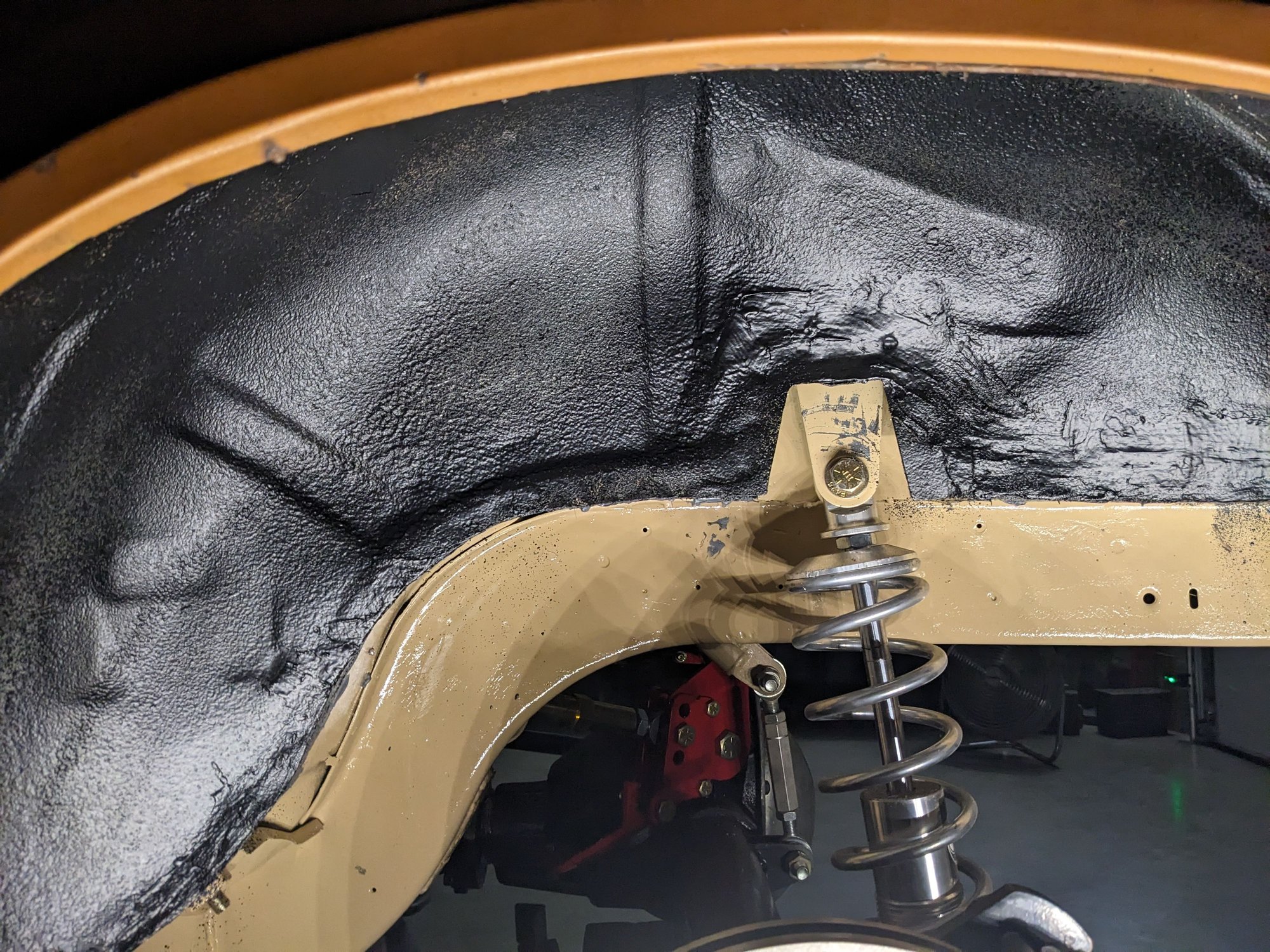

turbo on the way. went with the T6 HD8088 from Forced Performance. looking at treadstone intercoolers but open to new stuff. especially if they cost a bit less and are the same quality.
anyways i got some undercoating in the wheel wells.good nuff for me. need to seal the firewall with proper 3M flexible fire sealant and then touch up some cage paint. thats is gonna be a good day when i can work on something other than the cage and the floorpan!
