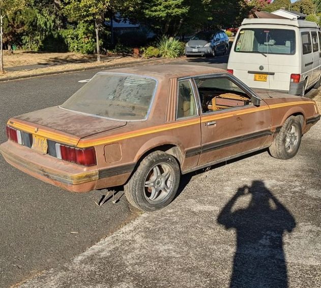

hey fellas long time no see! I am starting down that rabbit hole once again.
brought this turd home this summer. was on the back burner finishing up the busy season for transmissions and now it's the heart of winter and I need stuff to keep me from drinkin and smokin my days away

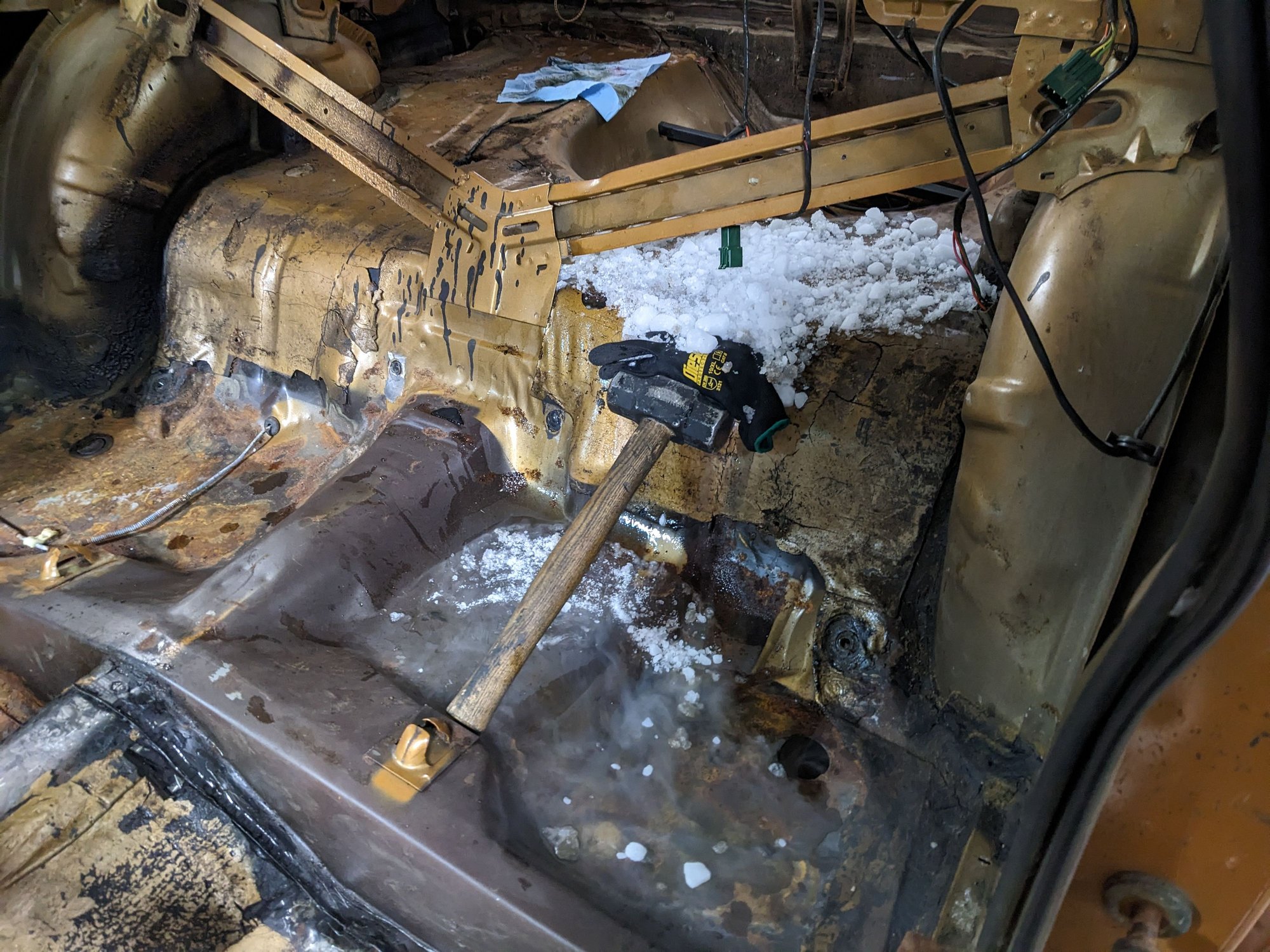

so I hosed all the leaves off and vacuumed as many mouse houses out as I could and drug it inside
first thing was to yeet the interior since it's gonna be a RACECAR
i was about halfway though the dry ice treatment on the sound deadner when i realized the welding gloves i was using to handle the ice released it's dye with the presence of rubbing alcohol

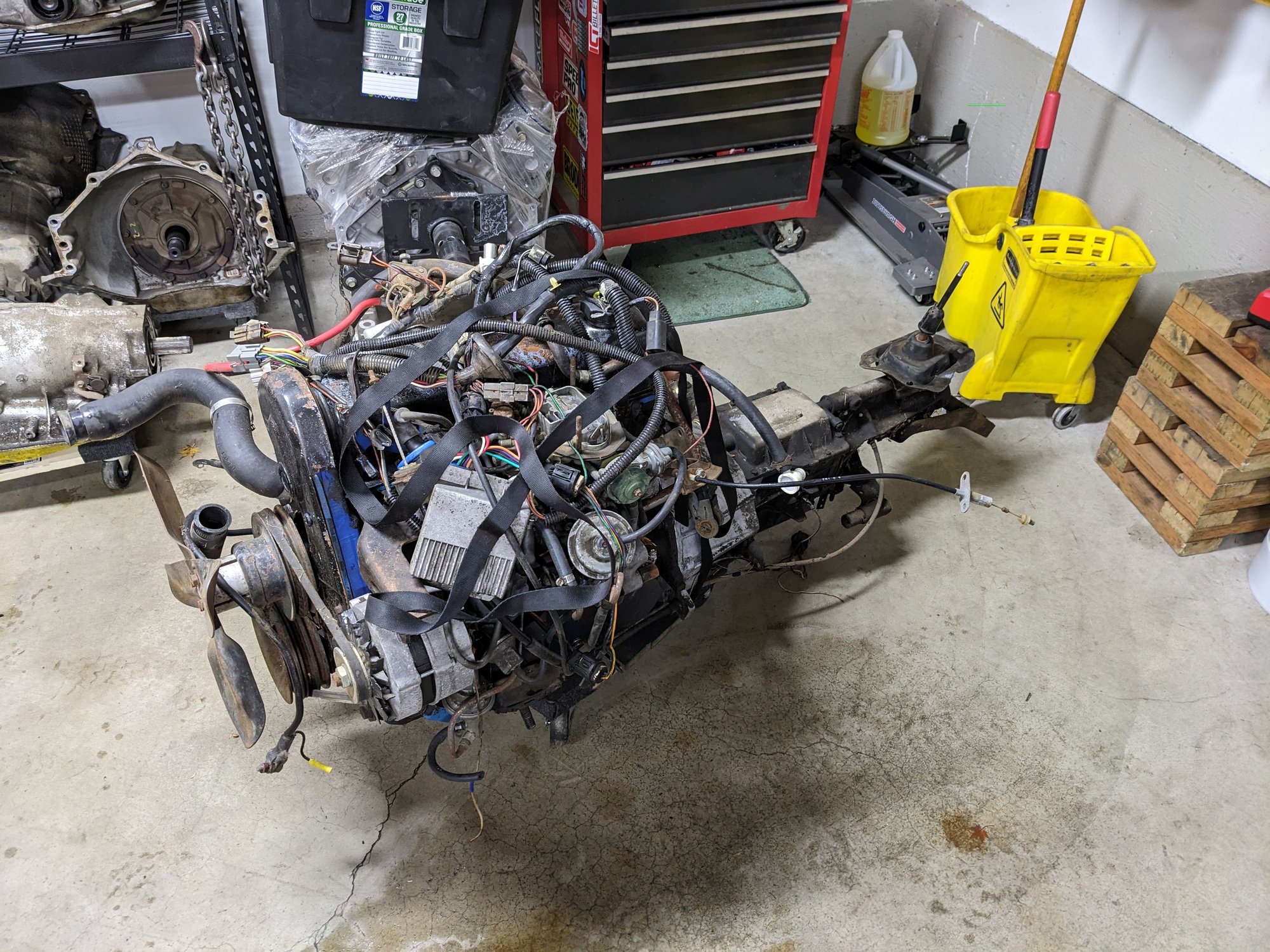

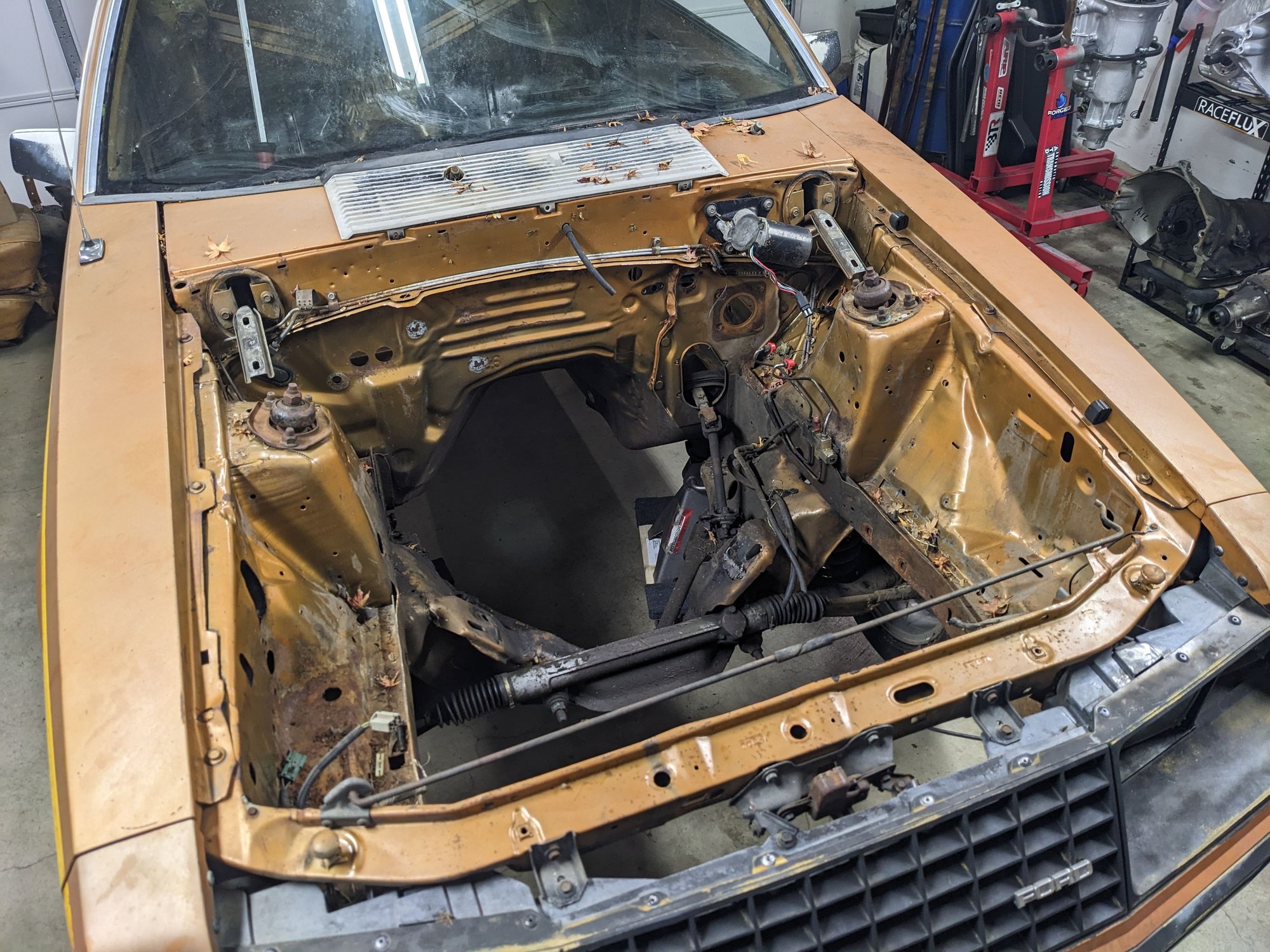

aside from giving out HJ's to the whole smurf village I managed to pull the motor
I kind of wanted to make it run, but a fella from sloppy mechanics facebook was hot to trot on buying the 2.3 Lima/SROD combo
and as per usual, he flaked as soon as I put the effort into yanking it.

i like old notch backs you really just dont see em around like that any more, heck id leave the paint just like it is. thatll be a fun project.

Nice what year is it?

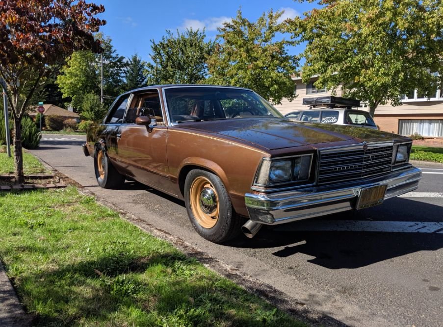

1980, I'm a big fan of these malaise-era **** heaps. It matches my '79 malibu really nicely haha.
Spoiler!

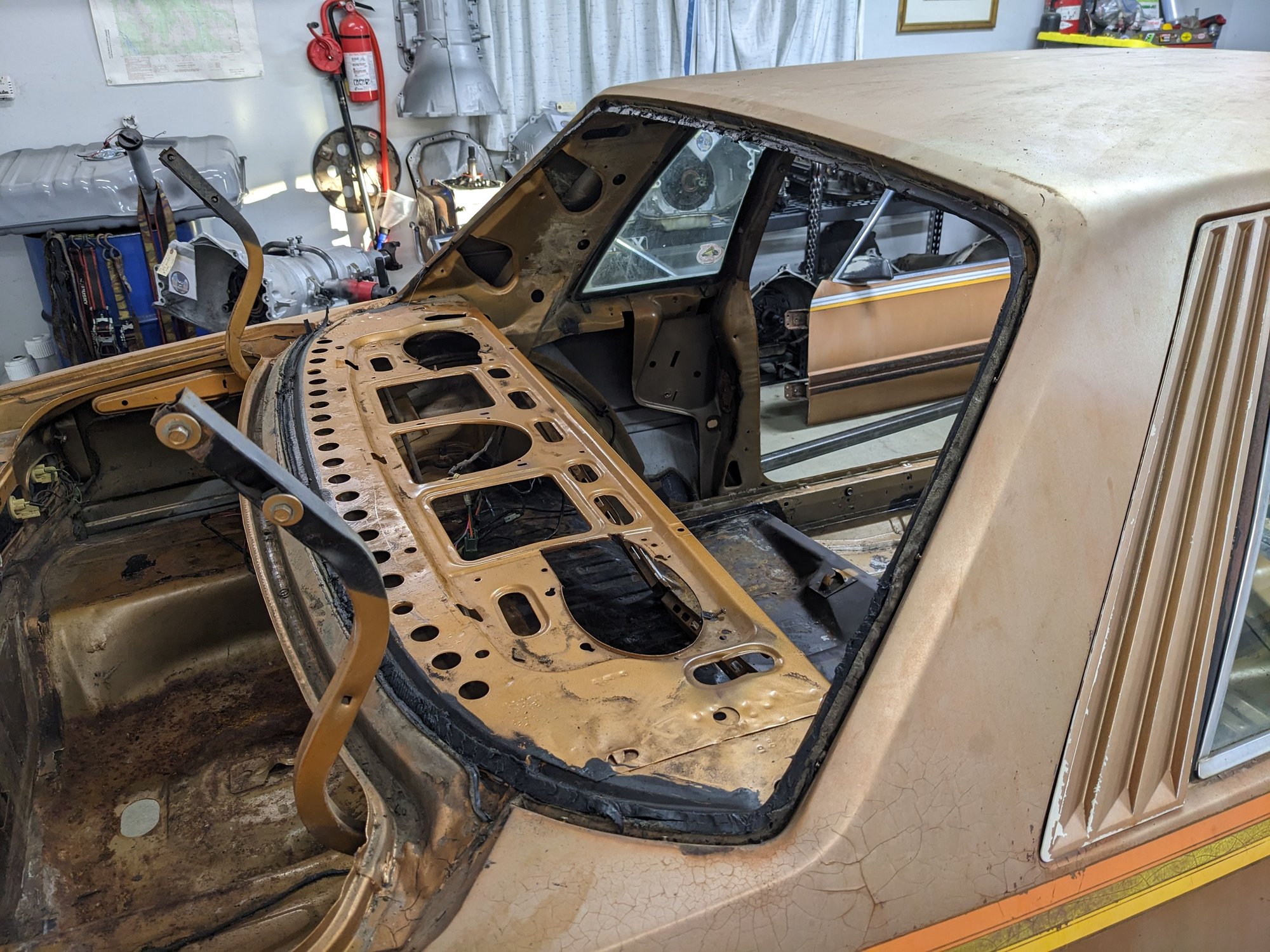

pulled the glass today...windshield didnt make it. Oh well. Continuing my theme of putting new windshields in every car I buy. Such a good upgrade! Glass you can see though!

The backglass thankfully survived and now the car is ready to start cutting up.
I'm gonna leave the quarter windows in for the cage install, just cover them with cardboard or something. They appear to be really expensive to replace and it was kind of a beast to cut this old *** urethane out. How can it be super hard and gummy at the same time!!!! woof my hands hurt just thinking about it.

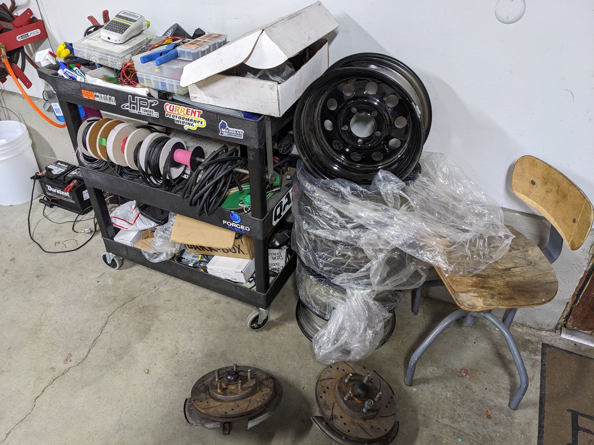

also did some horse trading. dash and heater went to a crazy russian in vancouver and scored me some v8 car spindles w/ 11" 5 lug rotors in pretty nice shape.
gave the 2.3 to an old fella who's building a '51 MG and he gave me these 15x6 steelies.
I'm half tempted to widen the rears and narrow the fronts and run some era-correct wheel covers. We'll see how much time I have after the cage.
