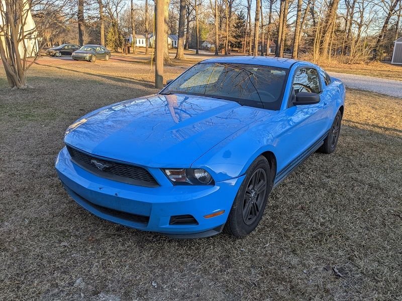

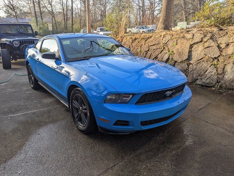

November 2021 browsing Marketplace I stubbled across a 2011 Mustang V6/auto (she started out wanting a manual) for sale. Price was higher than what I wanted to pay but it had high mileage, wasn't perfect, but was Grabber Blue. As MarketPlace goes, it disappeared and reappeared a few times, each time lower in price. In mid January 2022 it got to a price I was more willing to actually look, so as my normal buying plans I found some friends that HATE the cars I am interested in as they will have no attachment to it and they will tear it apart. This has been a successful strategy so...
We went and looked, the owner was young and driving this 45 minutes one way to work and I thought ok it should be ok, so I drove the car around the block and it was HORRIBLE.
When I got back I ask the girl if her father new she was driving a car like this to work everyday? Rattles, squeaks, popping bumping shaking etc. It was bad. If he was there I probably would have had a talk with him.. But she was own her own and this was just a way back and for to work. It was not a Mustang to her, it was a way to work.
I offered her much lower than asking price and she said she would need to think about it.
3 days later she called and asked if I was still interested and if my offer was cash. ( I was looking more as my daughters 15 birthday was approaching and I wanted one in possession prior) I told her that I had found a few more in better shape and told her what my cash offer would be at that time (lower that original) and I wouldn't pick the car apart, I would just come get the car and hand her cash. She said come get it. A buddy of mine picked it up and hid it at his house until it was no longer an option to hide from my daughter.

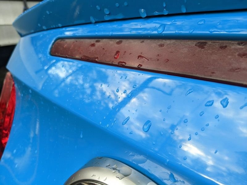

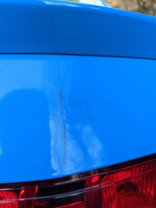

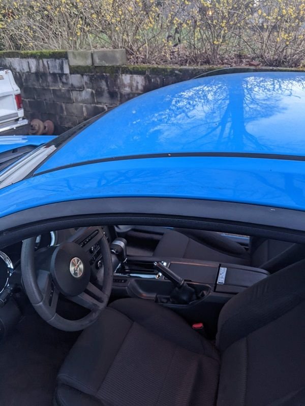

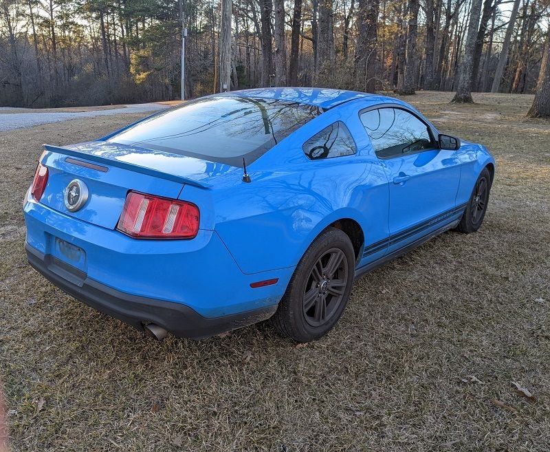

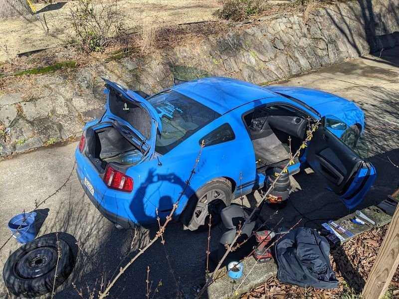

End of January 2021: I presented the following to my daughter for her Project giving us 12 months to get it ready. 4 to drive and get used to it and 8 for me to completely destroy a perfectly running driving car.

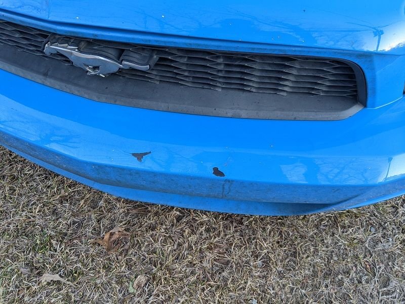

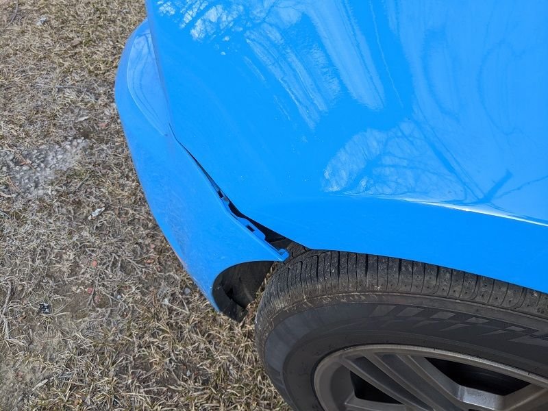

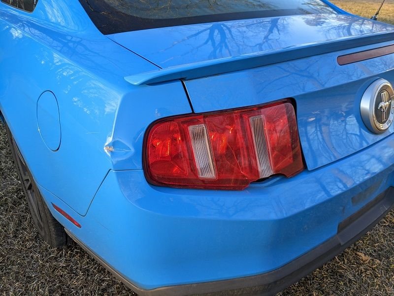

We did nothing to the car during the time it was hidden. This is what she received: Busted taillight (this was expensive) messed up front bumper (front AND rear hits), ripped off Vent shades (was that a thing) dog fur all over the inside and cloth seats that were NASTY. But it it moved under its own power and everything worked. The tires were new (4K miles) and a new EPAS rack.
Also pictured is the AJE K-member I purchased and hid from here before I ever bought the car
Dog hair was everywhere
Smashed tailight and rear fender
Broken Bumper cover mount
Vent shades, what that a thing on Mustangs

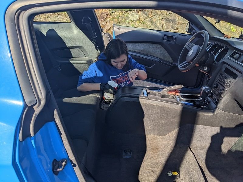

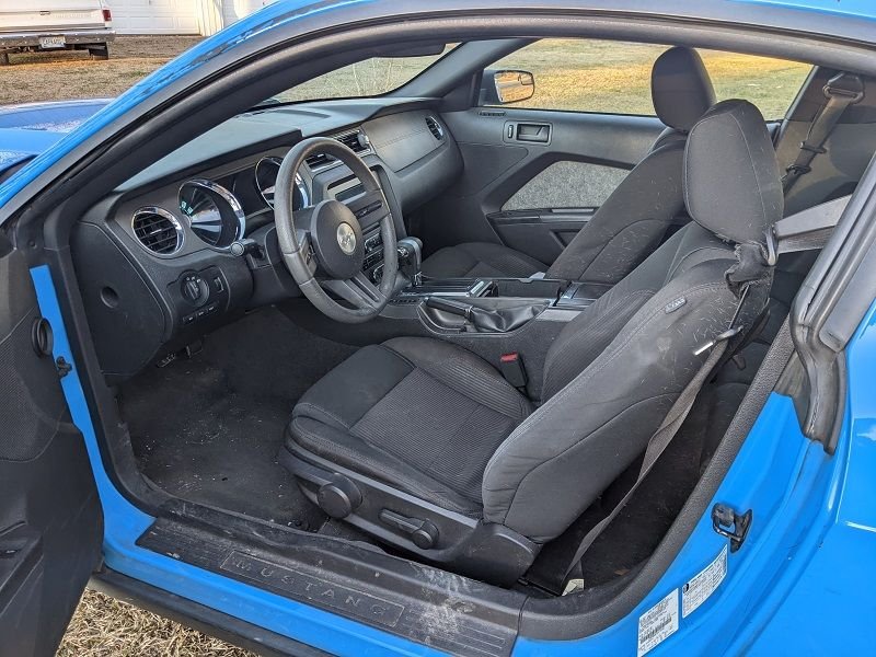

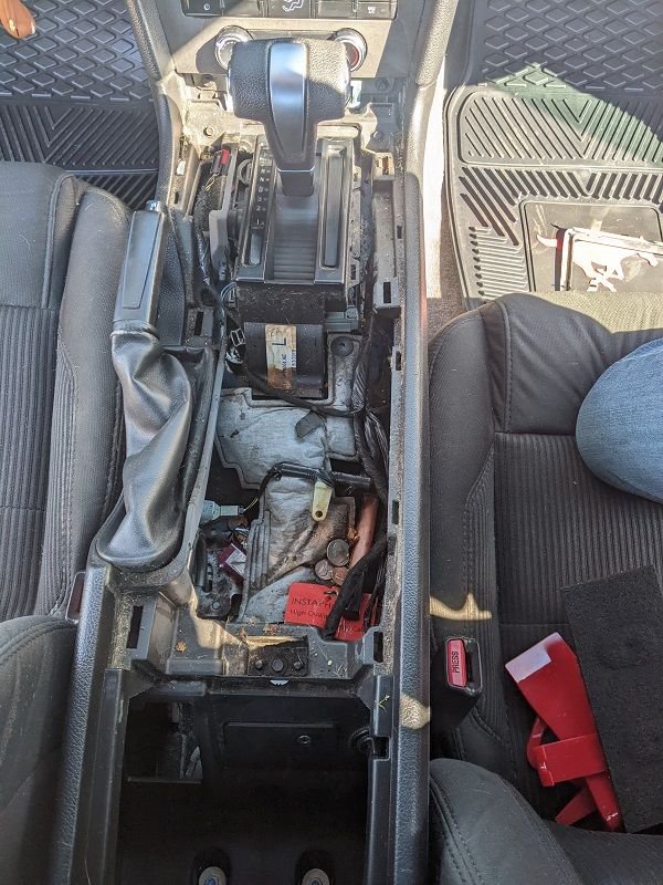

Weekend of Feb 5th 2022: Once home, the first weekend she and I pulled the seats out of the interior and started cleaning out all the junk, dog hair etc. Vacuum, scrub brushes and tooth brush cleaning ensued.
The car had 253K miles on it. I actually found track slips in it from where the original owner raced it.

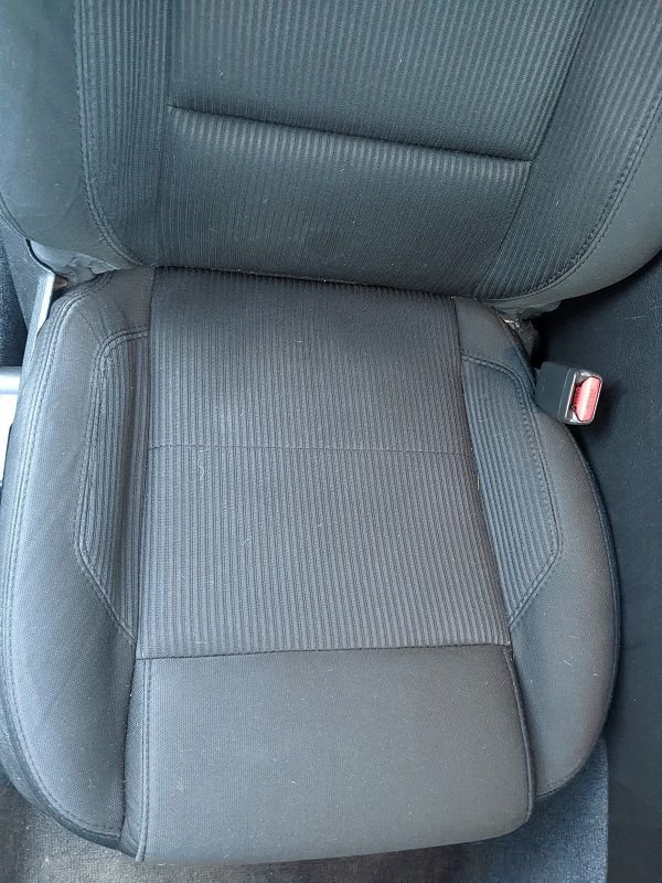

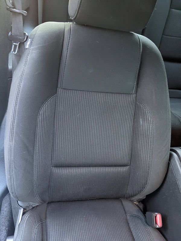

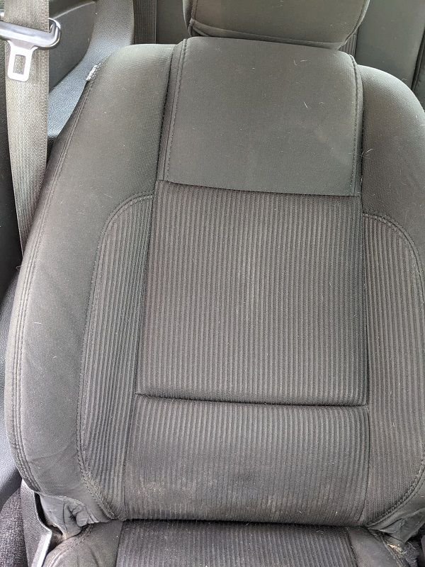

Week of February 13th 2022: we started Round 2 of cleaning on the cloth seats. It was disgusting. I am actually looking for leather or faux leather seats for it.
Steam Cleaner, Scrub brushes, Upholstery Cleaning ensued (best of what we could do with what I had. I went after the left over tape from the Vent shades and got all that junk off also.
You can't tell how much better the seats are, but this is the same front passenger seat and it was a HUGE difference. I put the before and ater of the same seat one after the other. We actually cleaned them a second time after this.
Before cleaning
After cleaning
Before cleaning
After cleaning

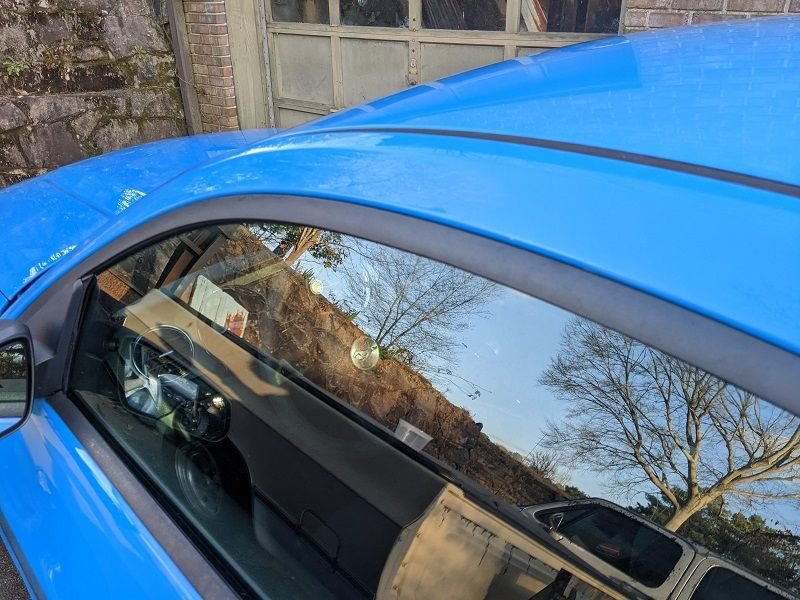

Tackling the vent visor glue.

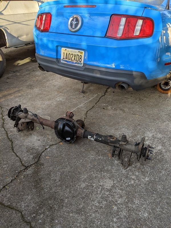

Week of March 2nd 2022: During this time the rear of the car was making some strange noises that sounded like rear axle Roar or a seriously bound caliper. It was weird. I also found a rear passenger taillight at the local Ford Dealership along with an antennae. MAN that taillight list price was HIGH, I was able to get a discount but sheesh. This got installed along with the antennae. I eliminated the caliper/brakes as being the issues but since I knew the car was going to get a V8, it was time to go through the axle and replace everything and put a Ford LSD and new Ford 3.31 gears in. So we took got the car on jackstands to remove the rear axle since the parts were in the next day.

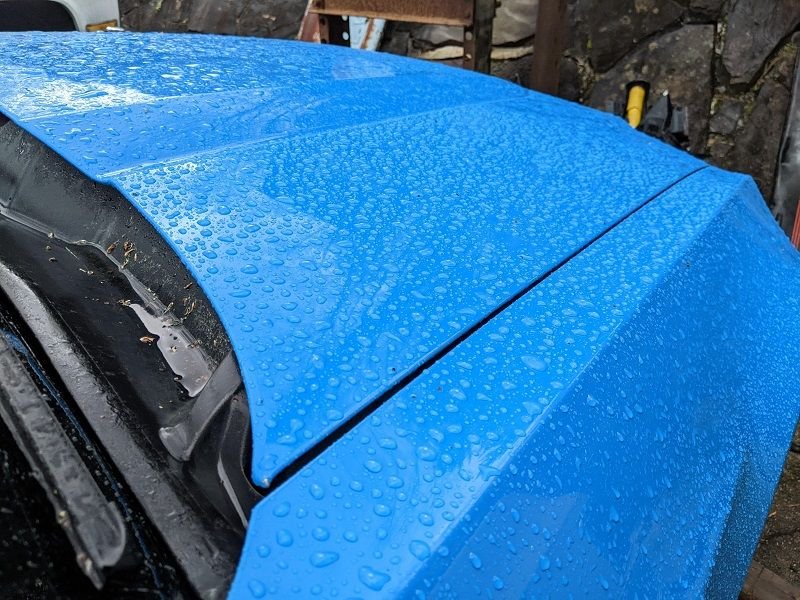

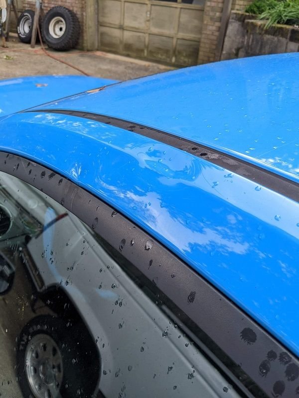

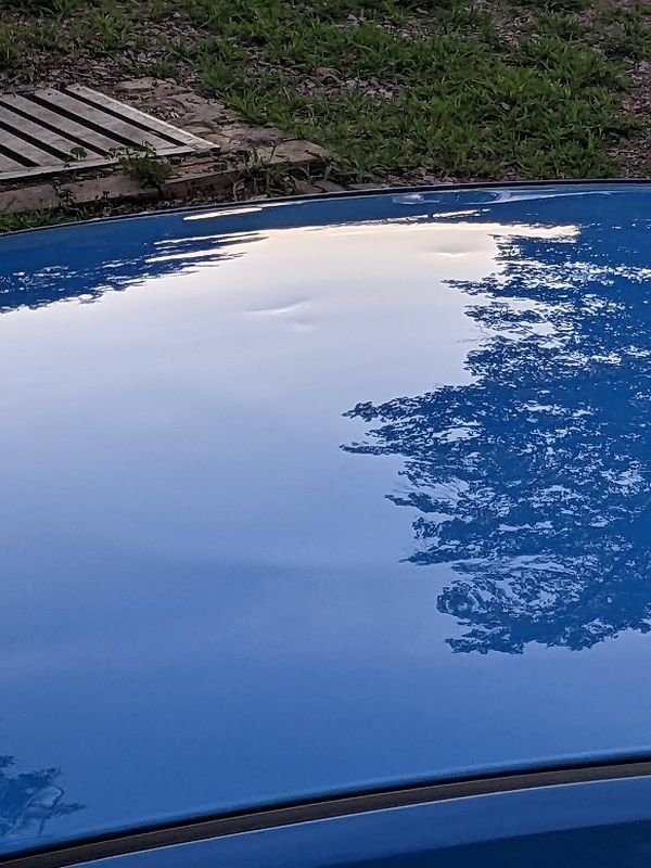

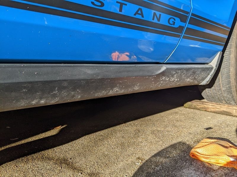

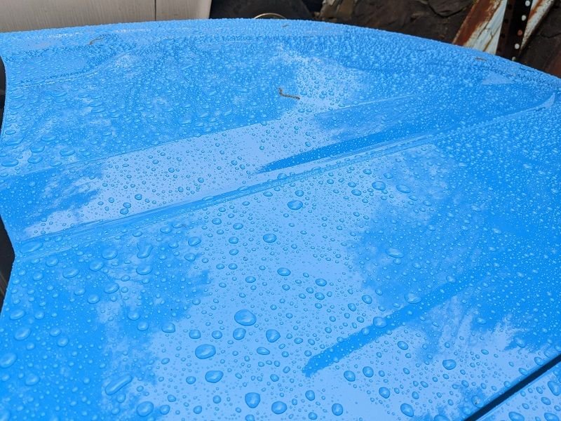

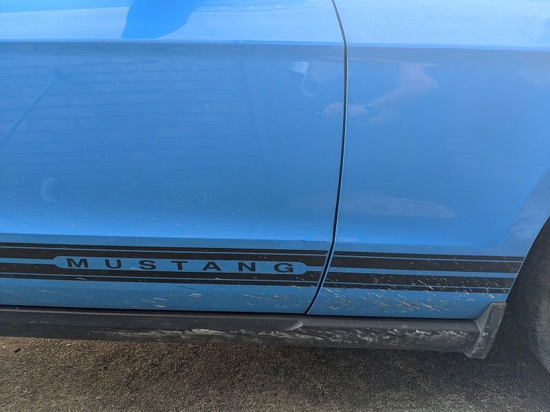

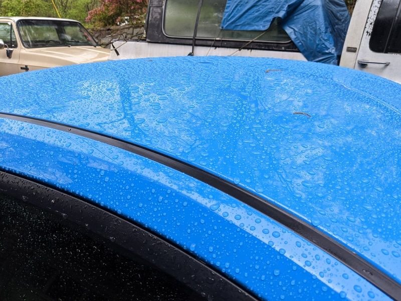

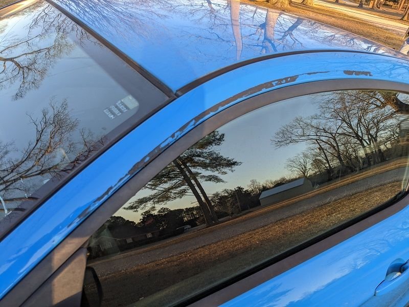

Feb 3rd-6th 2022: Buddy called the next day and told us that he wasn't ready for the axle so we started on working on the paint. When we got the car it appeared to have mud all on one side of the car and it hadn't been washed since we got it. So we spent the day washing the car, twice. Once to get the dirt off and once to clean the car. My daughter actually thought the wheels were darker until we washed the car. You can see the "mud" was apparently paint and it was down the whole passenger side of the car. I also went after the vent shade residue for the final time.

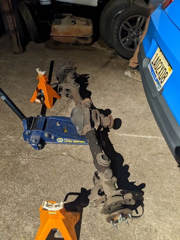

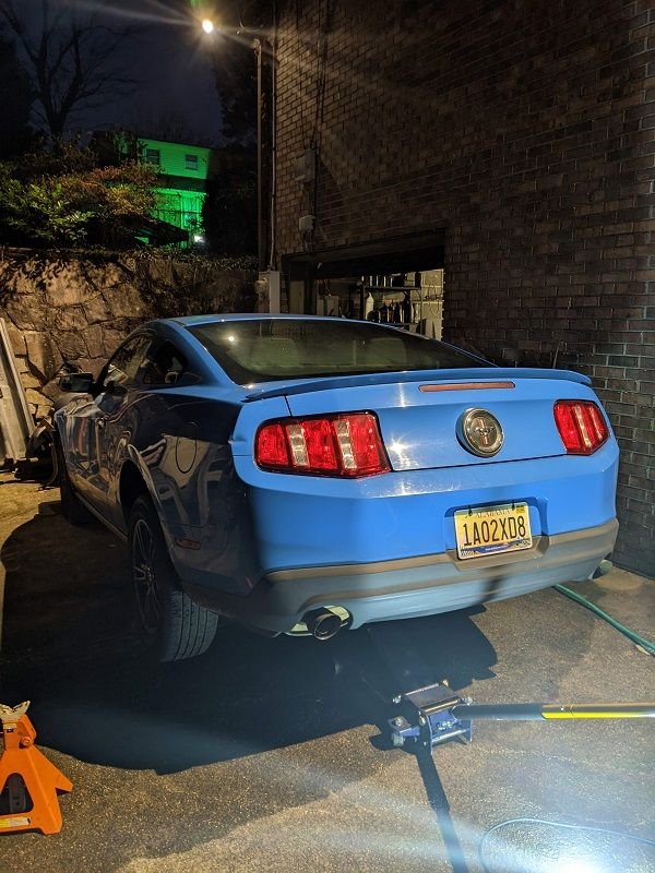

March 14th 2022: The previous weeks she drove the car some (learners permit) to get more used to it but it was finally time to pull the axle for a rebuild. We pulled it out and send it off.

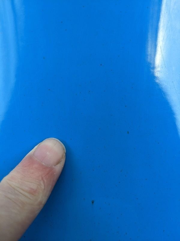

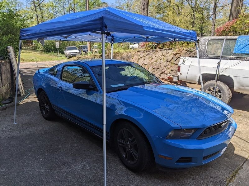

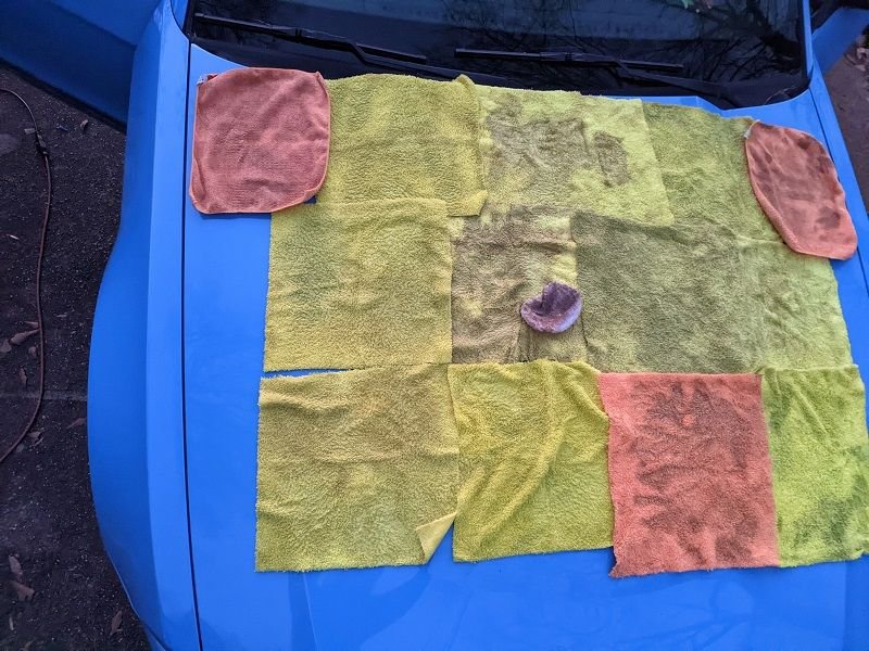

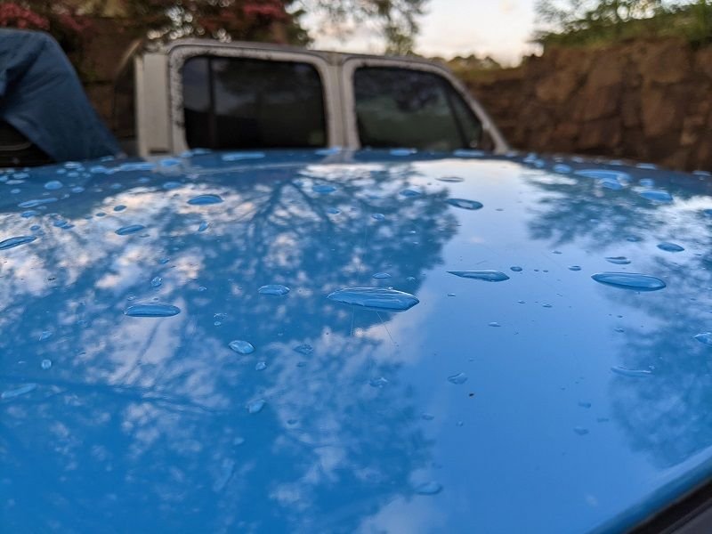

Week of March 19th 2022: During the time the car was stuck we went to town on cleaning up the paint. Mike Phillips my friend from ShowCarGarage is my go to on paint issues and he told me to try Goof Off, WD40, Paint Thinner, Any type of orange citrus solvent, Tar and Sap remover – Stoners. We started with the first and I skipped straight to the paint thinner, and got all the splattered paint off the car. Out on the back was what he described as "Artillery Fungus" that I hit with Goo-Gone and a plastic razor Blade, effectively. Then we put a quick detail wax on the car since I was NOT being nice to the paint

Weekend of March 25th, 2022: After taking longer that what was promised on the rear axle rebuild and it being done by the place that I dropped it off (that I didn't want doing it) NOT by buddy I picked it up and had issues with them providing an invoice for payment. I got the axle back in that Friday night in time for the 4th Saturday Cruise-in sadly my daughter wasn't able to make it but the car did and I parked by my twin brothers Camaro.

Last Wednesday of April 2022: This is where it gets interesting and sadly I don't have pictures, but... I dropped the car off with the new aftermarket suspension bushings along with other components (keeping in mind I have NO clue about a S197 Mustang) I talk to the guy and he see what I have and says no problem. I leave the car with him. The following week 10 days later the call and say it is ready but I didn't think I could make it there in time so I have a friend pick it up who knows the owner. I go to his house ask if it drove ok and if there were any noise and he says I don't know the owner just dropped it off here. I open the truck and every bushing is still in the trunk! I look at the reciept and I have just bought replacement LCA's front and rear, rear UCA and have a Large bill.. I drive the car and it is still making the same clunking noises in the rear but the popping noise from the front is gone. I drive to the shop right before they close (yea I was that guy) and talk to the manager (owner left for the day) and the get the tech and I ask what was going on why wasnt I called? I got all my used parts and the manager told me to come back Monday.
Monday I come back talk to the owner and he said the factory ball joints were shot and it was going to be way cheaper to replace the whole thing than for him to charge labor to remove all the bushings and put them back in. I told him that I could get BMR Control arms with bushings that are much simpler to replace for less. Luckily for me he was a car guy too and he told me you order them and I will install them and return what you have.. So I ordered from BMR and he lined it up and now all the noise was gone.
EXCEPT now I am right under 400 miles on the new axle rebuild and on the way home the suspension is WAY better but now the rear end it whining on accel and decel..
I take the car back to them (they asked me to remove it and bring it back) and told them they need to ride in it. He does with me and he notices within 1/2 mile it is making noise on accel/decel... BAD. I told him it was due to him setting it up and he needs to fix it. We have a gentlemanly disagreement since he thinks he did my buddy a favor and it is by buddies issue. Of which I show him the reciept of where he did the work for me... I tell him I am going to call my buddy and he said he was also. As for him to fix it I would have to remove it from the car again, of which I told him he could redo all of it in the car and he disagreed.
Many phone calls and weekend later apparently said shop owner tells my buddy that he thought it was an IRS axle which is why he wanted me to pull it, of which I told owner I pulled it to save me money, and that savings is gone. He told me to give him 2 weeks tops to get a rack free and he would call me to bring the car. 2 weeks go by and no call, from him. I call my "go to" guy for axle work, he orders the parts (thanks pandemic) 2 weeks later it comes in and I drop the car off and he fixes it. He then tells me whomever build this put ZERO backlash on it and he suggest whomever it was to never let them touch another axle or learn on someone else stuff. I leave his shop and it is quiet as a mouse. Sadly I had to get new bearings and new gears as these were chewed up. The next Monday my buddy calls to say the shop that screwed it up has time to fix it now. I told him I'll pass...

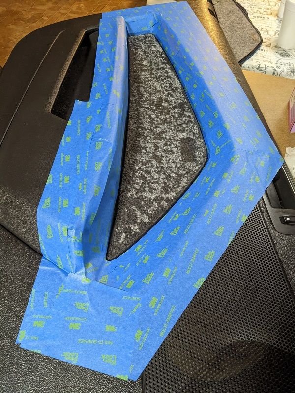

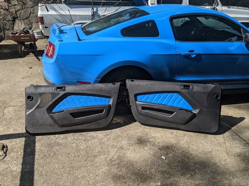

First weekend of June 2022:. The whole time we owned the car the door inserts were BAD. My daughter wanted blue to match so we ordered some and attempted to install them. They look ok in the pictures and 10 feet away but being OCD and a perfectionist they look like crap, but they do look better than before.

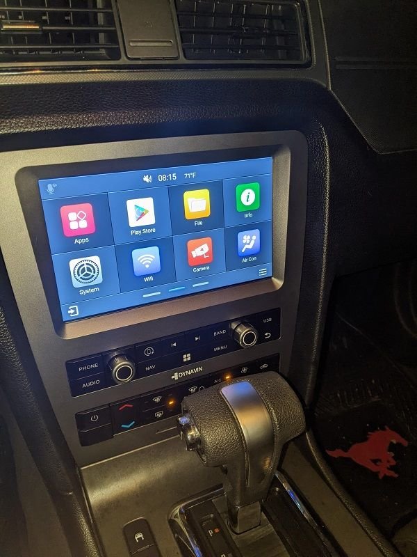

July 21st, 2022: I had planned on running the factory GM PCM at one time so I ordered an Android based Stereo Unti from Dynavin. I wanted to get it in the car and my daughter and I be able drive it for a while to test it out before we pulled it all apart. We got it installed and setup with no issues so now it has a much updated interior for a Teen that has no clue what music media is since everything comes from her phone. This was the last picture I took right before it got in the garage to be pulled apart.

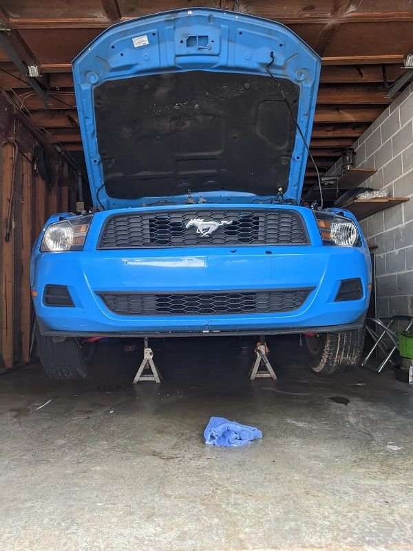

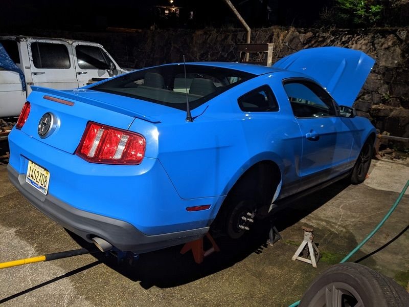

Weekend of July 22nd, 2022: The 2 car garage was cleaned out, my 1989 Blazer K5 that is was converted to 2WD was sent to Streeet Rod Garage to have a new chassis built so now it the time for tear down. I started unhooking the wiring from the 3.7 and transmission. I obtained a LS6 intake, BTR Truck Norris cam. The 5.3L got new springs installed and the front of the engine was pulled down.
Old Jan 25, 2023 | 12:04 AM
Captkaos's Avatar
Joined: Mar 2006
Posts: 133
Likes: 11
From: Alabama

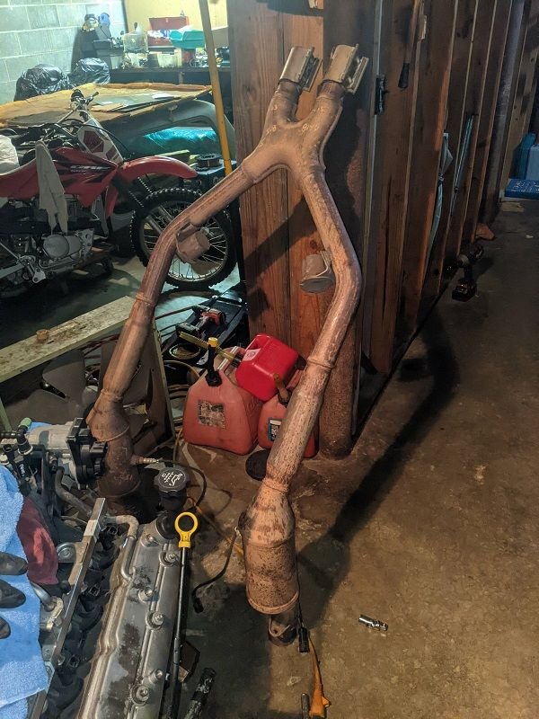

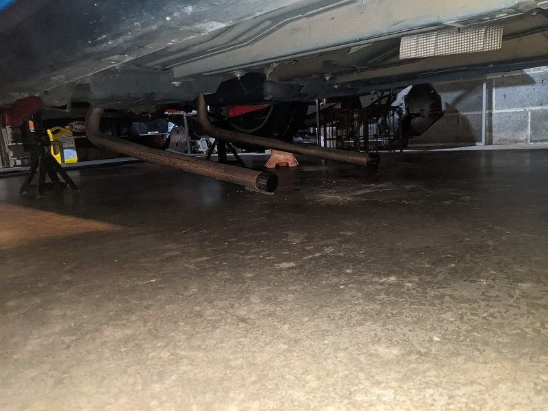

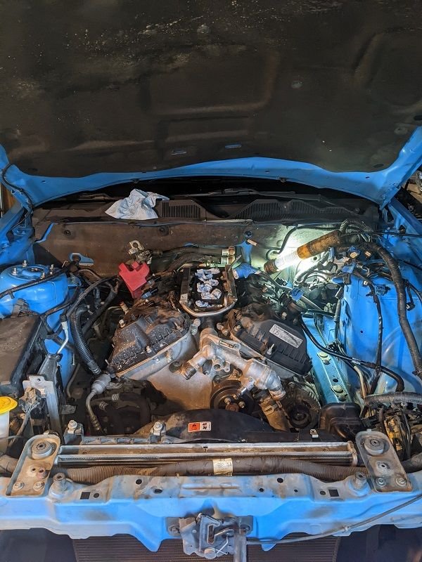

Week of the July 24th, 2022: More wiring was removed along with the Exhaust system starter, trans lines, shifter, anything that would potentially be connected to the engine.

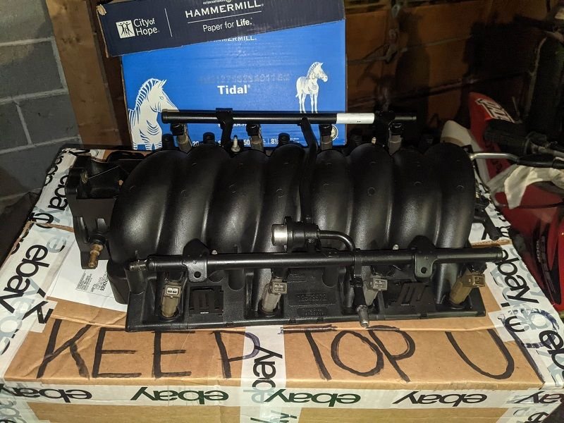

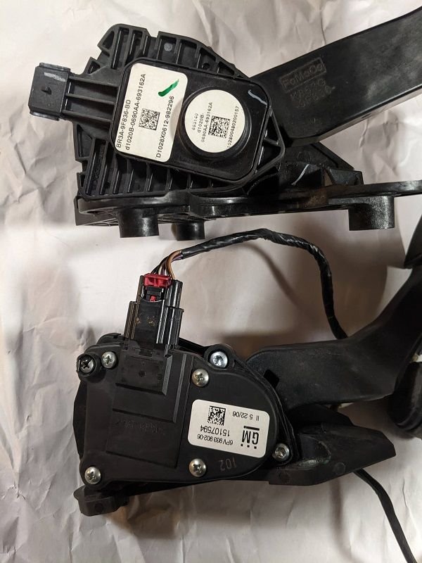

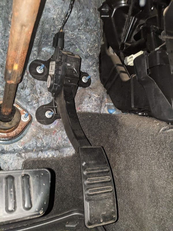

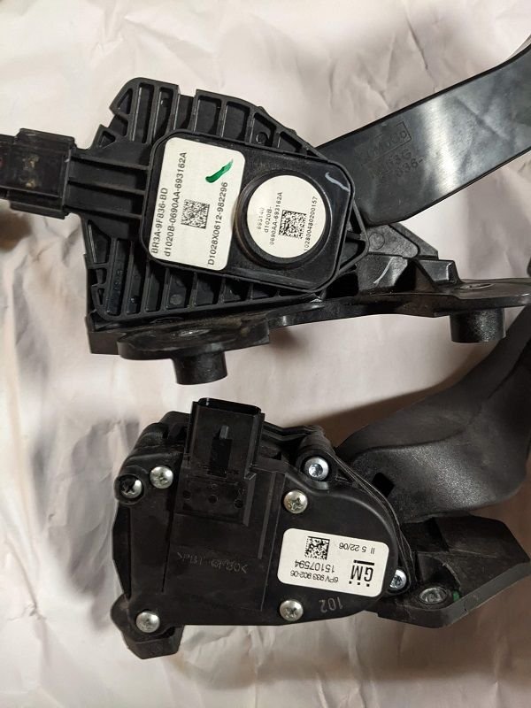

The last weekend of July/first of August we take a beach trip before school starts. When we returned I had been done some research on the DBW for the Ford pedal, GM pedal and the GM Throttle body. I found that the 2000-2006 truck pedal shares the same plug as the 2011 Mustang. Since I am going to be running a Holley Terminator and had not yet gotten the DBW harness I called Holley and asked if it was possible to get the Mustang pedal to operate the GM TB via the Holley. They only "support" the CTSV/Vette pedal so they said no, however Current Performace has a video of their DBW cables operating SEVERAL different pedals and different Throtle bodies with just a relearn. I called them and they had no help. So I am actively looking for a pinout on the 2011 DBW pedal. These appear to be the same form factory and the same plug style.
I went ahead and ordered the 6 pin CTSV/Vette pedal and GM Truck TB wiring along with the early GM 6pin to GM TB truck wiring (which fits the Mustang)
In order below is the Mustang pedal in the car, pics of Mustang pedal top and GM Truck pedal bottom, top has the plug in the GM bottom is the same plug in the Mustang.
