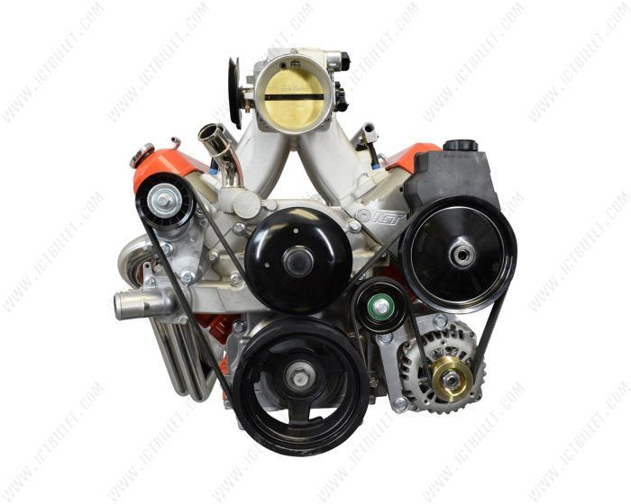

is the issue with the truck accessories forward spacing or height?
if height is the issue, ICT billet makes a great setup for low mount alt + power steering
https://www.ictbillet.com/ls-truck-l...q9-billet.html
truck stuff is the cheapest by far, if you dont mind the forward spacing
