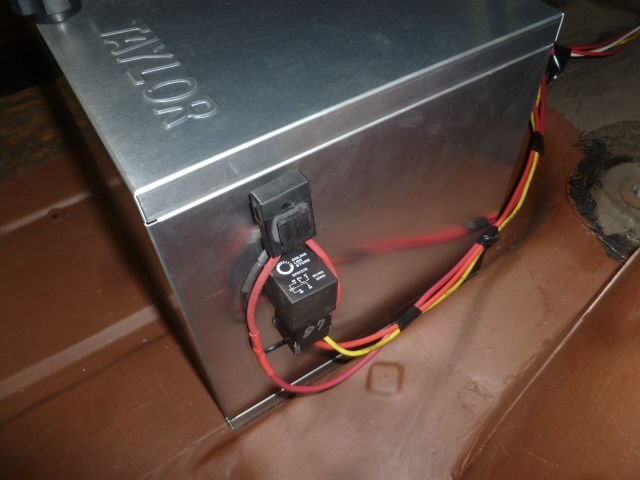

To me, 13.2v seems low. What's the amperage of the alternator? Whats the voltage at the fuel pump when running? Where are you taking fuel pump power from? With a trunk mounted battery, best to take it directly from the battery. I had a low fuel pressure issue until I moved the fuel pump (walbro255) power, relay, and fuse to the trunk. That solved my problem.

my apologies. After a drive I had alot of heat in the fuel pump relay so I wired in a higher amperage relay and seemingly the problem disappeared.
