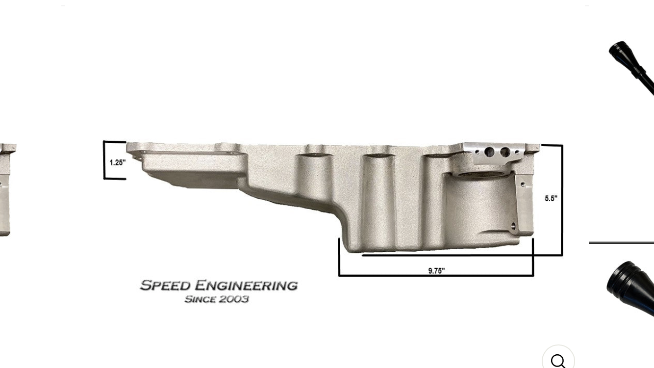

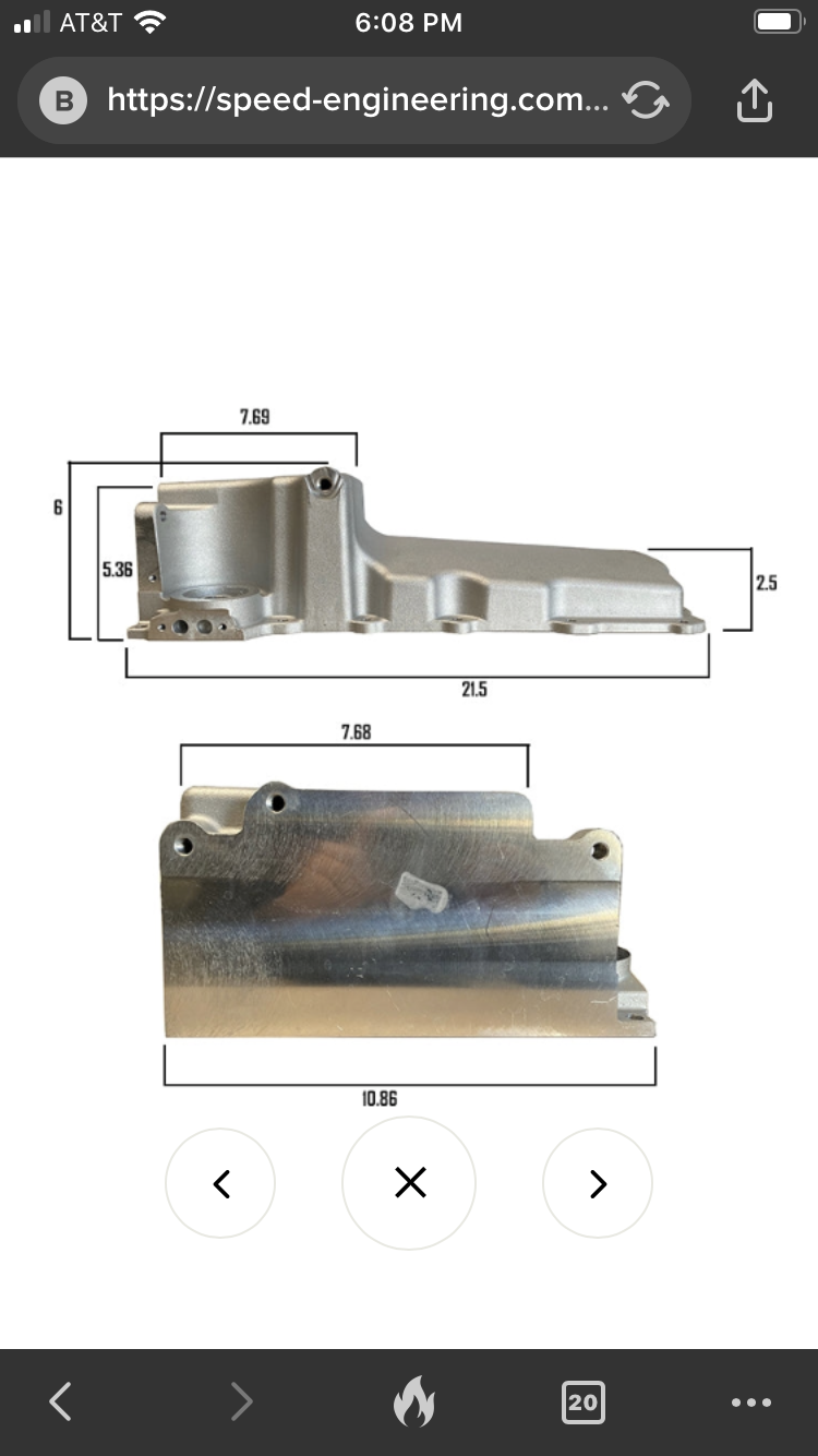

Anyone used Speed Emgineering’s low profile swap oil pan? 76 Camaro subframe (58 Chevy PU), L92/4L80. Other suggestions?

The first one is a knock-off of the holley 302-1. Not a great option for 2nd gens
Second is a repop of 98-02 Fbody LS1. It was the gold standard before the aftermarket caught up. 10 y/a, it was your best bet. Now a days, go with a holley 302-2 or -3 (for turbos) or a similar knock-off
