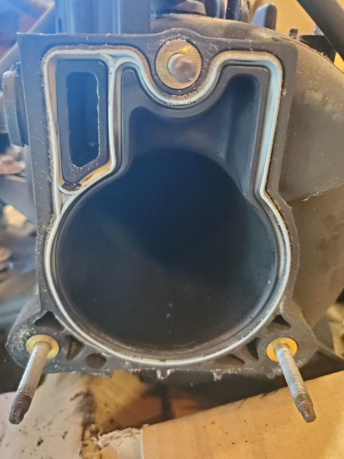

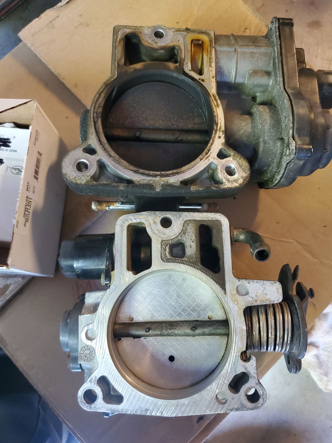

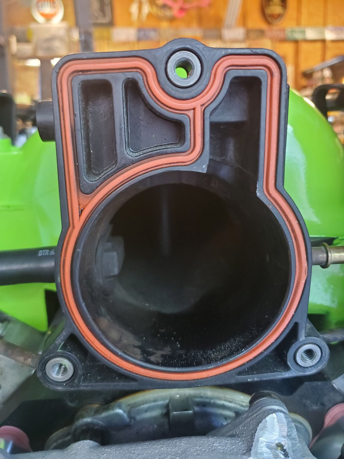

Can I use the 3 bolt DBW throttle body on the DBC intake?
The gaskets are different.
Any issues just bolting it up?
Dbw LQ4 on top, DBC LS1 on bottom
Ls1 intake manifold im running
LQ4 manifold not using

No problem. Use it.

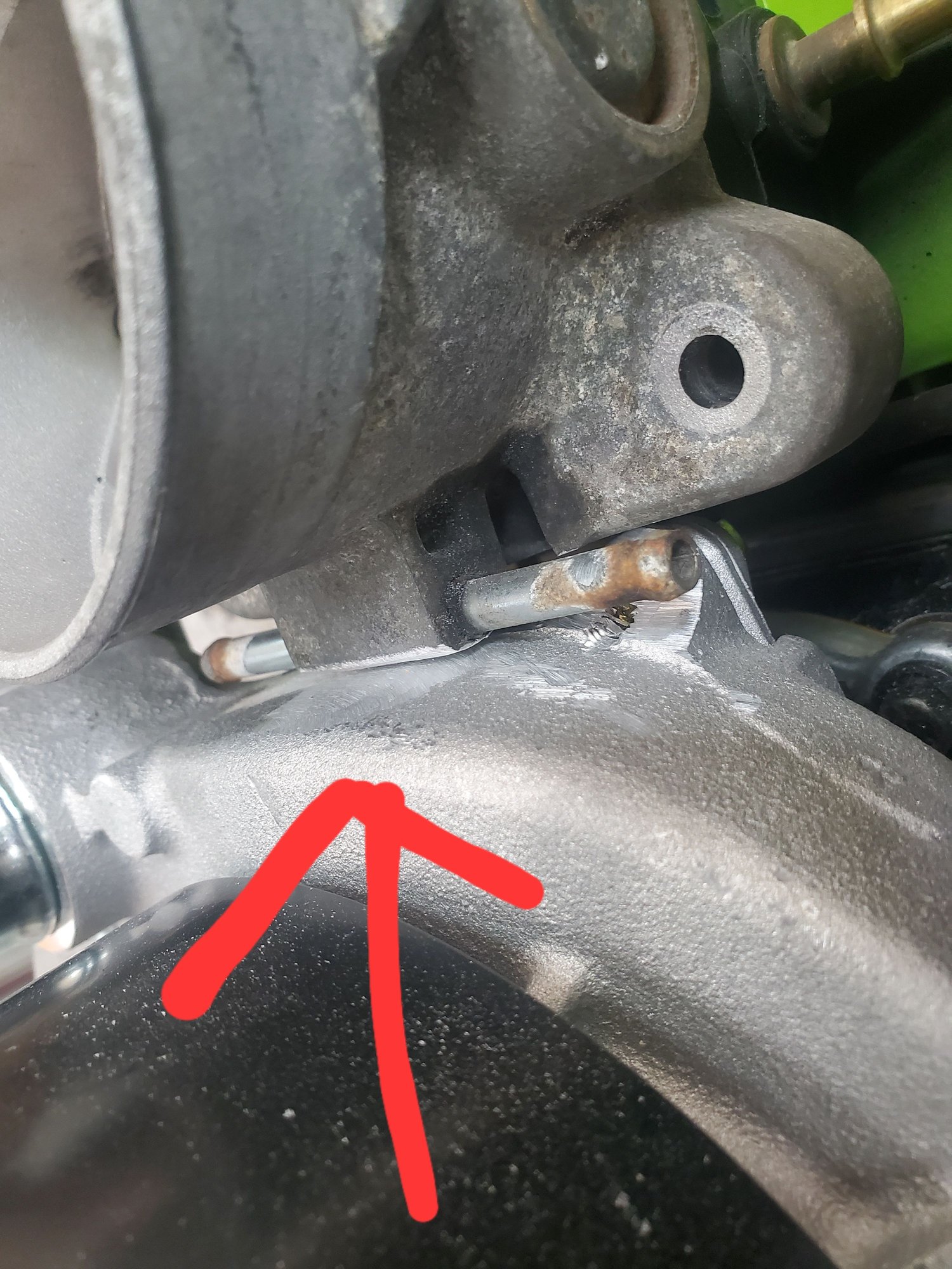

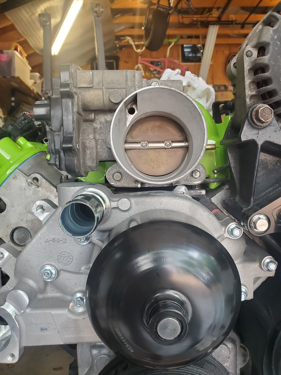

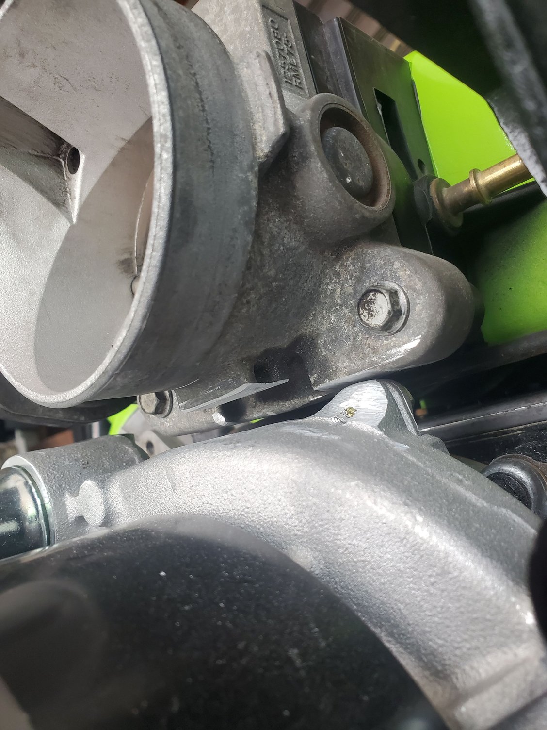

lower double male hose connection on the bottom of the throttle body is hitting my F body WP.
It seems to just be a double male connection with no internal connection to the TB.
Im out of metal to grind off.
Should I just chop it off?

Problem solved😆
Took off the lower hose fitting, and ground the WP tab down a bit.

If those were coolant fittings, you don't need them.
