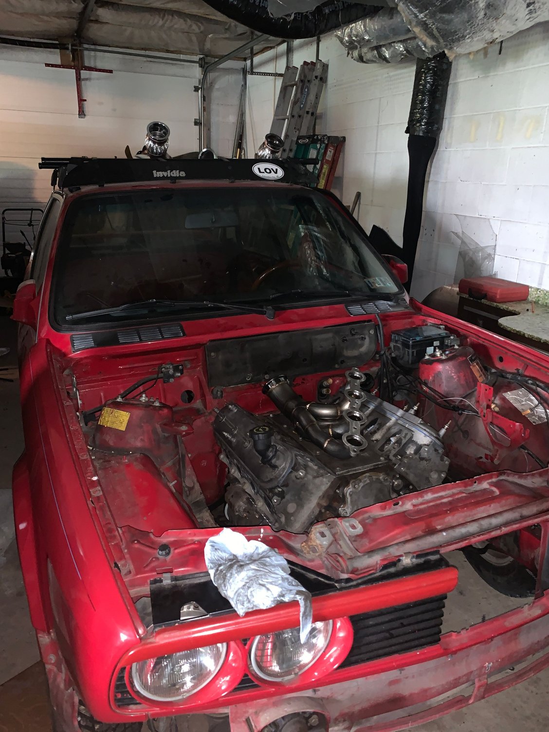

This is my first go around with an engine swap (into my 1987 BMW e30). I have gotten relatively far but need some help as this is some uncharted territory and I don’t necessarily know the landscape all that well.
Thus far I have bolted up the the 5.3 LM7 (with 862 cathedral port heads) and mated it to an AR5 transmission with an adapter plate. I bought a Holley terminator X Maxx and wiring harness that seems pretty plug and play (wiring isn’t my strong suit as I am colorblind lol).
I have read some of the complications with the E30 and am prepared for them (brake booster, radiator, etc.) but where I mainly need help is figuring out what I could bolt up to this engine.
What I am looking for help on precisely is:
- what intake can I run? If I choose a factory intake (as they are cheaper) like one from an LS1/LS3 (with fuel rails, throttle bottle, injectors) will it bolt up to the 862 heads?
- will I need to swap out the front accessories as well? If so, is there a reference anywhere that shows what intakes match up with what accessories?
- this engine has a valley play with what I think are knock sensors on embedded on them - can I remove those and swap to a flat valley plate? Also there is a pipe that runs along top this (I think it may be called a “steam pipe”) should this be swapped out?
- and lastly, since tearing into this engine I have moved around quite a bit and may have lost some bolts to these accessories on the engine itself - is there a resource for getting these if I have lost some?

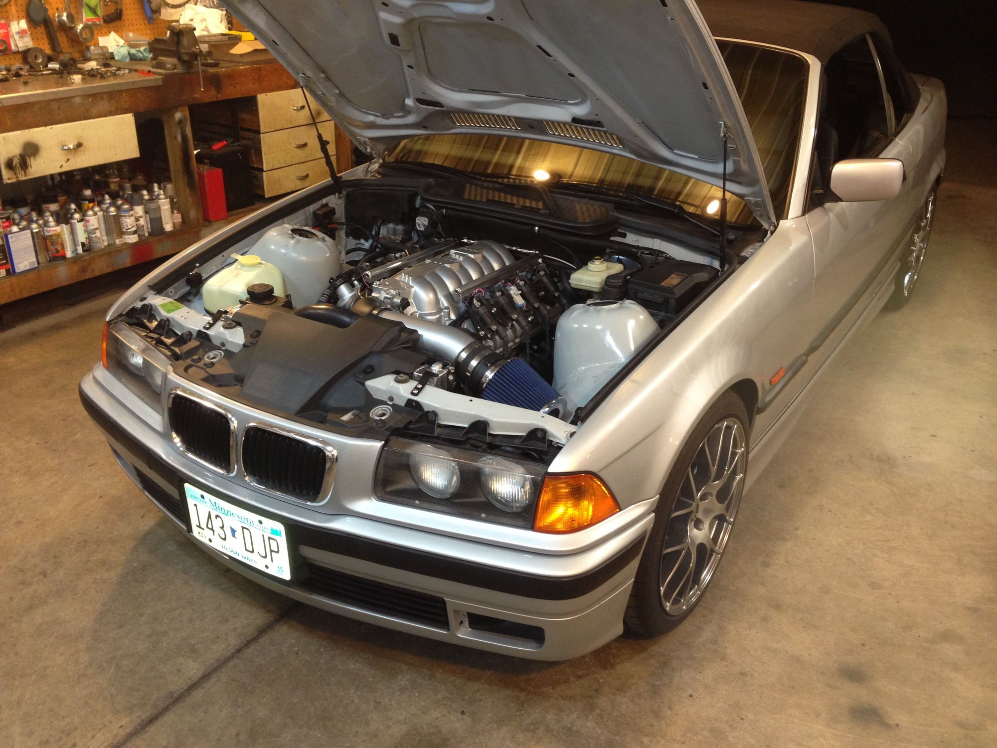

I did a LS6/T56 combo into a 99 E36.
Here's what I did.
1. LS6/LS1 intake, fuel rails, throttle, mass air sensor and injectors. I don't believe the LS3 intake would work due it's rectangular ports.
2.I used 2002 Camaro front accessories. ICT makes some brackets that work well.
3. I built my motor/trans mount.
4. Because I'm cheap I fabbed my headers.
5.. Leave the knock sensors where they are.
6. There has to be a steam line that runs one head to the other and then connects to the radiator.
7. Bolts if want a stock look visit a GM parts place I think you can get still get them.
Pic of my 99.
