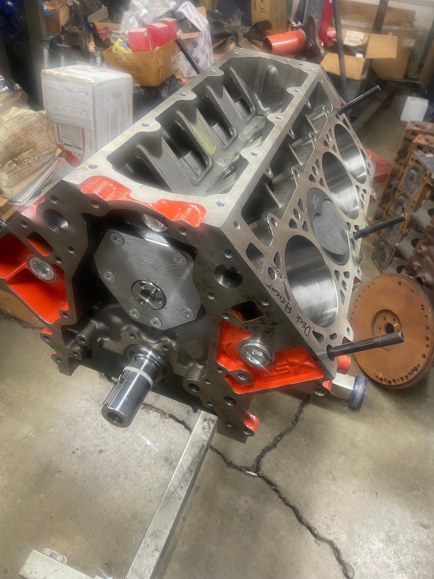

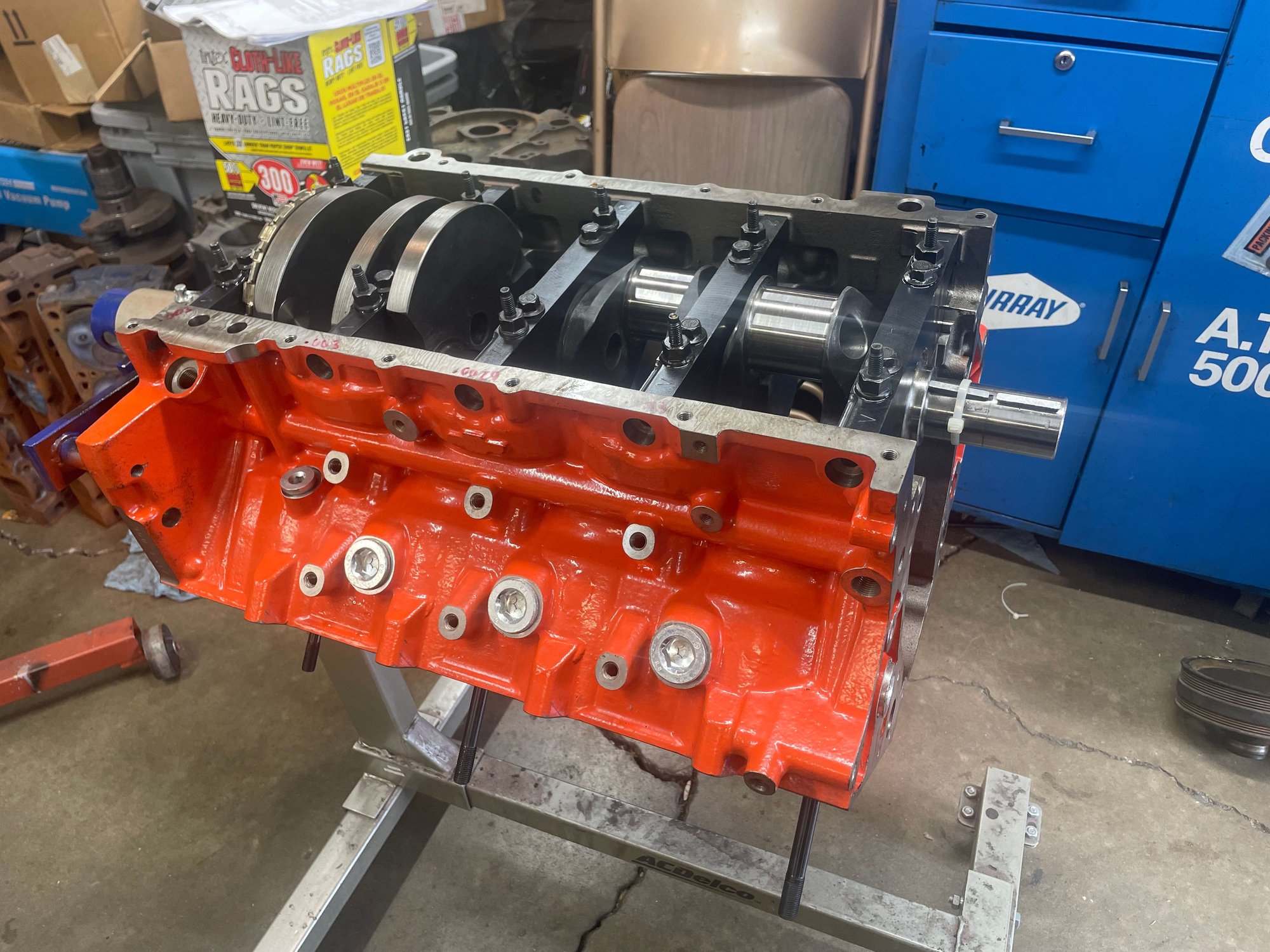

A couple pics of the LSX short block

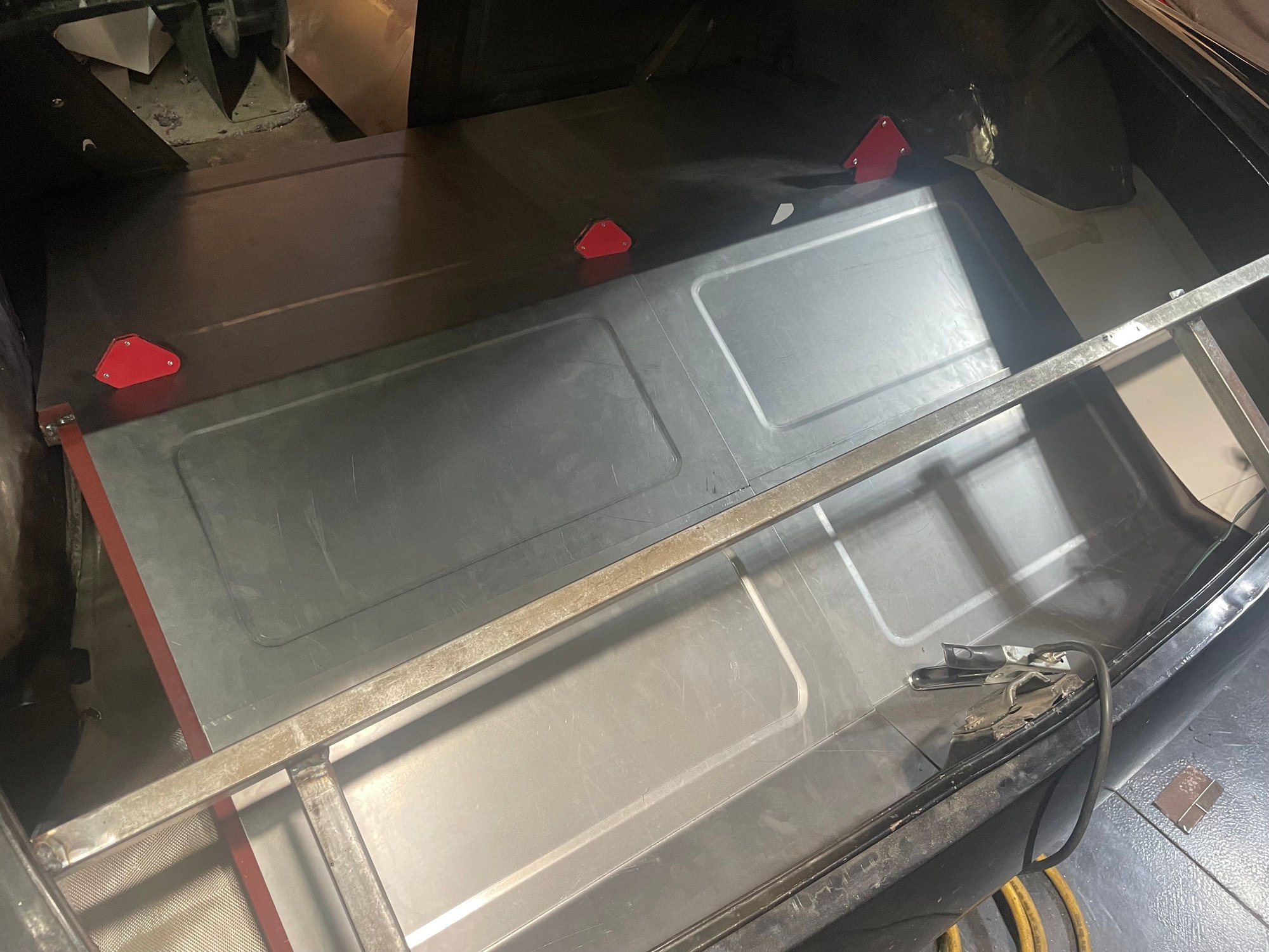

Got started on the front portion of the trunk floor this week just trying to get it all laid out. Haven’t come up with a great plan for the rear section yet as I don’t want to weld to the inside of the quarters or rear panel anywhere as I don’t want to have to mess with paint. Thinking maybe trying to panel bond some flanges to the them that will allow me to attach the floor to them.

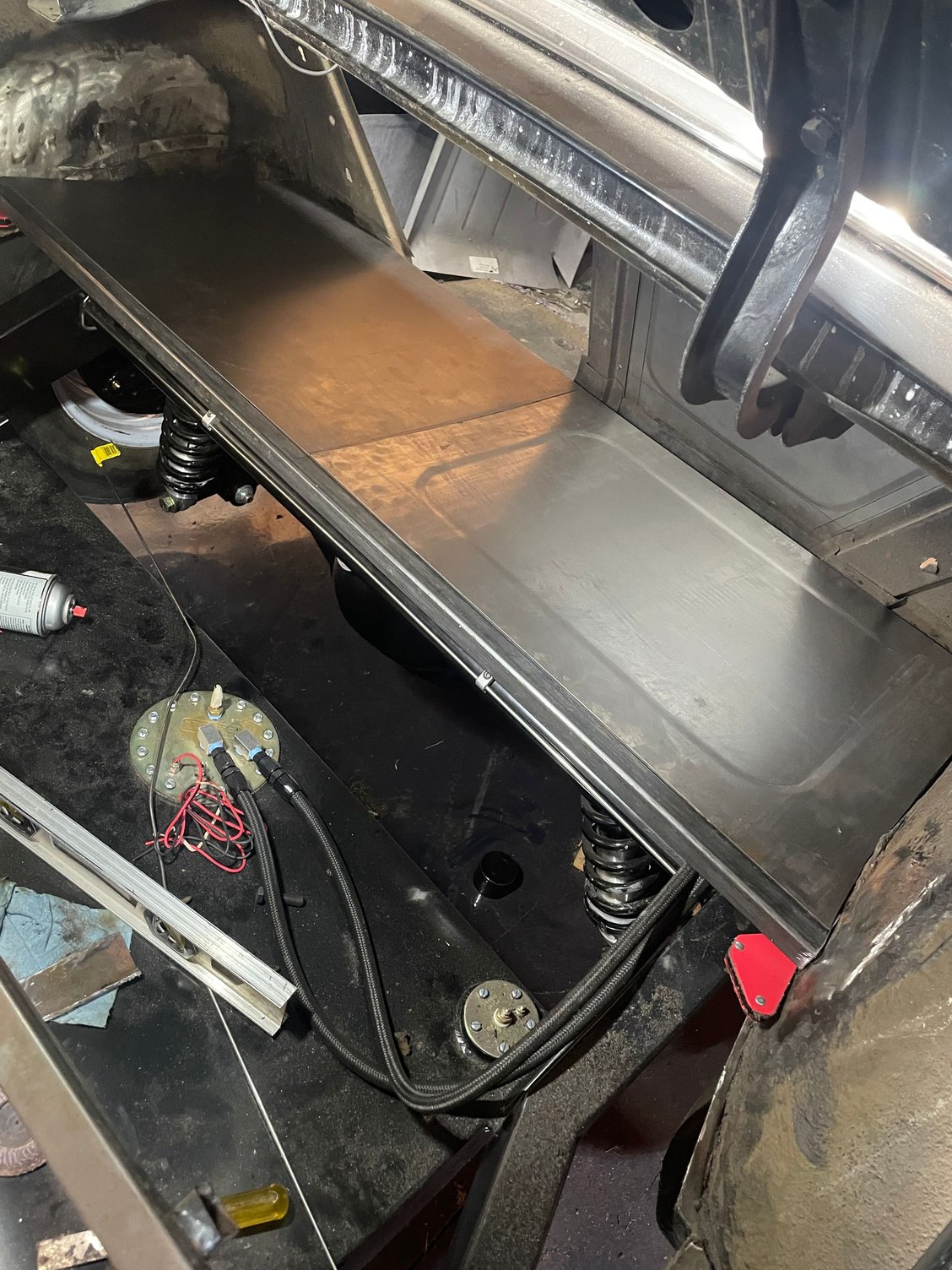

Little bit of progress made on the trunk floor. Got the subframe pretty much all welded together. Just needs to be cleaned up a little and starting to get the panels laid out and made to finish it off. First time trying to fabricate anything this substantial so it’s been a slow process of trial and error.

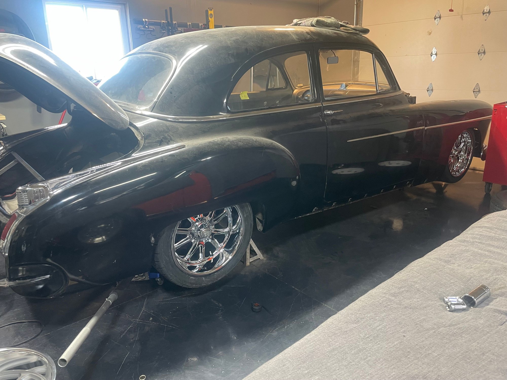

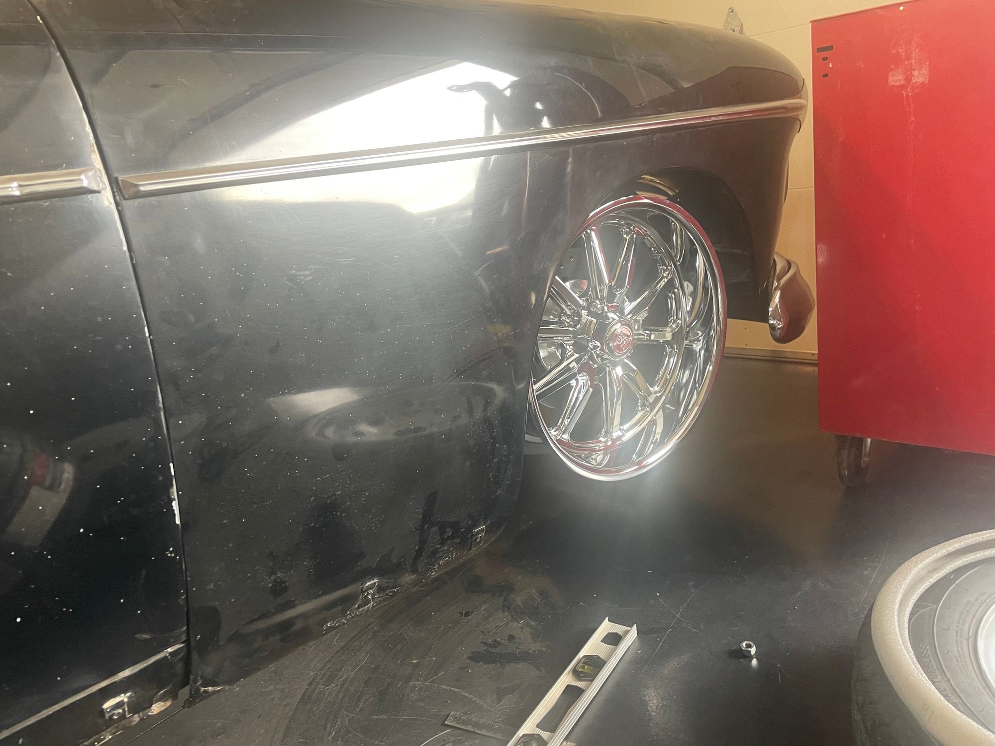

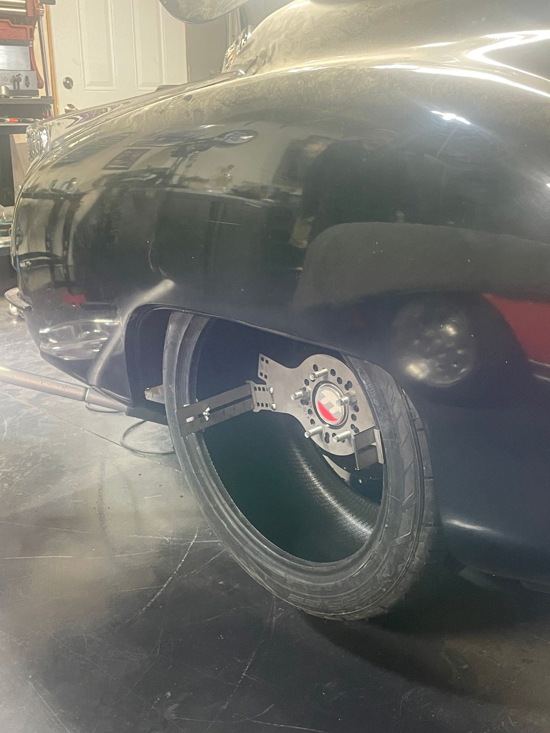

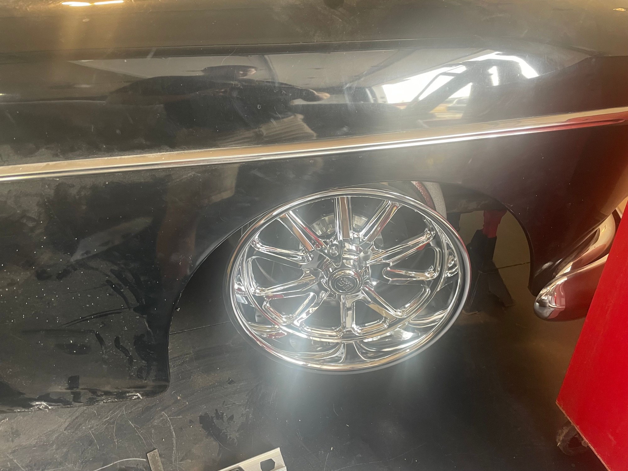

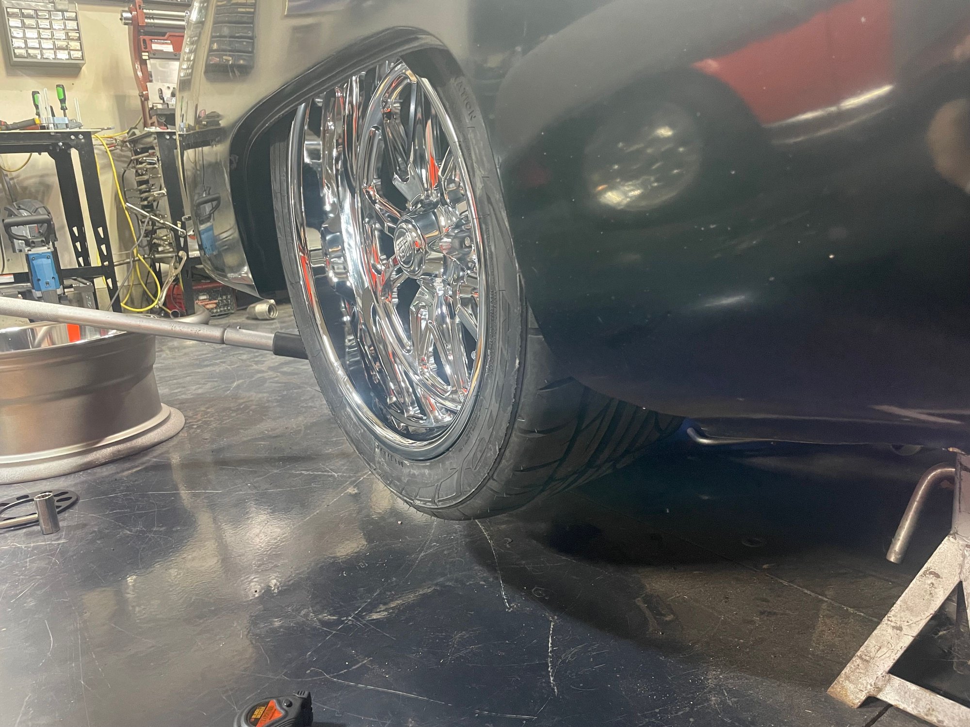

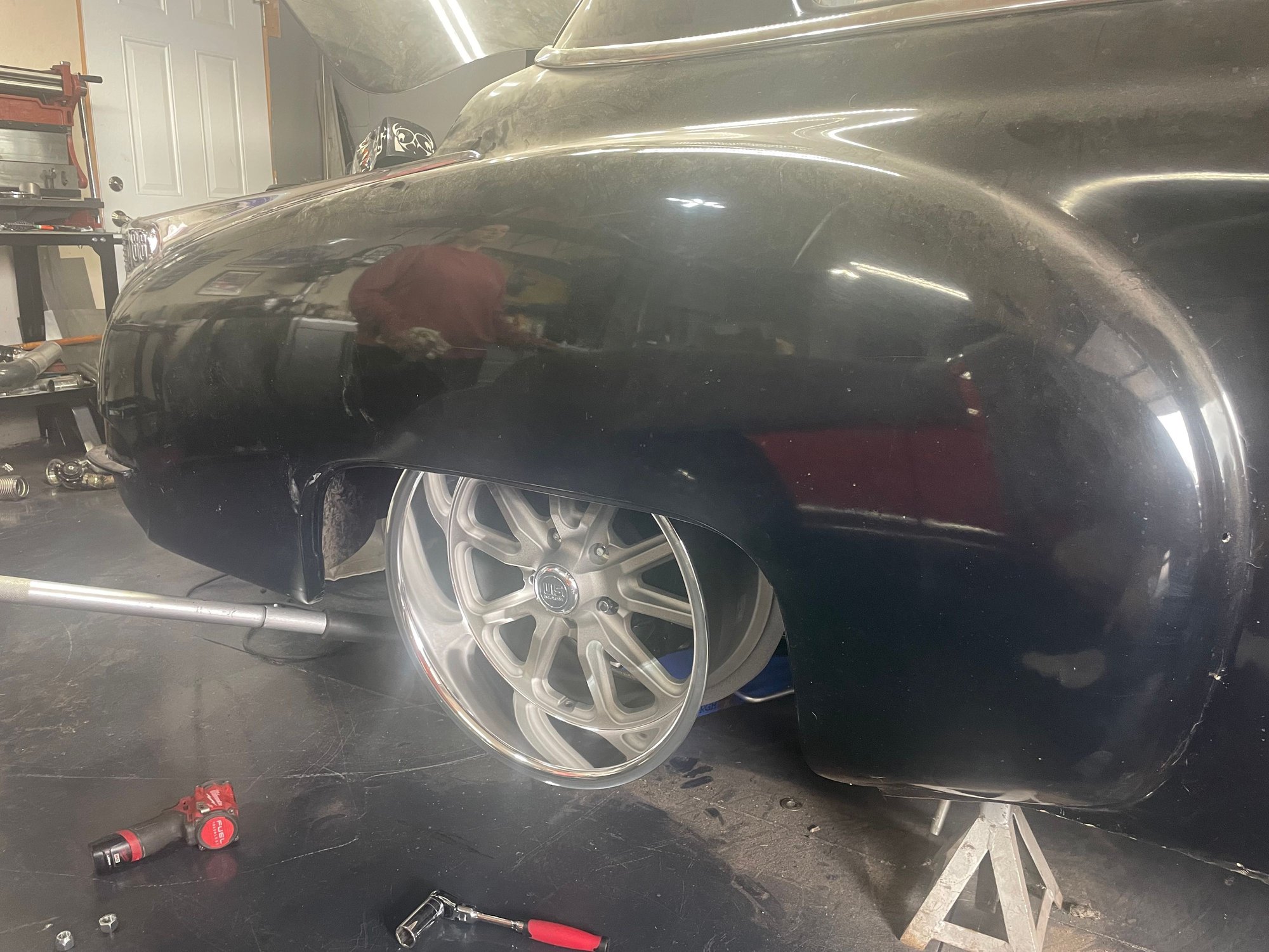

Small update. Haven’t done much on it over the winter but weather is starting to get nicer so getting back out into the garage some. Picked up a couple versions of the wheel I think I’m going to use. They are US Mag Ramblers. Wanted to see what the full polished looked like compared to the textured grey and polished barrel. Also test fitting the rear tire to see what I have to do to make it fit. Think we’ve settled on the full polished wheel. 18x8 front 18x10 rear.

Need to work the inner wheel well a little bit on the front side of the rears to gain some clearance but other then that they look like they will fit.

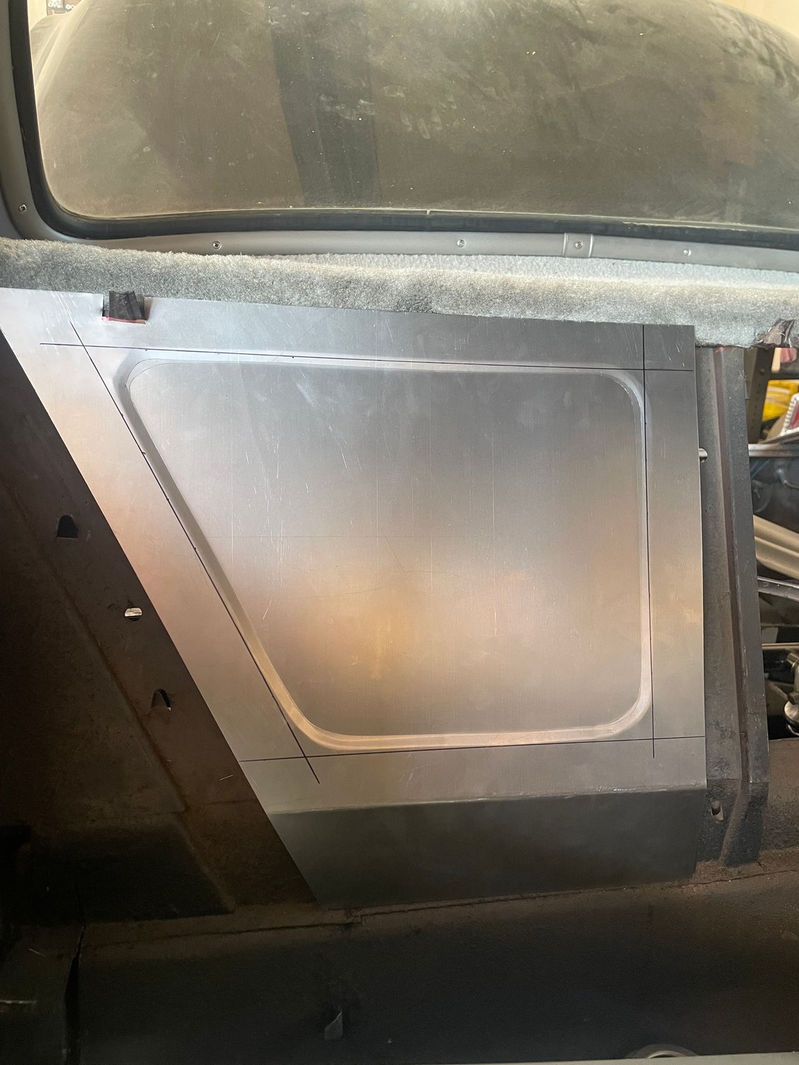

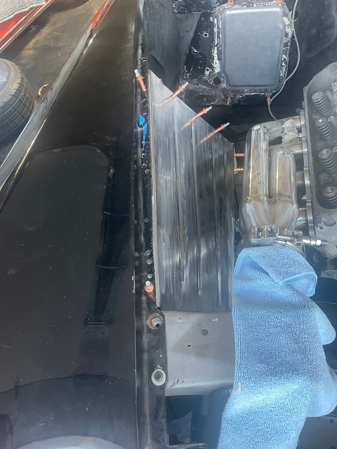

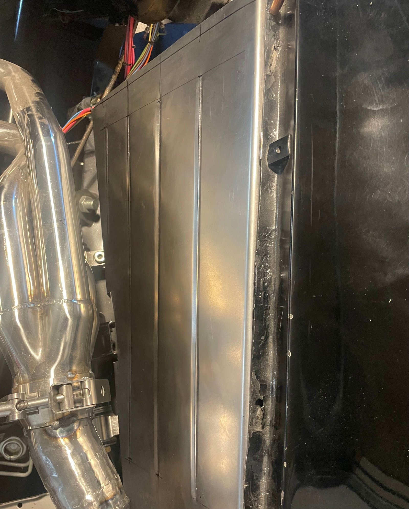

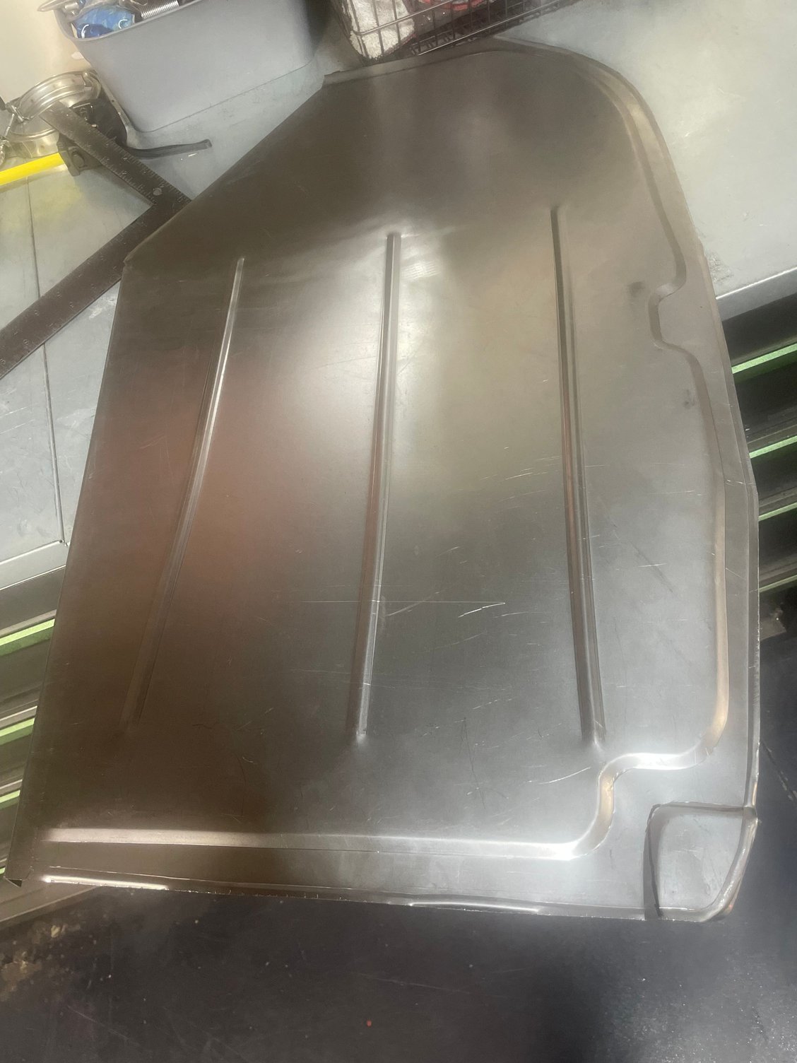

Got the rear half of the inner fenders panels made up this weekend. They didnt turn out too bad

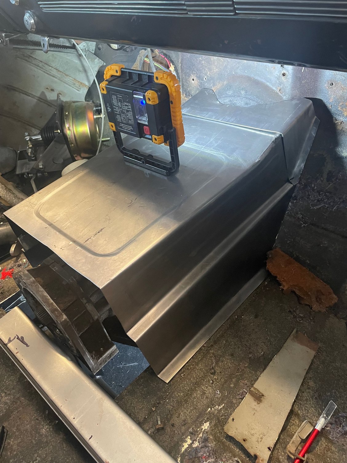

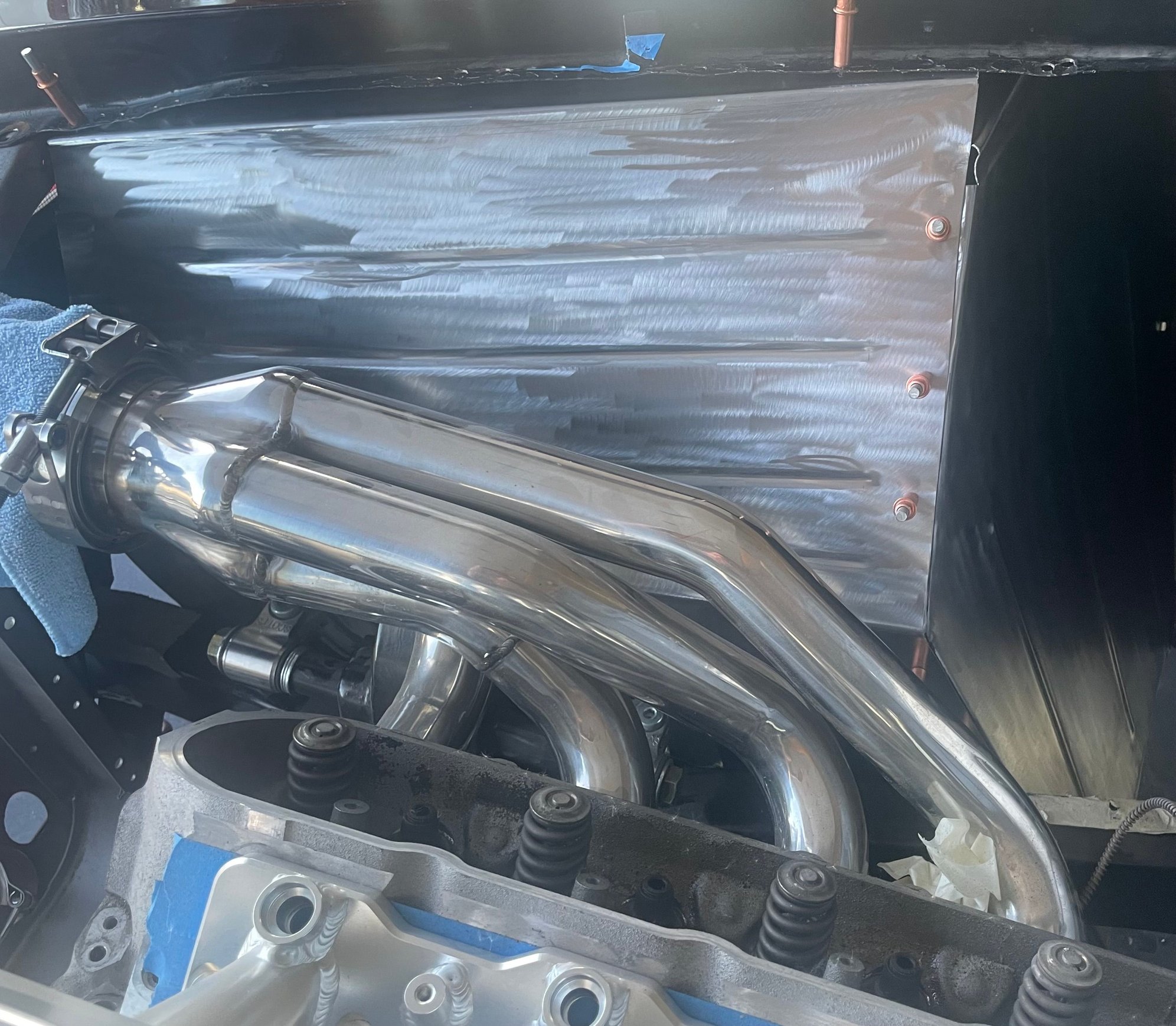

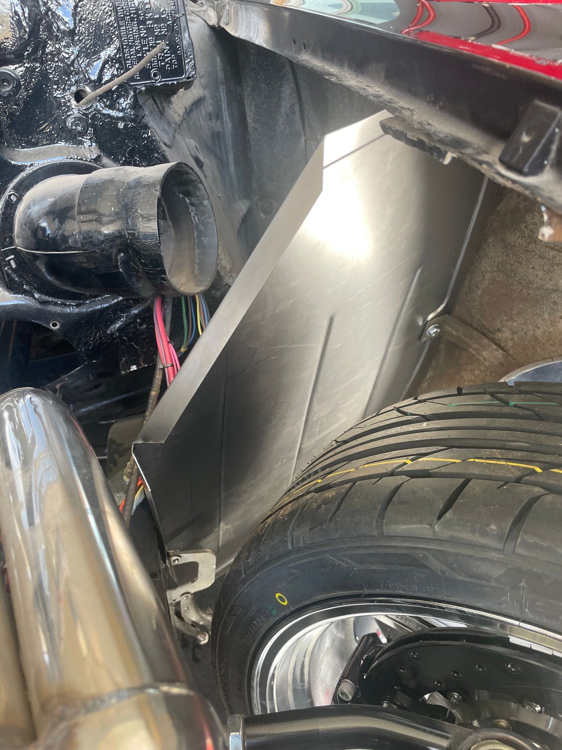

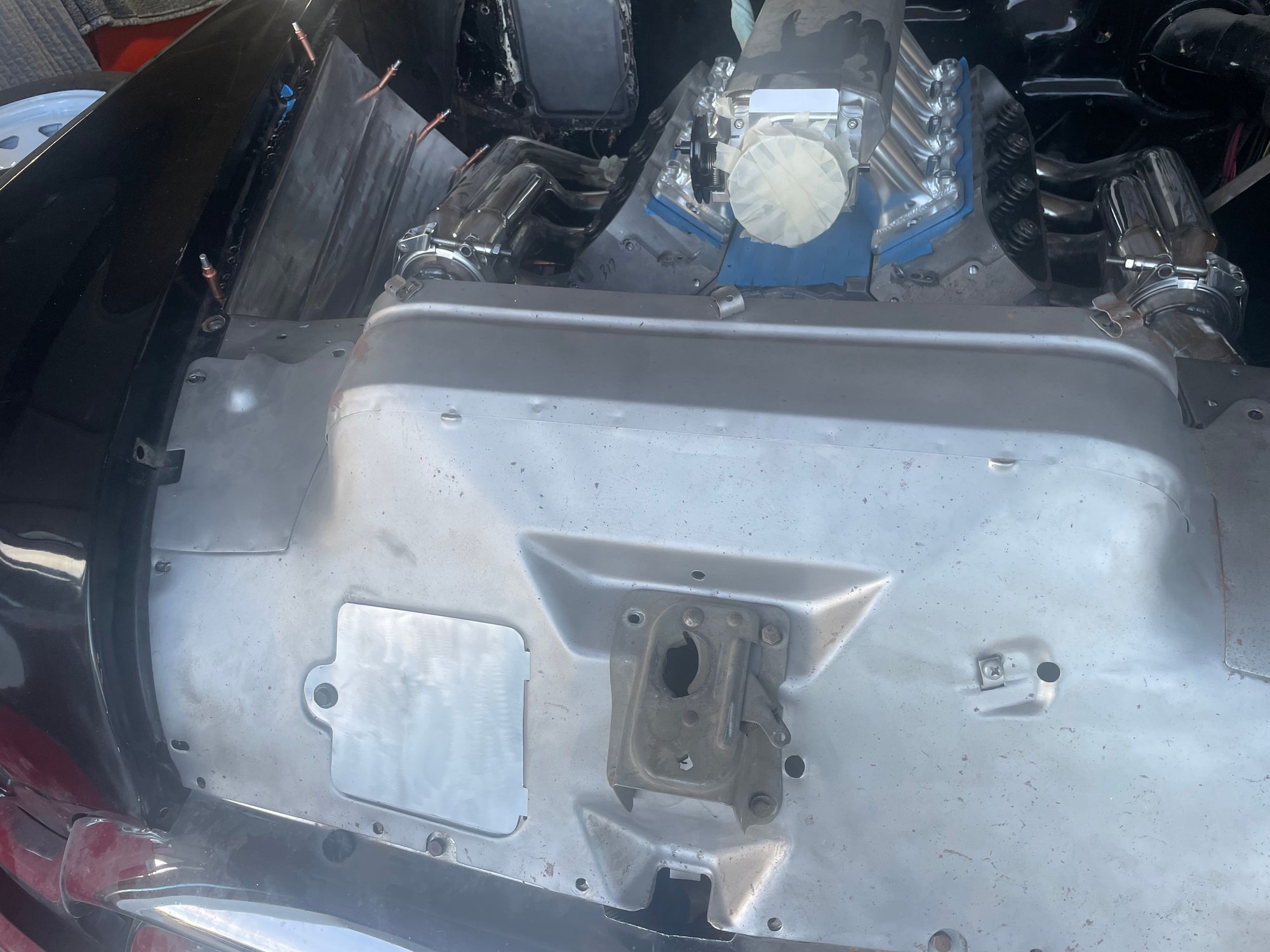

Got the first top over the wheel inner fender panel made. Not extremely happy with how it turned out so by the time it’s all said and done I’ll probably remake another one to get the fitment a little cleaner and get the bead rolls done a little nicer. But it gives the idea of what I’m going for and works for now. Still trying to learn on the metal work as I go.

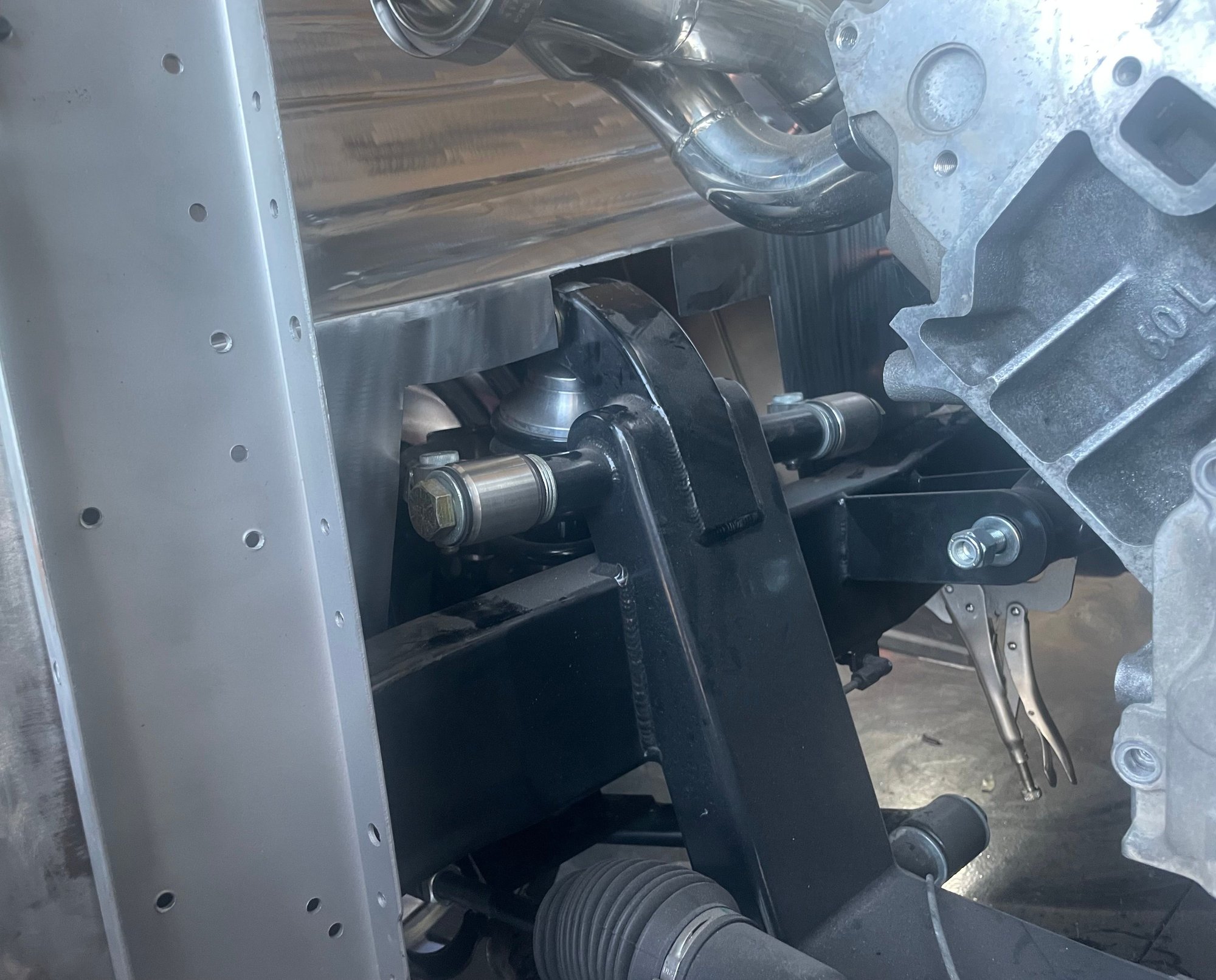

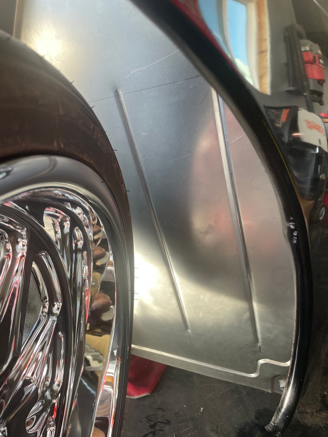

Took the afternoon yesterday and got the driver side one pretty well knocked out.
