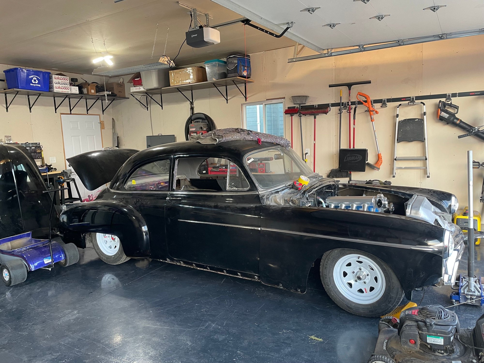

Had access to my friends shop and 2 post for a day this weekend. Didn’t get quite as far as I’d hoped. Lost some time do to the switch failing on the hoist when the body was halfway off and took a couple hours to get it all back together and working. Then ran into some issues with the body fitting. Had to cut off the front cowl mounts and will have to build our own to make them work. the front four link mount is also hitting the floor so need to modify the floor a bit to get it where it’s supposed to be. But it’s sort of on the chassis now enough know where everything needs to be trimmed out. Will definitely need the ride height adjusted a bunch in order to drive it on my local roads but i like the look so far.

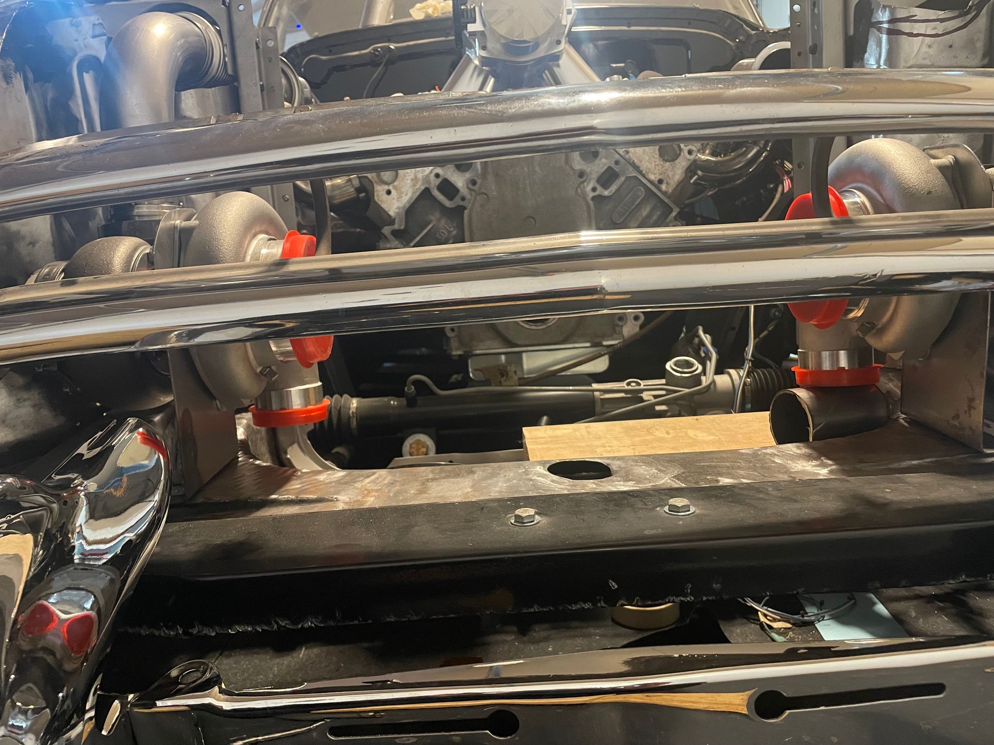

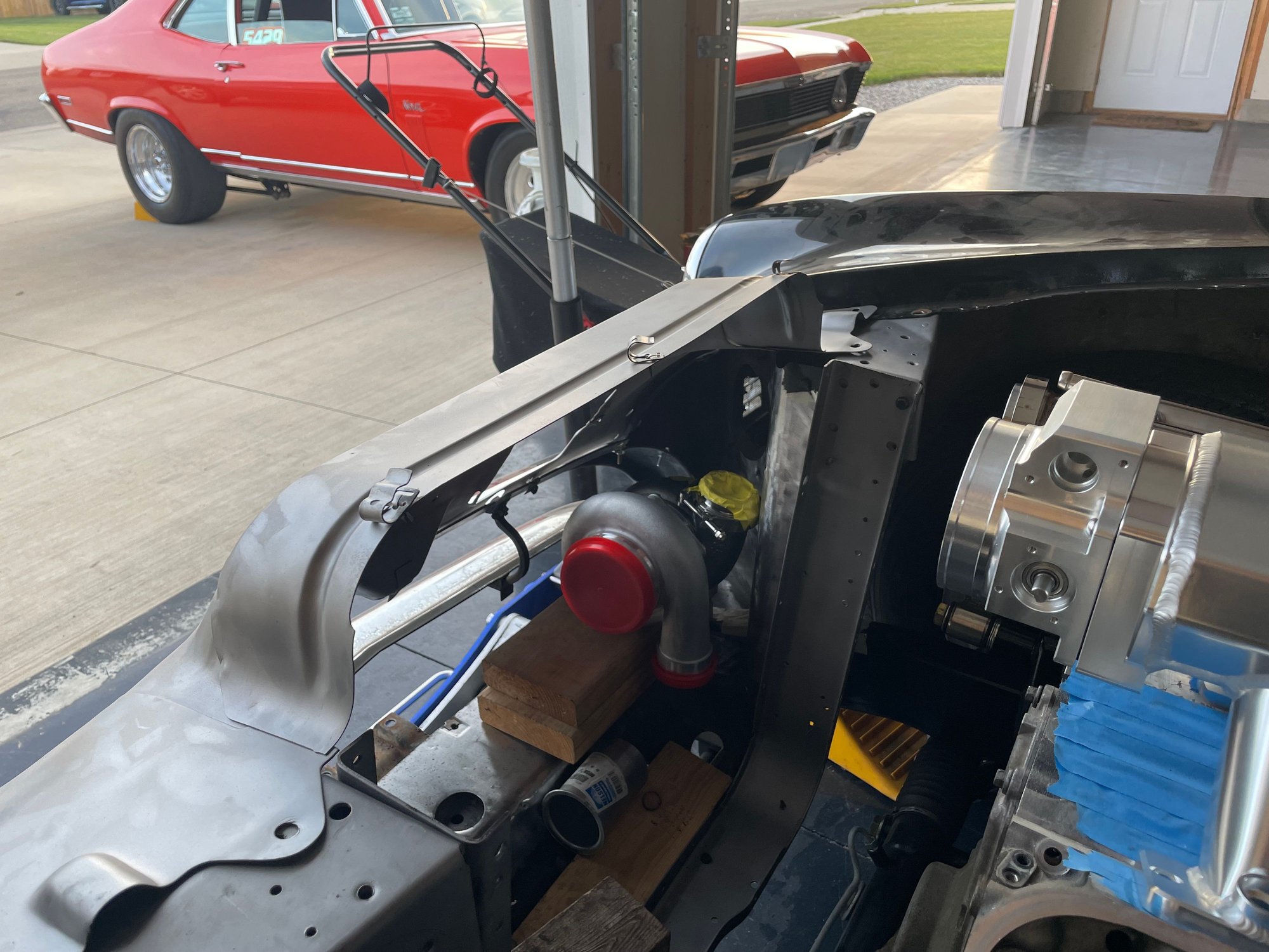

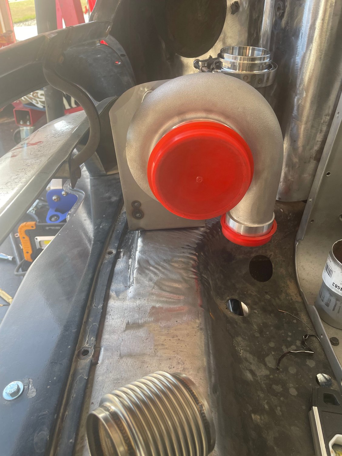

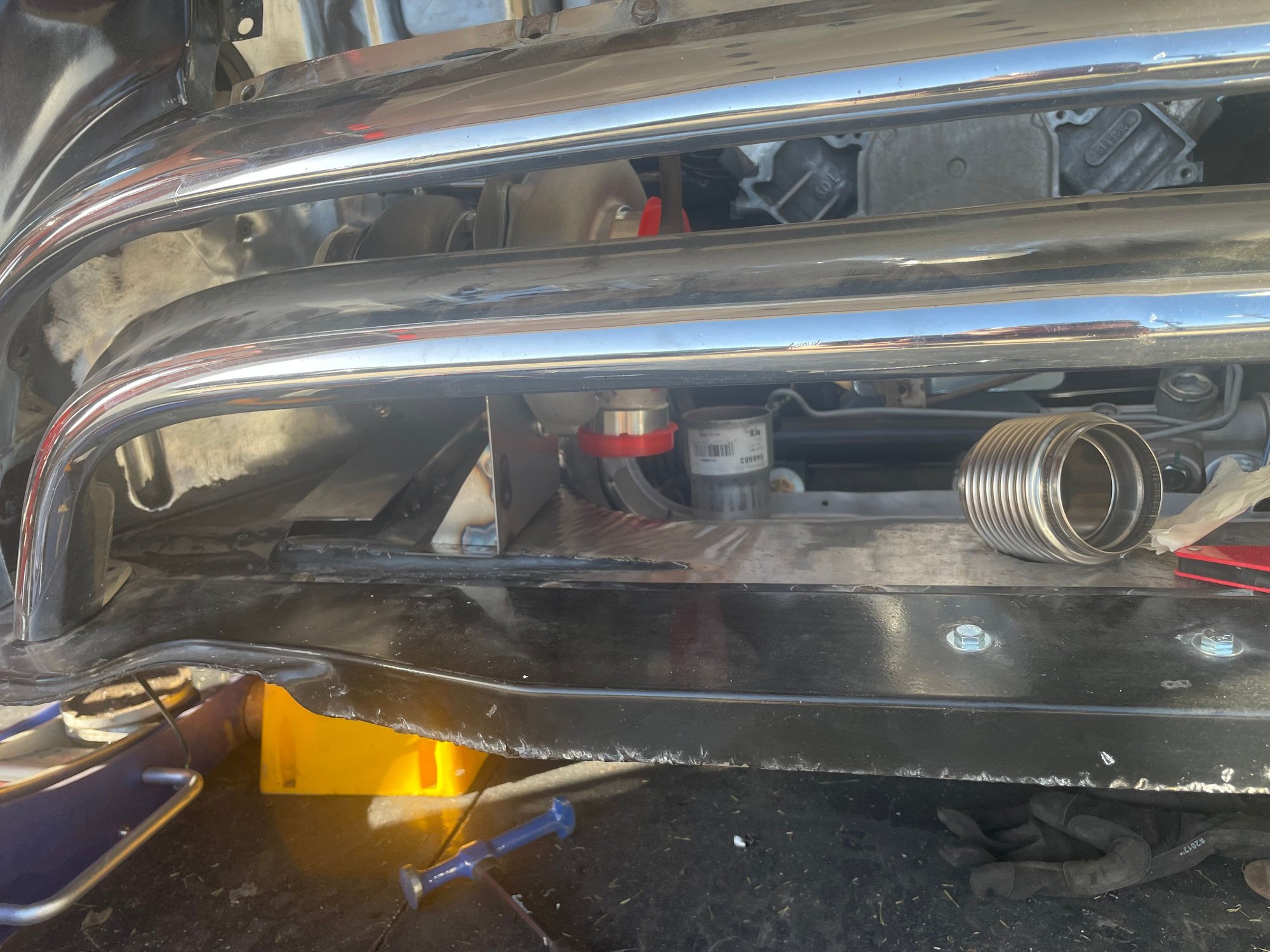

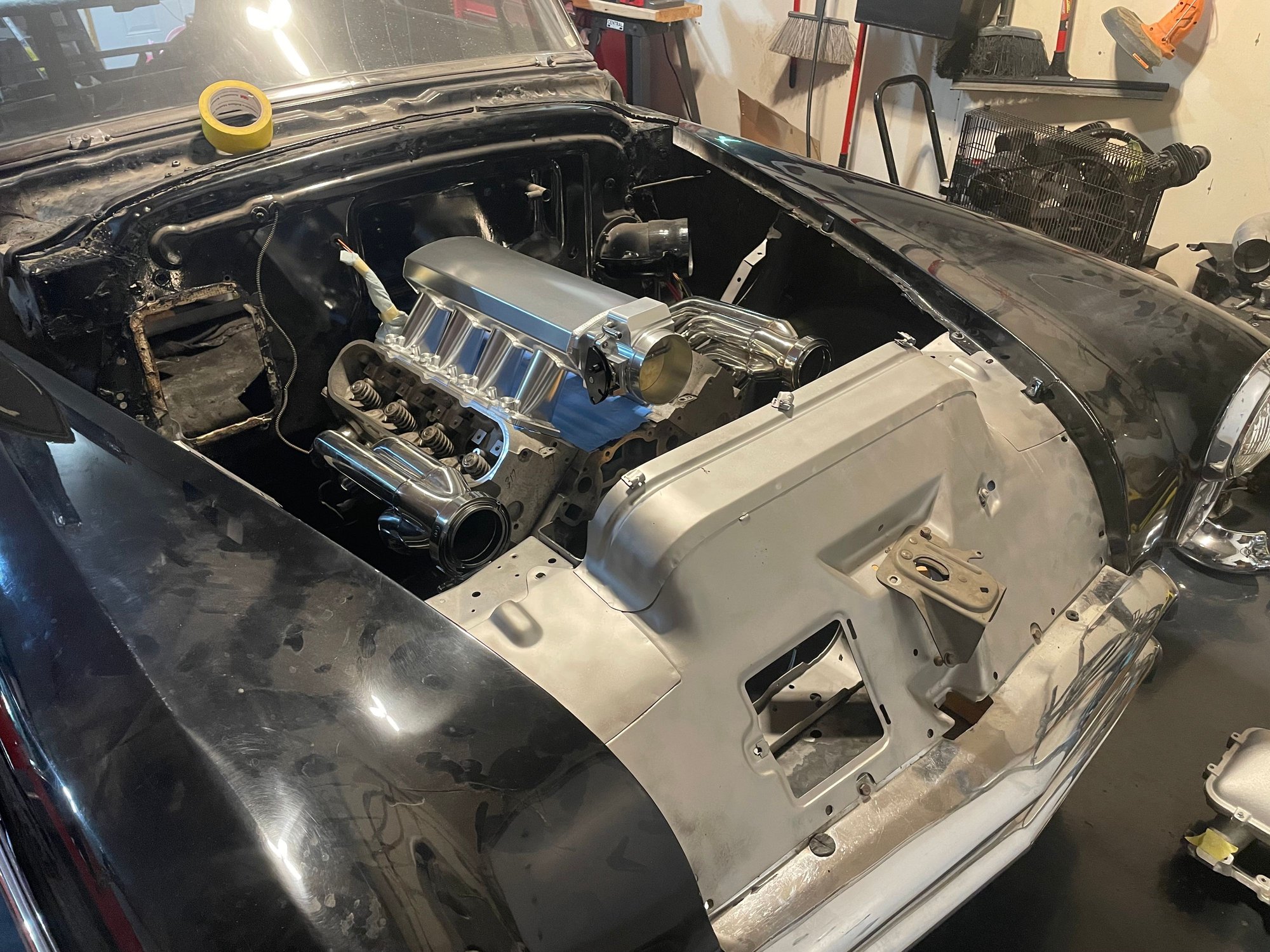

Finally been able to spend a little time on it the last couple weeks. Body is essentially down where it’s supposed to be. Not fully mounted but I believe this is where itll end up sitting. Starting to mess around with turbo locations and mounting. I think we have settled on low and in front of the radiator and condenser. So I guess we’ll be adding a scavenge pump to the build since the turbos will be pretty low. Have to get some piping this week just to make a mock up hot side to see if it’s totally feasible. Only other option is to use the armageddon style manifolds. Exhaust piping will be a bit of a trick. It has to come through the radiator support and then will run similar to how the factory ran there fresh air duct which is up inside the front fenders. Still a long way to go but inching forward.

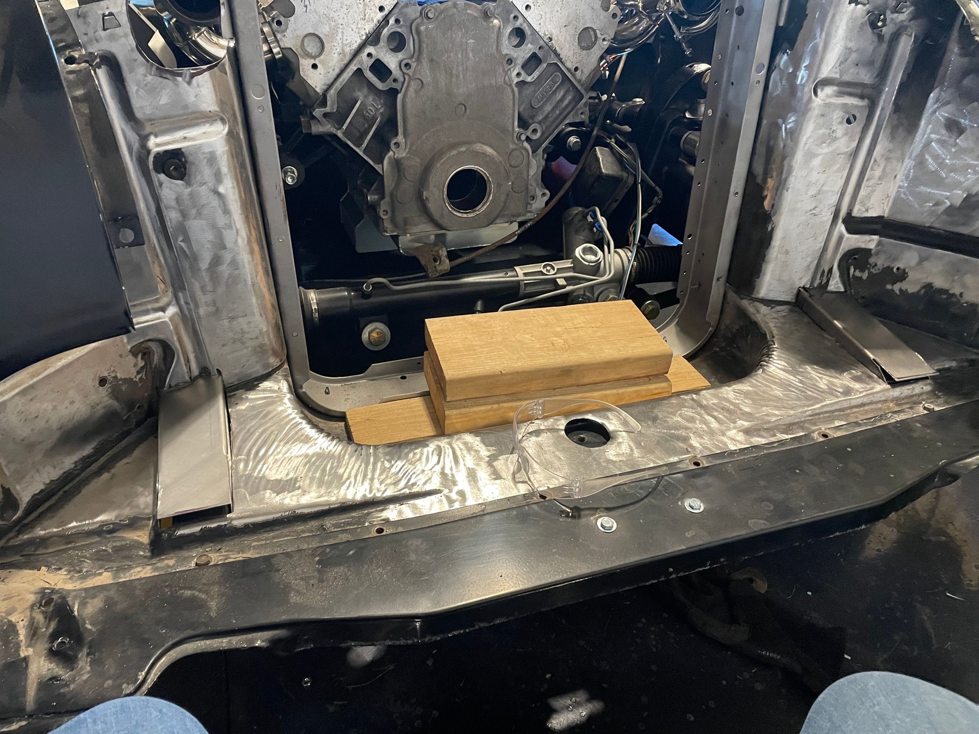

Didn’t get much time on it this week. But did manage to get a couple filler pieces made for the radiator support where I had to trim around the frame horns and got one of the turbo supports mostly out together so I can start fabrication the hot side piping and make a plan for the exhaust

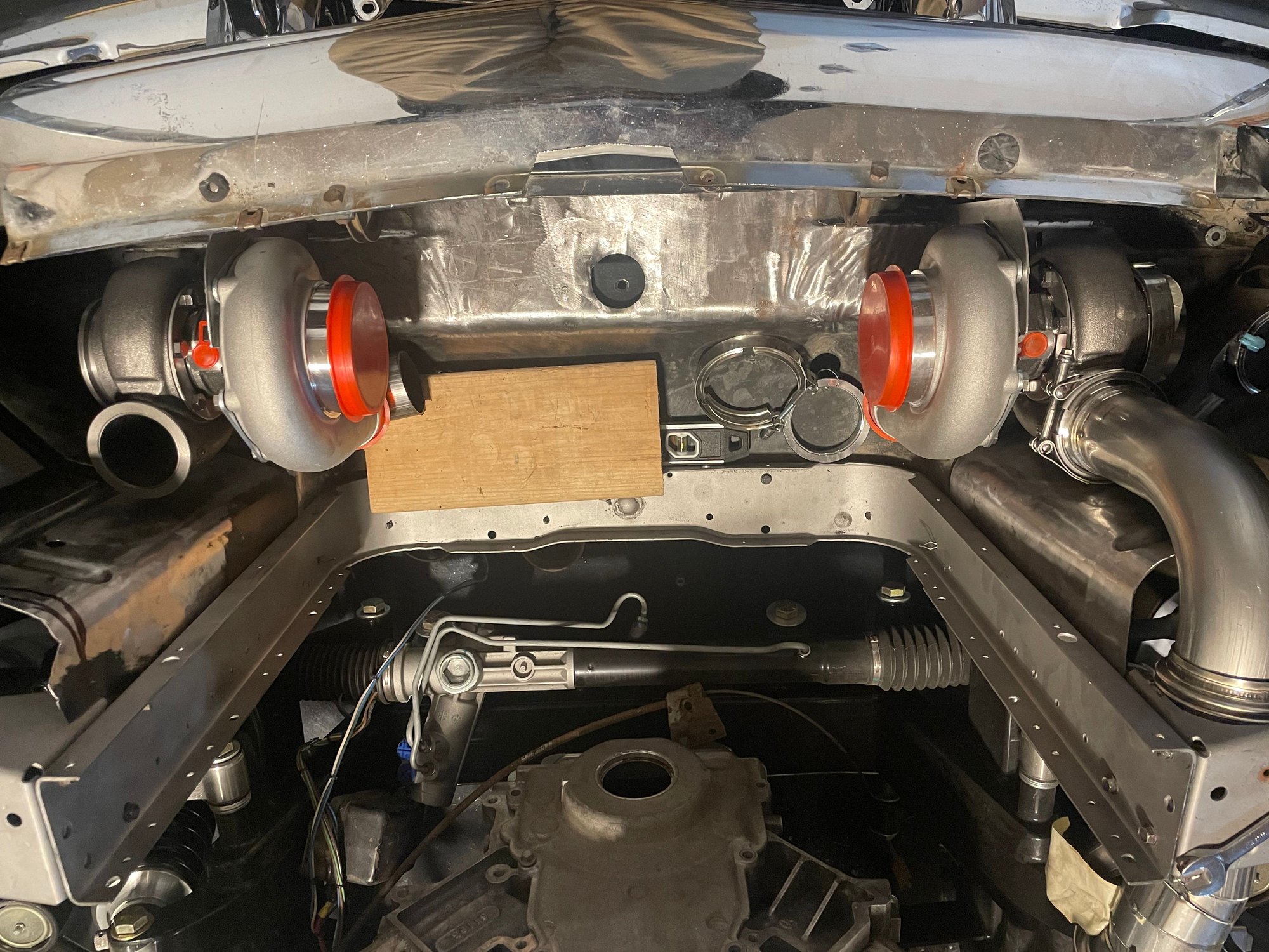

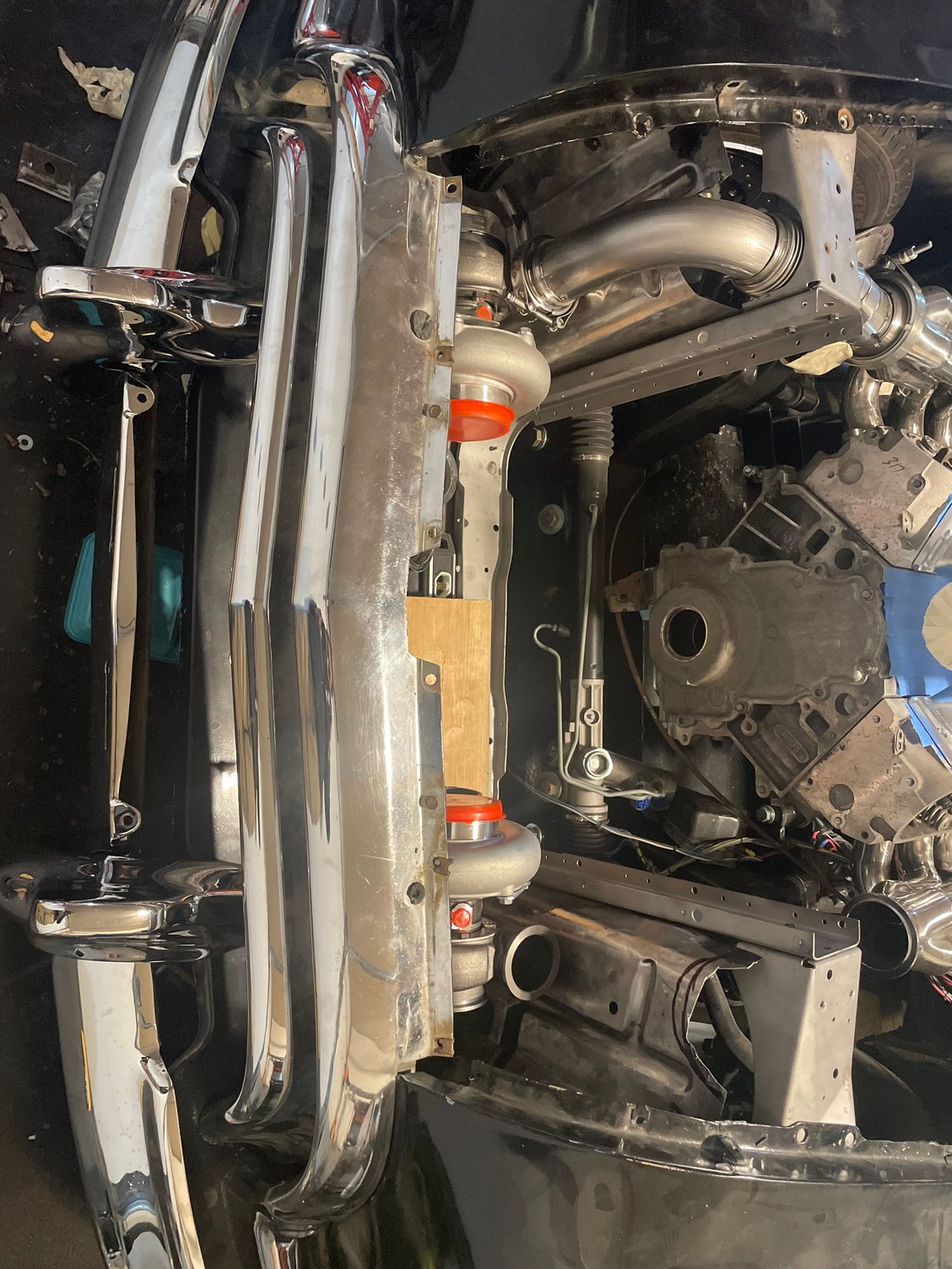

Haven’t had much time the last few weeks to work on anything but. Picked up the second turbo this week and had a chance tonight to get the mount made up quick so I can get an idea of how it’ll actually look. Got the front bumper up into place to make sure it cleared the turbo mounts. I love the placement. The compressor housings will be black so you won’t even really notice the turbos unless you really get down and look for them.

Looks great! What's your plan for the intercooler?
Old Nov 22, 2024 | 01:35 PM
rryan5429's Avatar
Joined: Feb 2013
Posts: 161
Likes: 48
From: Aberdeen, sd
Our current plans are no intercooler. It is being run on E85 and honestly won’t be crazy boost pressure numbers. Power wise we will only probably be seeing 600 wheel. We will give it a try and see how it goes. If it doesn’t work then we will have to get creative to figure out what we can make work.

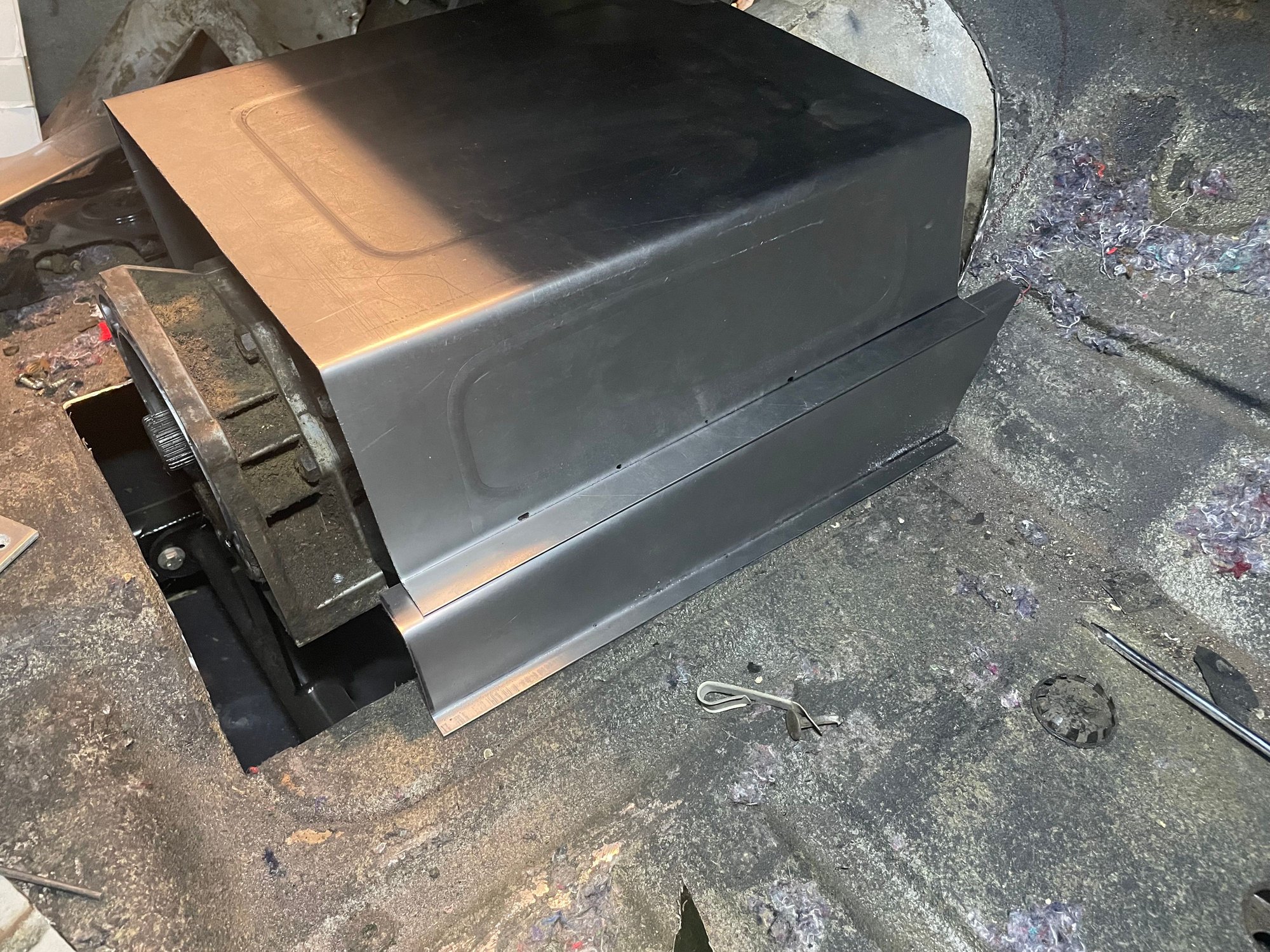

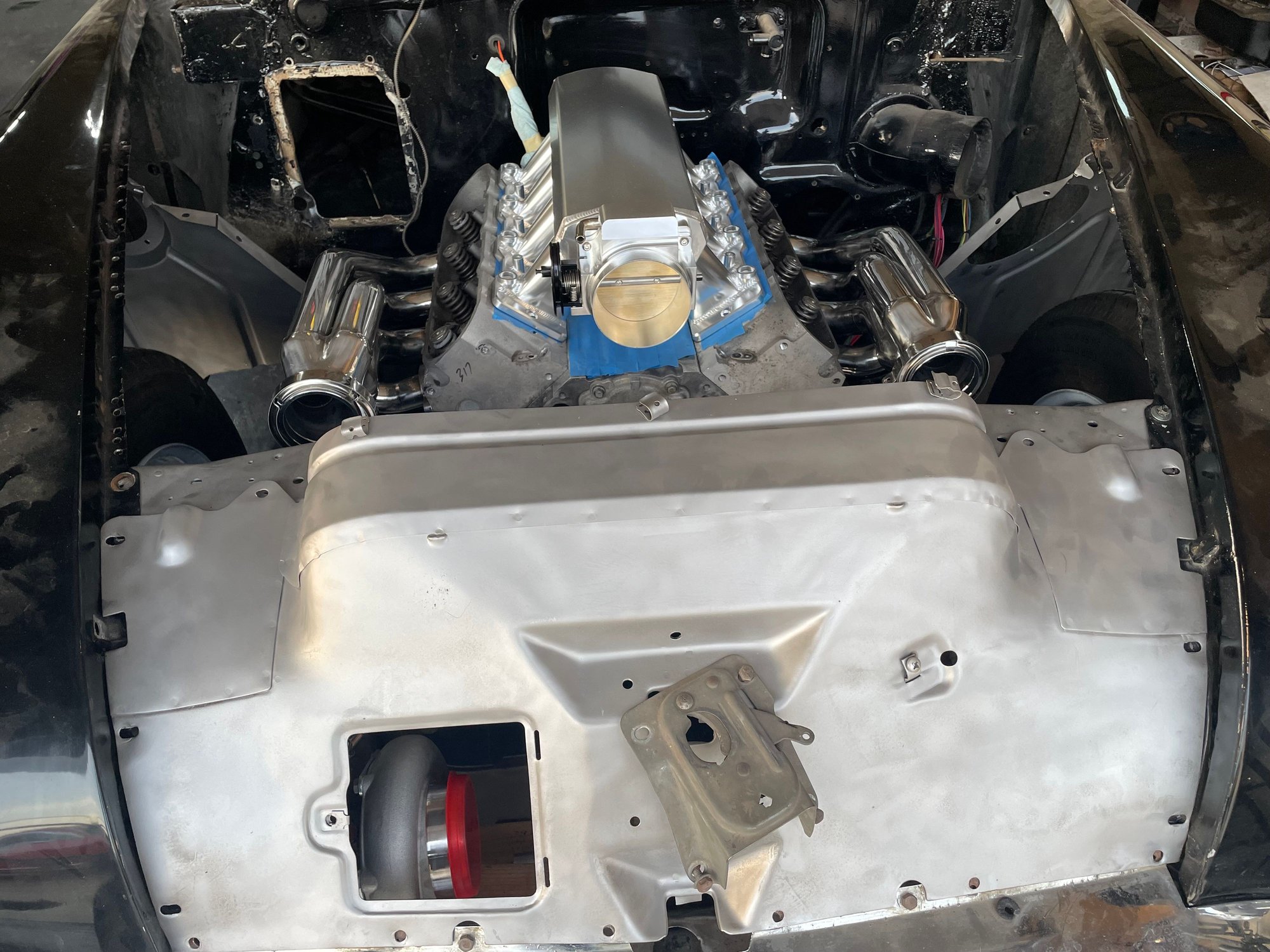

This I’m Started to put together ideas for the transmission tunnel. I’m on the right path but it needs a few modifications to make it a little cleaner. But for my first go around not terrible. At least a got a little more practice playing with the bead roller. Have a few weekends open over the next two months so hopefully can make a little more progress.

pictures didn’t load last night but here is what I got so far
