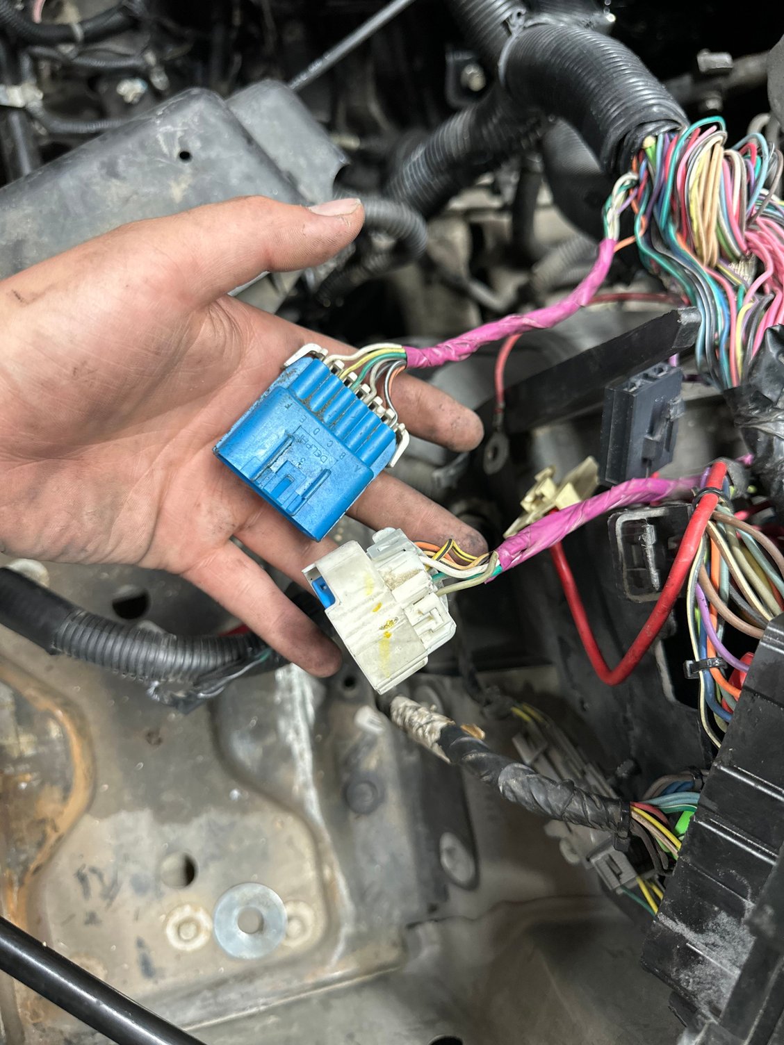

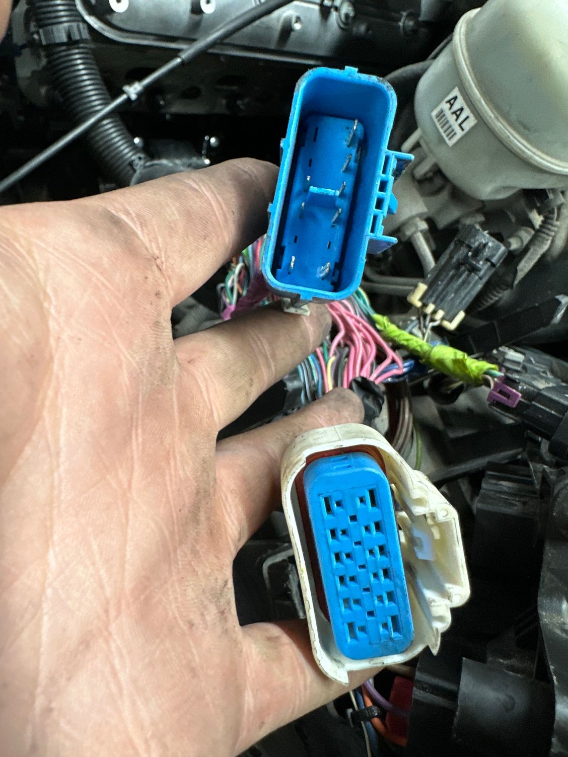

recently put a 6.0 out of a 02 silverado into my 06 silverado single cab everything is on good and I have the harness and ecm from that motor the only problem I’m having now is there is a connector from the engine harness that’s blue that’s not matching up with the truck body harness that’s white ,s there a way to make it work like an adapter or what’s a solution does anyone know?

That’s the harness and ecm I have from a 99/02, my problem is that ,that harness doesn’t match the original truck body harness from the truck witch is an 06 if that makes any sense ,basically I bought the motor complete with harness and witch was pulled from a 2002 truck and now that harness that came with the motor doesn’t hook up to the truck that it’s getting swapped into witch is an 06 truck
For everyone here that needs to understand this:
99-EARLY 03 Engine Wiring Harness GOES INTO 99-EARLY 03 Truck ONLY
LATE 03 - EARLY 07 Engine Wiring Harness GOES INTO LATE 03 - EARLY 07 Truck ONLY
I think that should work...
