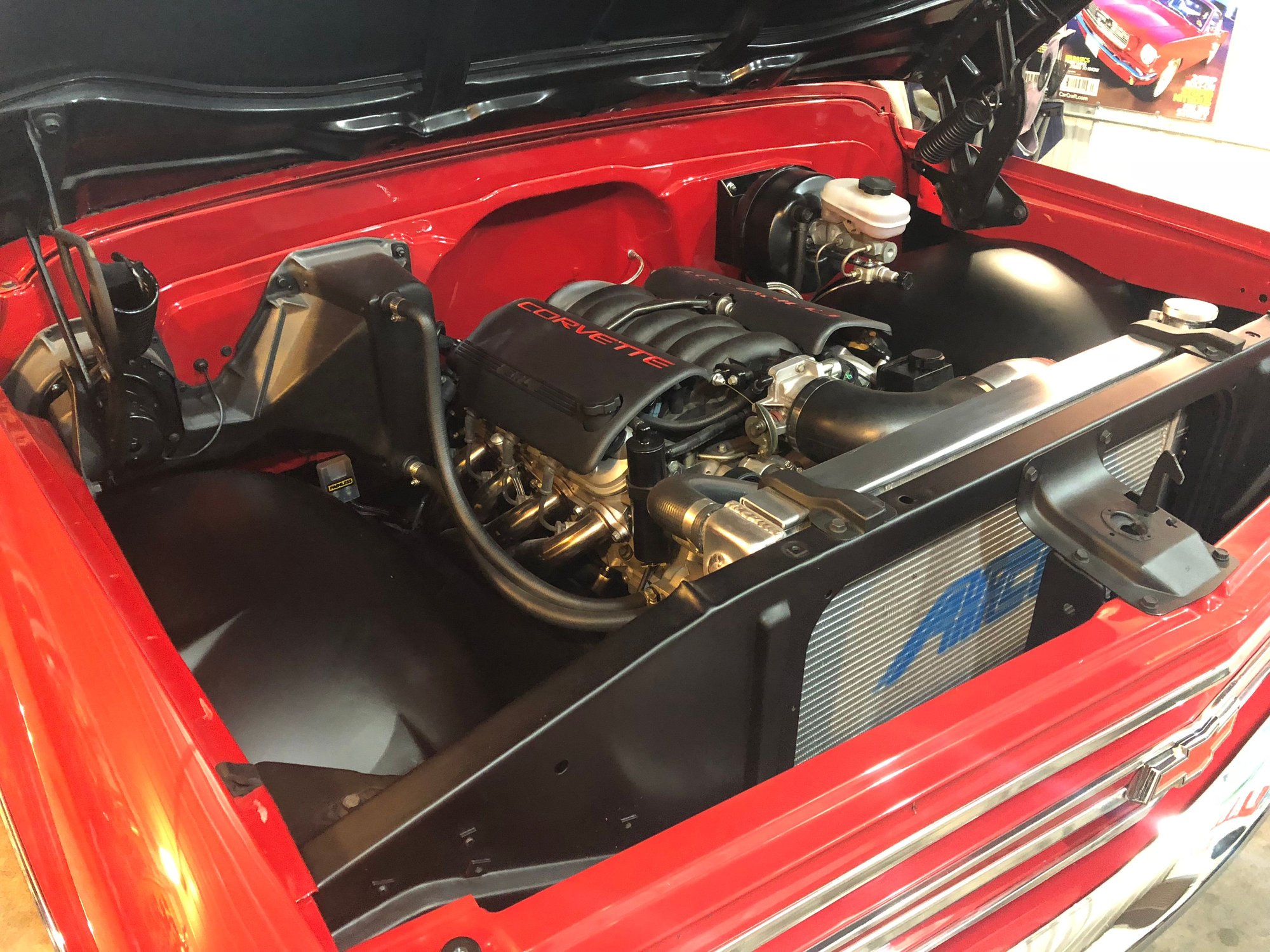

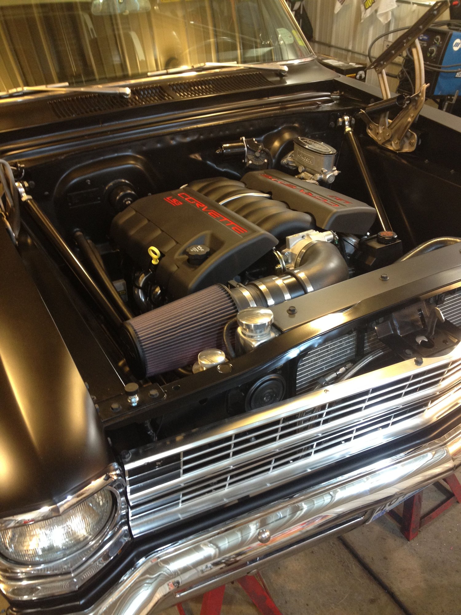

I've used Lokar on a number of LS swaps and they worked just fine. They are flexible.
For more of stock look the LS3 Corvette dip stick works well.
Couple pics.
