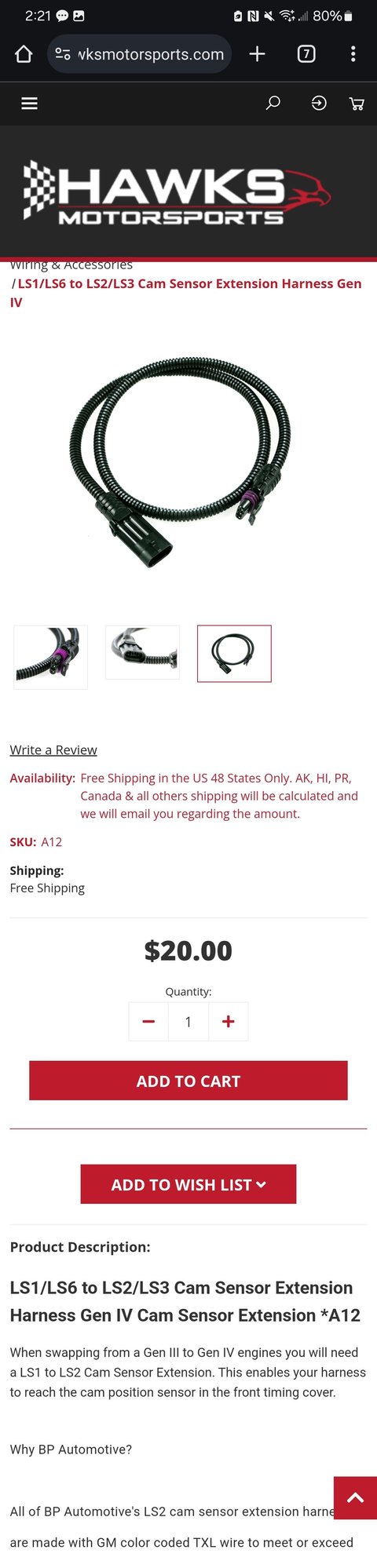

Your C5 was wired for the cam sensor in the back of the engine. Your new engine has the cam sensor in the front. With a quick search you can find the adapter harness that will plug into your existing harness. It looks like an extension harness but it also flips the wires as the LS1 and LS2/LS3 cam sensor are wired differently.

Something almost like this?

Gen 4 is not going to plug right in....need cam sensor extension and a 58x-24x converter.

Thank you will order right away
