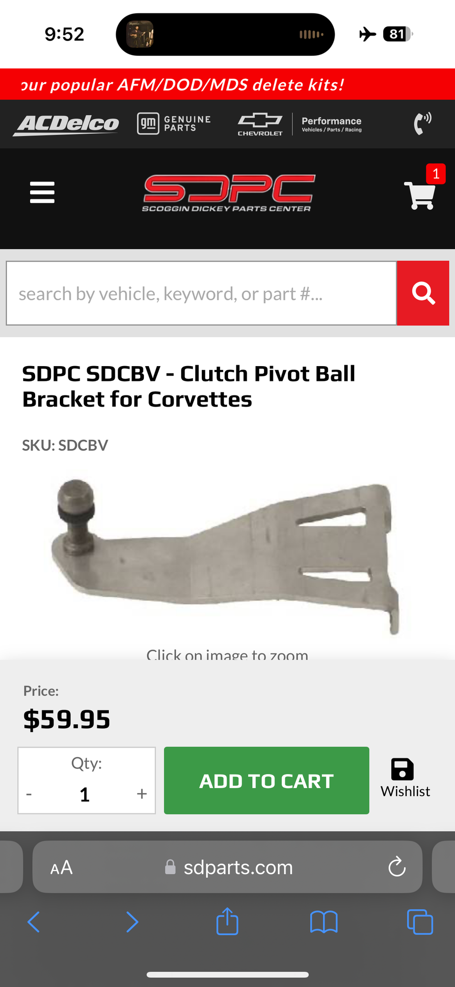

Hey all was wondering if anyone was running this bracket setup in there C3 Corvette? I was hoping to run the mechanical z bar setup instead of hydraulic but was hoping to find out if the bracket works fine. Thanks everyone.

Don't know if this helps but on my 73 Camaro with a LS3 TKO 600 swap I made the pivot shaft/arms and frame bracket mount. I used the bolt hole behind the header on the cylinder head for the engine pivot. 3/8" rod ends. I would question if the bracket shown above would clear the header tube.

I made one that came off the left engine mount. There may be a square boss on the left rear of the block that interferes with the SD mount that can be round down. Also note that the geometry will be affected by the location of the adapter plates you use.

Just a thought on the mount shown above. Maybe it's designed to slip under the rear header tube and be between the last two tubes?
