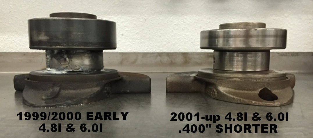

It's actually 1999-2000 4.8l and 6.0l Engines that had the long Crank Flange. I've seen both in person, looks like this:
Very distinguishable with the short one almost flush with the cover. That above pic with it sticking out that much has me curious, the seal mark in my pic is from the inner seal on that Rear Main seal riding on the flange, the outer lip is just a dust seal.

@the_merv Thank you for the correction! I like your added text and will update my thread to list your great "summary".
IIRC, these long-crank LS engine came with an older style transmission. 4L80E?

Longer Cranks were in the early 6.0l trucks of those years with 4L80E beind it.
The 4.8l was in the 3/4 ton Vans that had a 4L80E behind it. Severly underpowered setup IMO.
