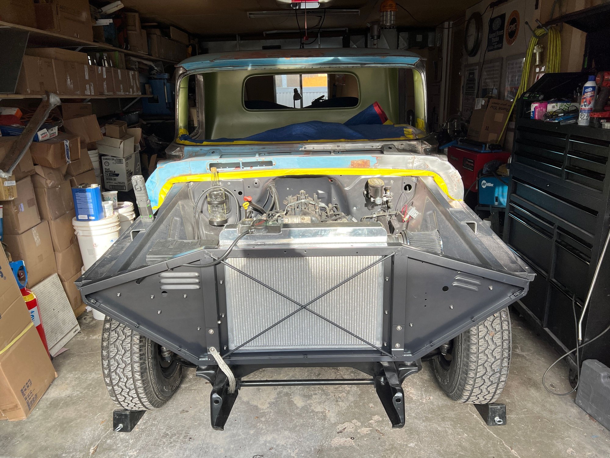

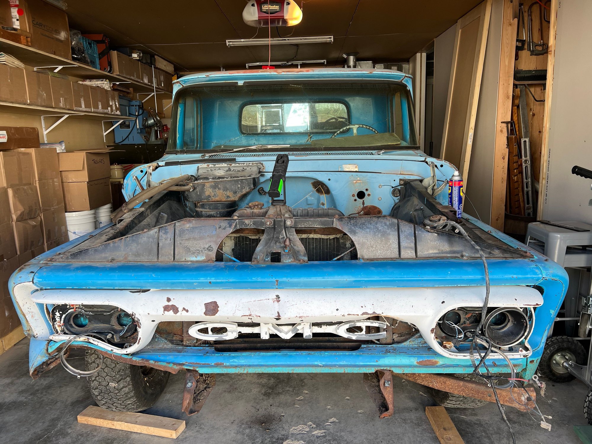

My son and I are doing our first LS swap in a 1963 GMC we picked up from a friend by putting a 5.3L Vortec we pulled from a 2004 Chevy Silverado. We've been working on it for about a year and a half, and a couple of weeks ago, we actually got it to turn over. The problem is that when it starts, it idles above 3000 RPM and climbs up in stages until we shut it off. Using our basic OBII reader, we've traced this back to the accelerator pedal, which doesn't register any change when we press the pedal down.
My son's really excited to see the truck move (although, as you can see from the photos, we won't be going far without body panels or a windshield!) But, this is beyond me. I was hoping someone might have some experience to share ...
