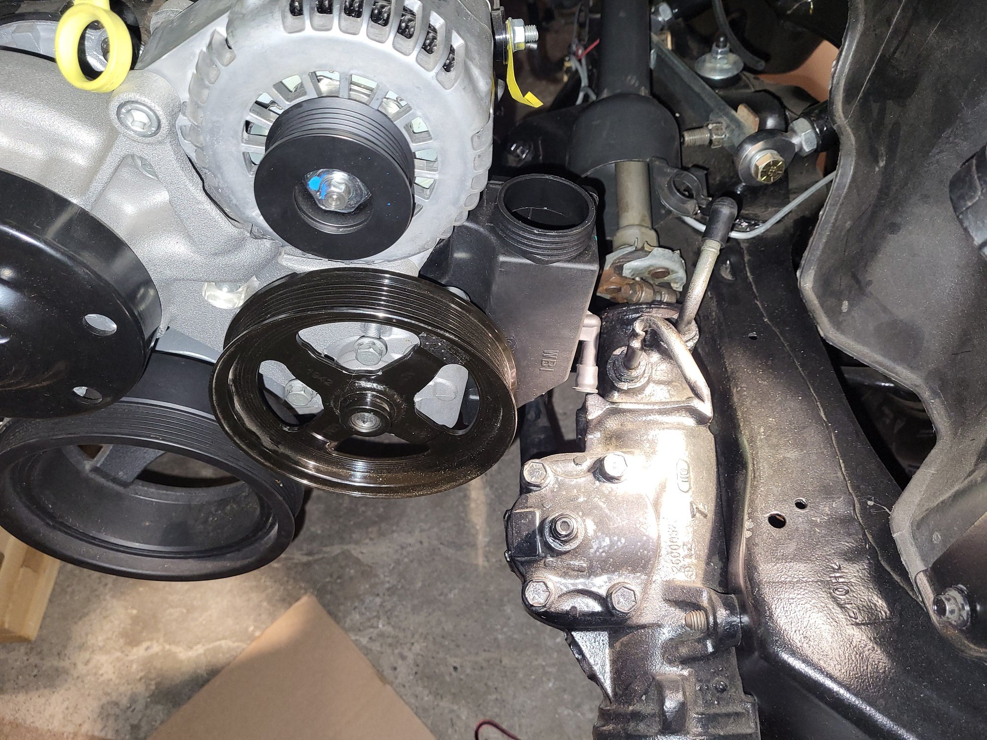

Got a 6L LS with a Holley mid mount accessory kit. The power steering return port is Very close to a rib on the power steering pump.
Move return nipple to the front of the pump? My concern there is bubbling the fluid since I can not put the return as low as the Holley port.
OR
Grind the rib off my power steering box. Not sure if there is anything in there like an oil gallery.

Can't angle it? Depending on what mounts you have you can move the Engine back or forward.

Seems pretty excessive to move an engine/transmission assembly to make a return nipple clear. I'm hoping to find a steering box I can grind down to check to see what's under the rib. Just do not want to experiment on my quick ratio low mileage box. I threw out a spare a couple years ago.

Various other PS reservoirs are available. Google "corvette 2000 power steering reservoir" to see some good examples. The LS1 Corvette hangs it in front of the serpentine belt using a bracket. This is how I do it. Hmmm, you might need a different PS pump then too.

Original turbo Buicks used a fender mtd reservoir.
That "****" is as best I recall not in the fluid area. My last T Type conversion had that milled down without leaks.

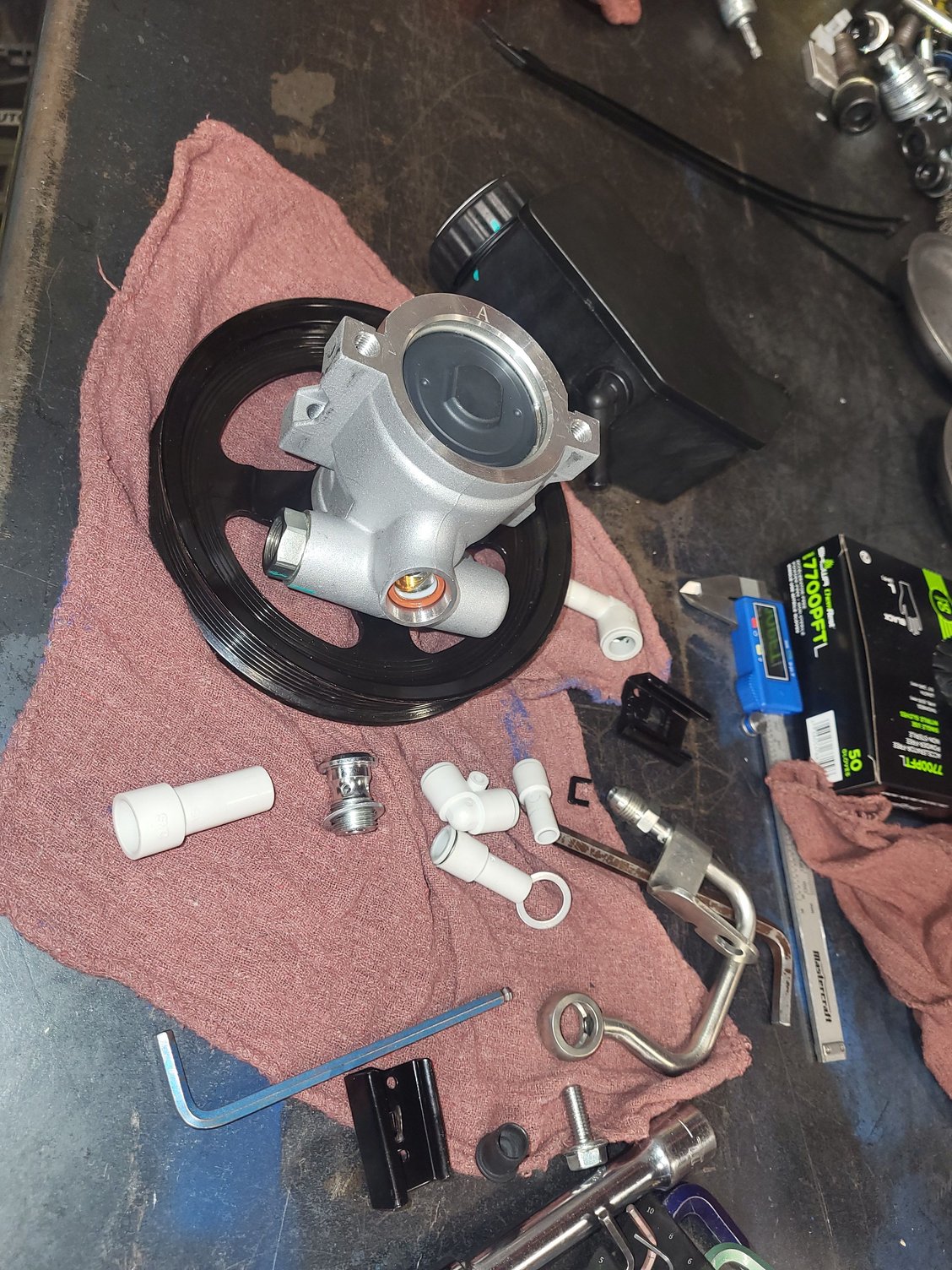

I was attempting to do the remote reservoir but I don't see any way to reliably get a connection to stay in the shallow opening. Anybody have a G body steering box we can grind a rib down on? I will pay you.

Did your pump not come with the factory nipple? Or would it point the wrong way?
In one swap I threaded the inlet for a fitting. In another thread I bought a custom PS pump which came threaded for an AN-8 (or was it AN-10) fitting.

Cut the nipple off and thread a 1/4NPT to AN 6 fitting into the reservoir.
