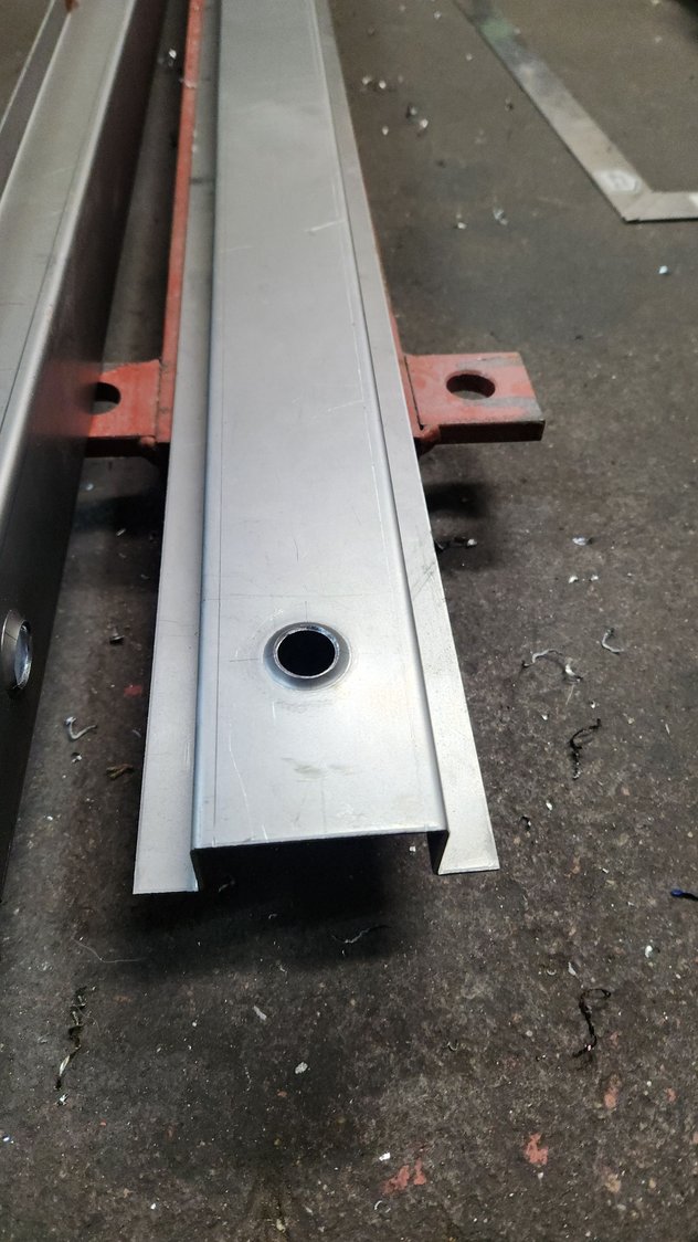

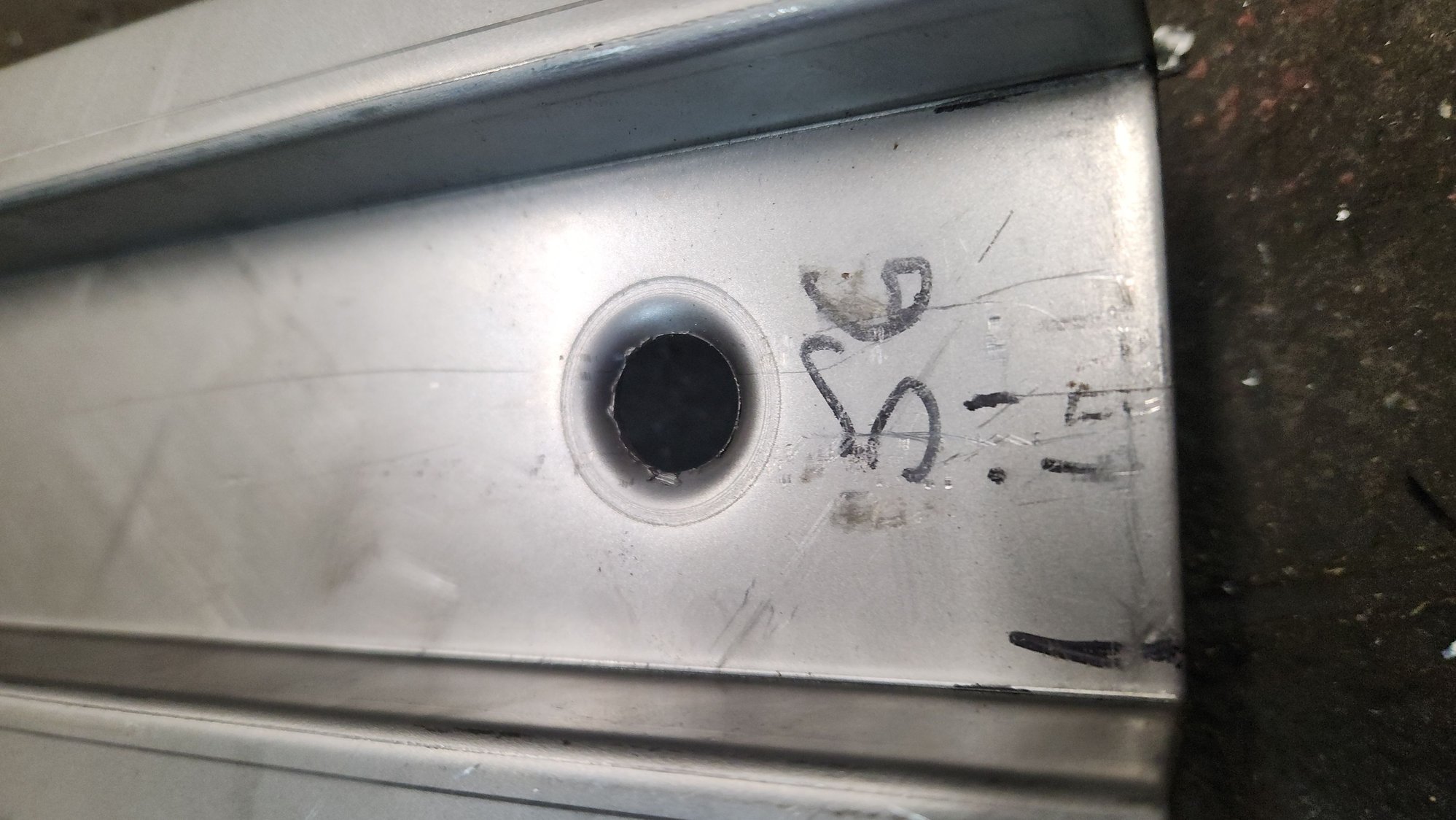

Good evening(in Sweden ),
Some small updates.

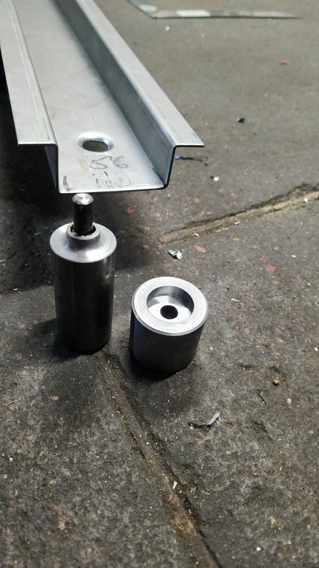

i have started with the frame rails that are higher in profile and goes front to rear, they will be 45mm in front and slope down to 25mm in rear.
I also doing "inverted" rails inside the car that are 20mm high, just to rise the profile of the frame rail(i think the inspection like that).
Have a nice day
C
inside frame rails
inside frame rails

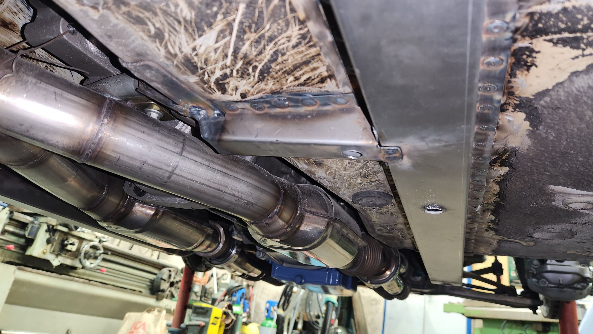

Good evening <img src=" class="post_inline_image" loading="lazy" />

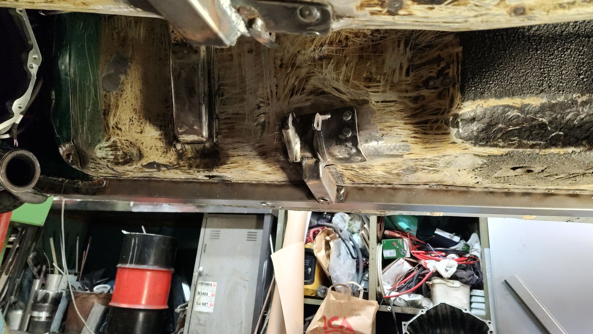

frame rails are done and also some reinforcement to the transmission mount,inspector wants it).
He will visit June 16 for the first inspection and after that i have five years to build for the final inspection were he wants to see a working vehicle.
i also start with the carpet and sound deadening as i wait for him.
Clutch is in the mail and only waiting for the half shafts to be made .

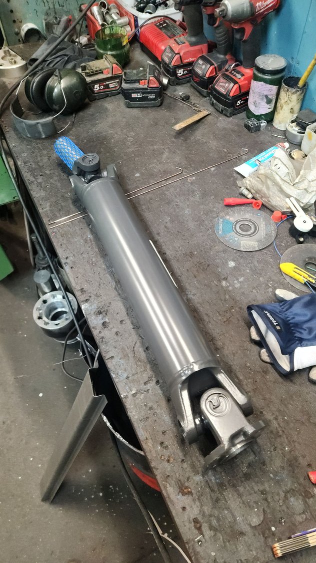

A new props shaft is made, for the first time i bought a new one instead of building my self(want a proper made one)
/Christian

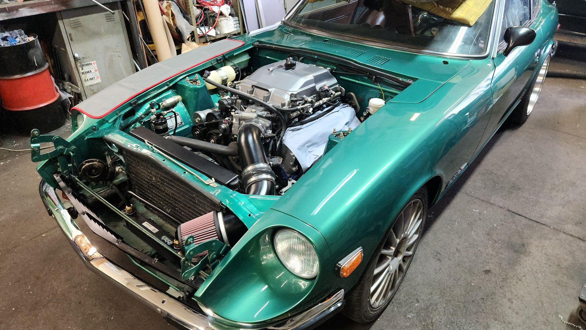

With that done i was able to pain all the weld, start interior work and mount the Datsun back up again, sooooo, it's done just waiting for my half shafts.
The half shafts is actually the only thing that keeps me from a test run.
Brakes, clutch are bled, emergency brake mounted, it's pretty much only interior work that has to be done
Cheers
Christian

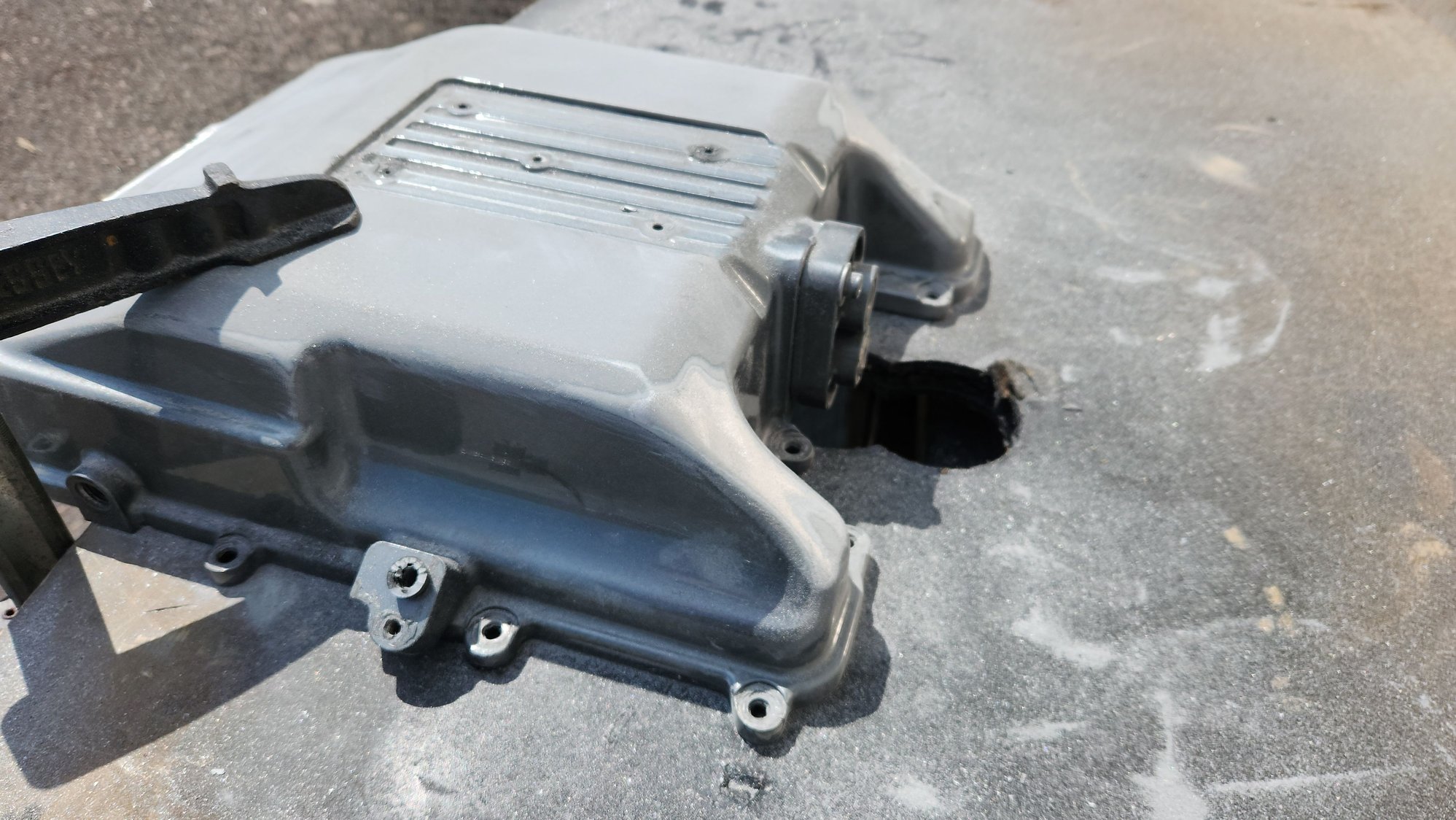

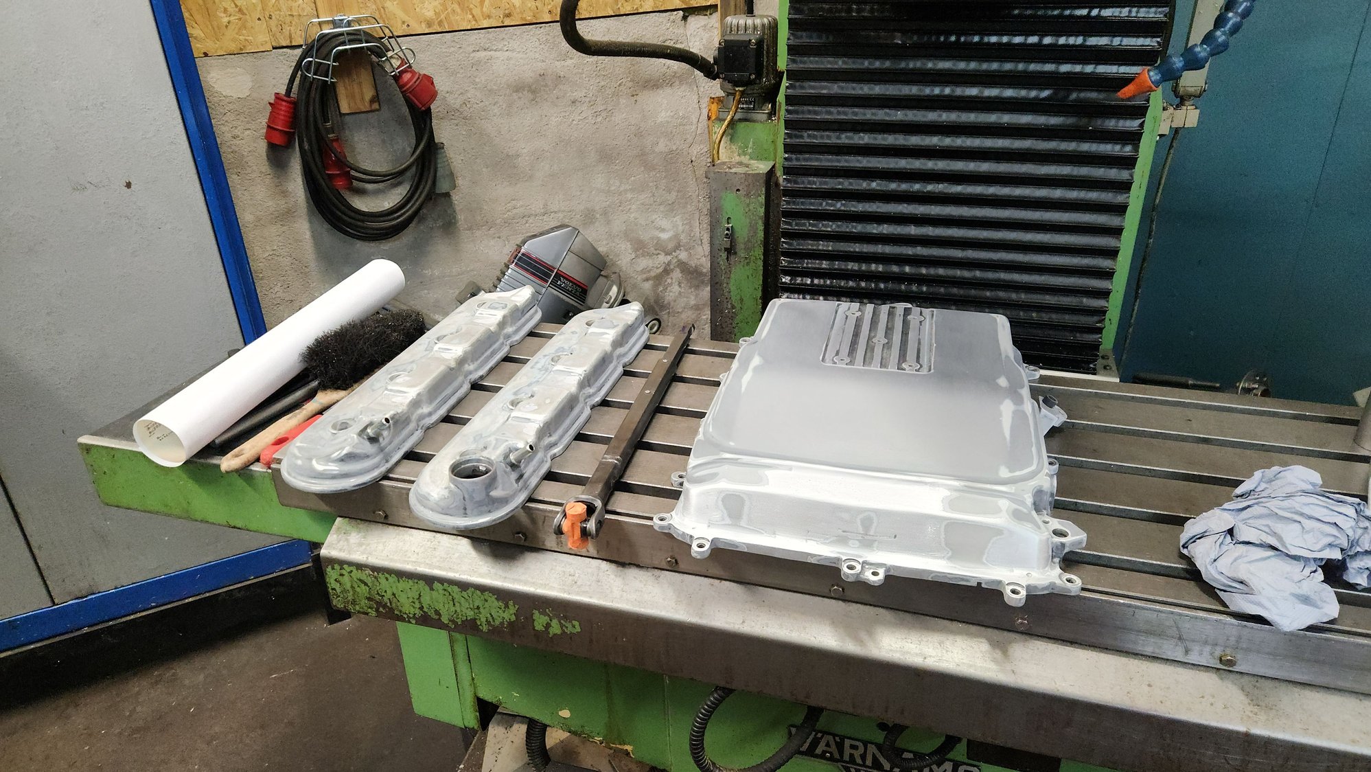

Hello ,
As i'm waiting for my half shaft i'm doing stuff that,s not necessary ...........
removing bosses from the lid and valve covers to make a more "clean" look.
Grinding, grinding and some more grinding to make a bit cleaner.
They will be painted semi gloss black when the paint arrives.

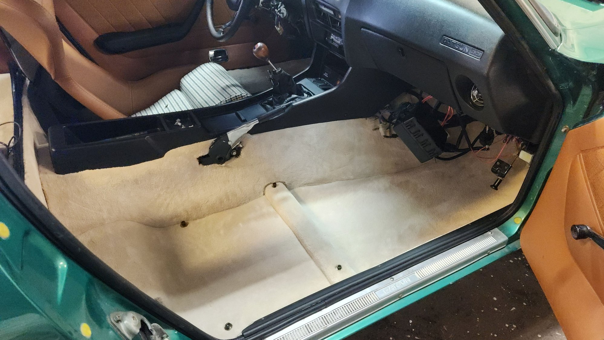

Good evening

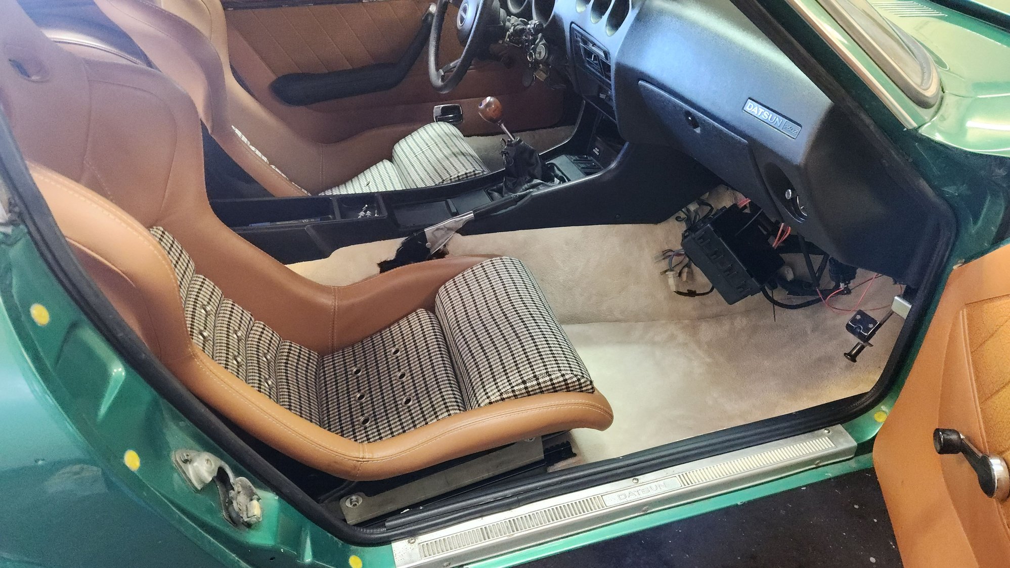

As i'm still waiting for my half shafts i took the time to do things as for me always get neglected when it comes to a test run........(to enthusiastic) i had the time to do some interior work, sound deadening and reinforcement at the rear.
Hopefully the shafts will arrive in early October so it's close.

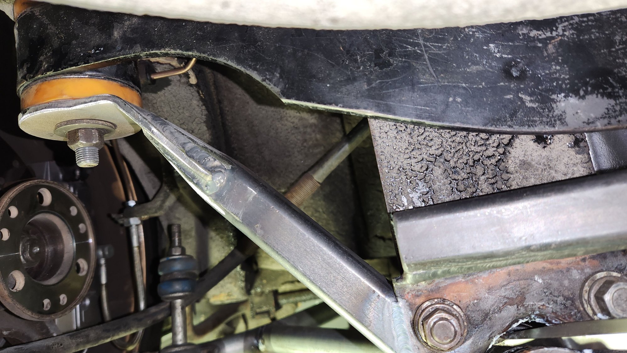

The rear reinforcement consists of triangulation of the control arm and the body, it is a flat iron thats just pointing downwards and i can feel that when taking a corner at speed(flexing a bit).
And i was at IKEA and bought a bunch of owen(?) thermometers to keep track of heat in the engine bay(cheap solution)
Cheers
Christian
Last edited by christianmoller; Sep 9, 2025 at 01:40 PM. Reason: spelling..........:)

Old Sep 10, 2025 | 11:00 PM
  #79
JoshHefnerX's Avatar
Joined: Oct 2018
Posts: 335
Likes: 85
From: Glendale, AZ
That interior came out pretty nice. Carpet looks seriously plush.
it's a little hard to understand what's going on under the rear end - would be interested in seeing some wider view pics - more overall area.
Old Sep 10, 2025 | 11:51 PM
  #80
christianmoller's Avatar
Joined: Nov 2023
Posts: 107
Likes: 139
From: South of sweden
I'll look into that but it's a lot of stuff there so it is hard to take pic's.
/Christian
