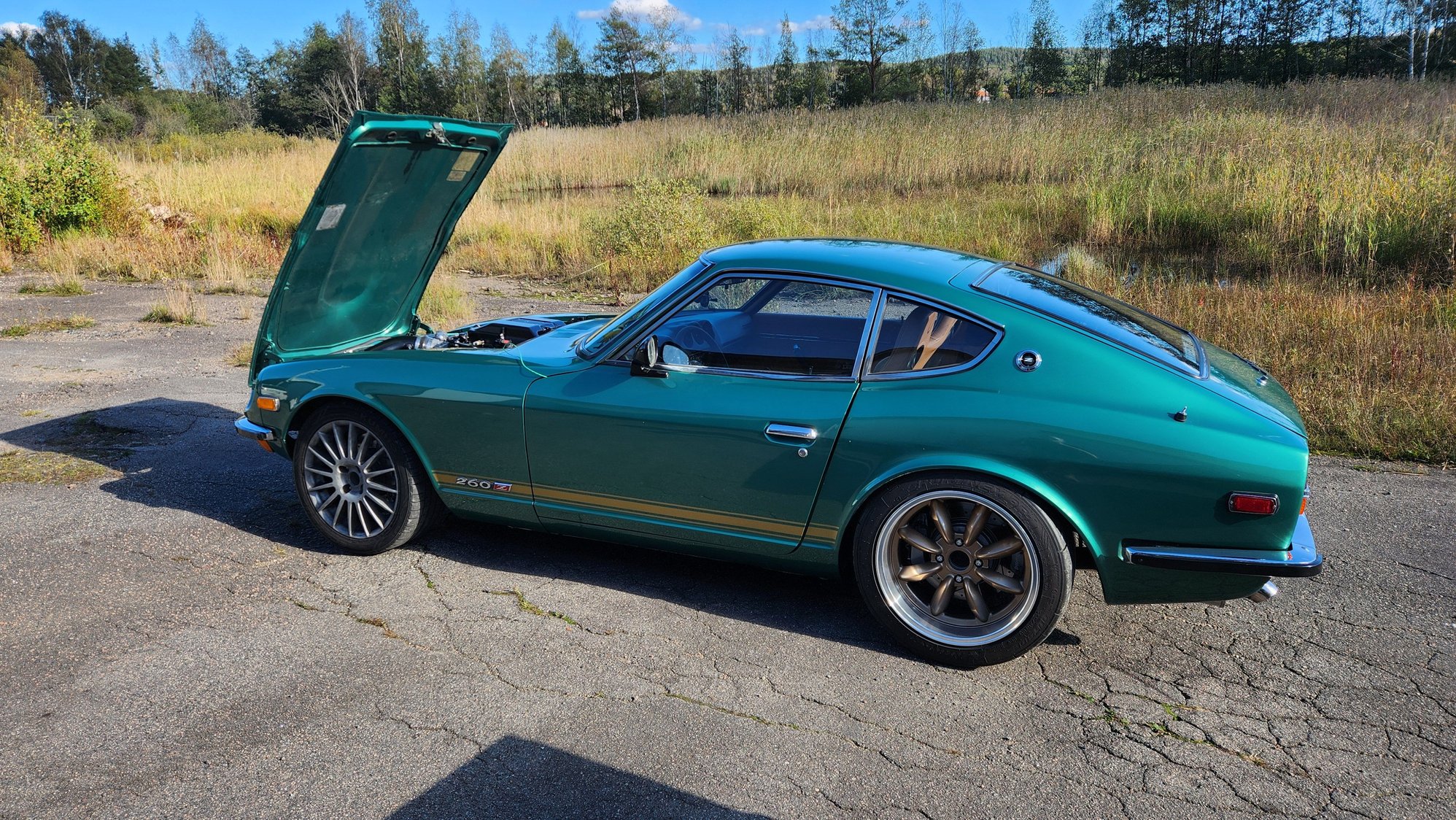

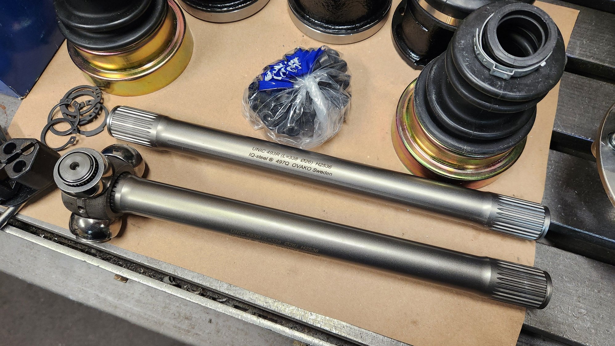

Hello Out of the garage for the first time in two years
Got my shafts today so after 45 minutes i had two half shafts mounted and have done a first test run just to make sure brakes work, steering and some light throttle.
/Christian

Hello ,
This weekend i have been out driving around and have collected some log and it is rich.
I'll need to pay someone to get a decent tune to drive around town and country roads to sort the rest of the car as i dont have the skills right now.
I also made a very not scientific wheel aliment so its safer to drive.

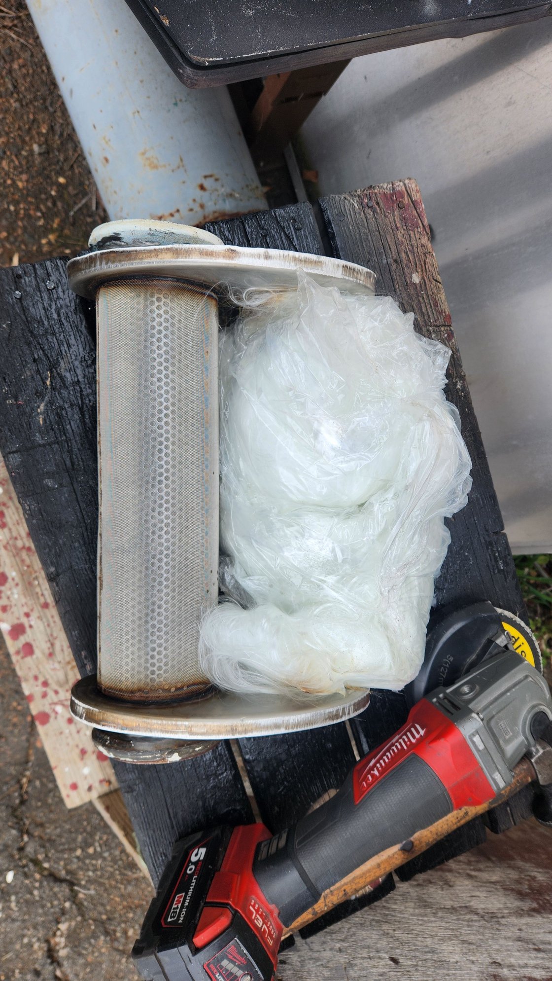

I also realized that i have to manufacture a new rear muffler as i have a terrible sound at around 1700-2000rpm.
I had an old 3" muffler that i will do something with to make it a bit quieter for a start then build something more accurate(resonator and absorption).
I have flipped the baffles around to get a not strait thru, will se what that gives me.
/Christian
