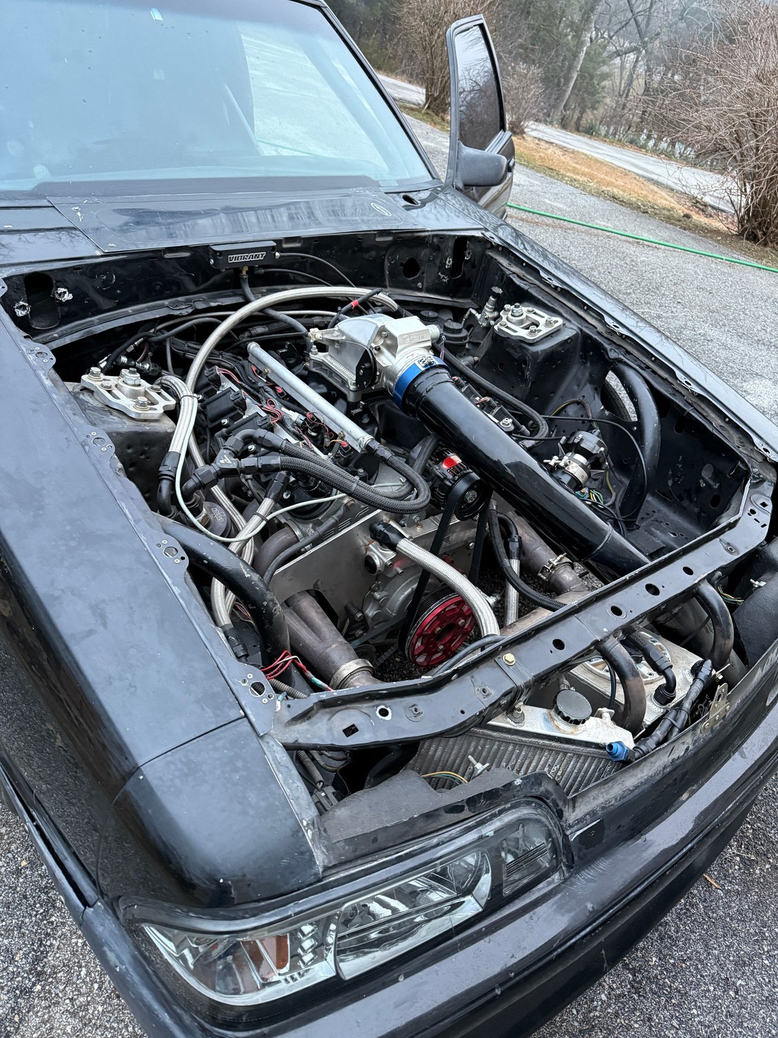

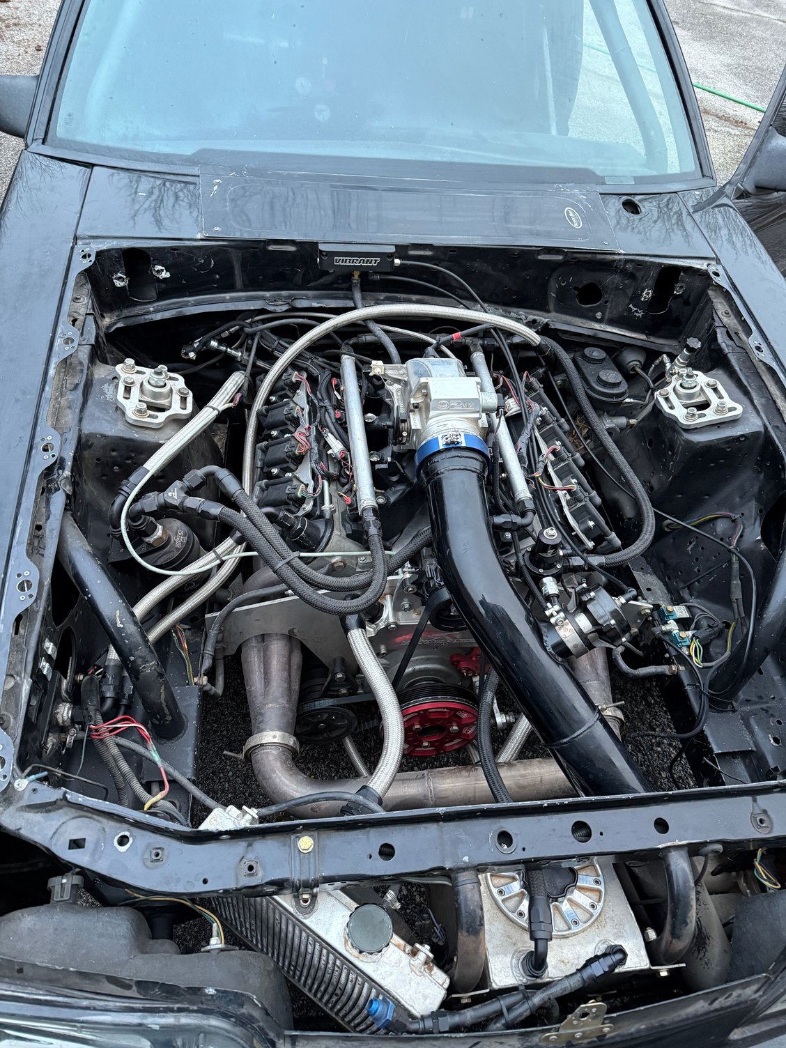

I recently bought an 89 fox body, LS turbo swapped. The car is setup for drag racing only now, but down the road, I would like to get it to be able to do a drag and drive event. But for now, just go fast. 6.0 LS, prc heads, johnson lifters, forged crank, rods and pistons, ati powerglide (1.69 1st), ptc converter, tuned on methanol. Belt driven fuel pump, Jose 88 mm turbo, Holley dominator, 16v battery with 16v alternator, 9in rear end with 3.89 gears, ladder bars with wishbone, big tubs, viking shocks and struts, strange brakes, belek wheels, 10 point mild steel cage. Seller said the car has been 4.80 with the 5.3 at 3200 pounds. Now they have the built 6.0 in it and the added weight is out. I'm taking it for a dyno tune on 1/10. Then as the weather warms up, I'll get a track tuning appointment with my tuner.
I'll post up some pics and a video of it.
My question - What should I do first? Seller said he'd get a dyno tune and then do nothing other than take it to the track and let it rip.

A tune for the new setup is definitely a good first step.
If you want it to be a street car, I'd look into converting it from methanol to E85 (if you have it available). Your tuner should be able to easily determine what your potential downsides would be switching away from methanol (if any, depending on the setup).

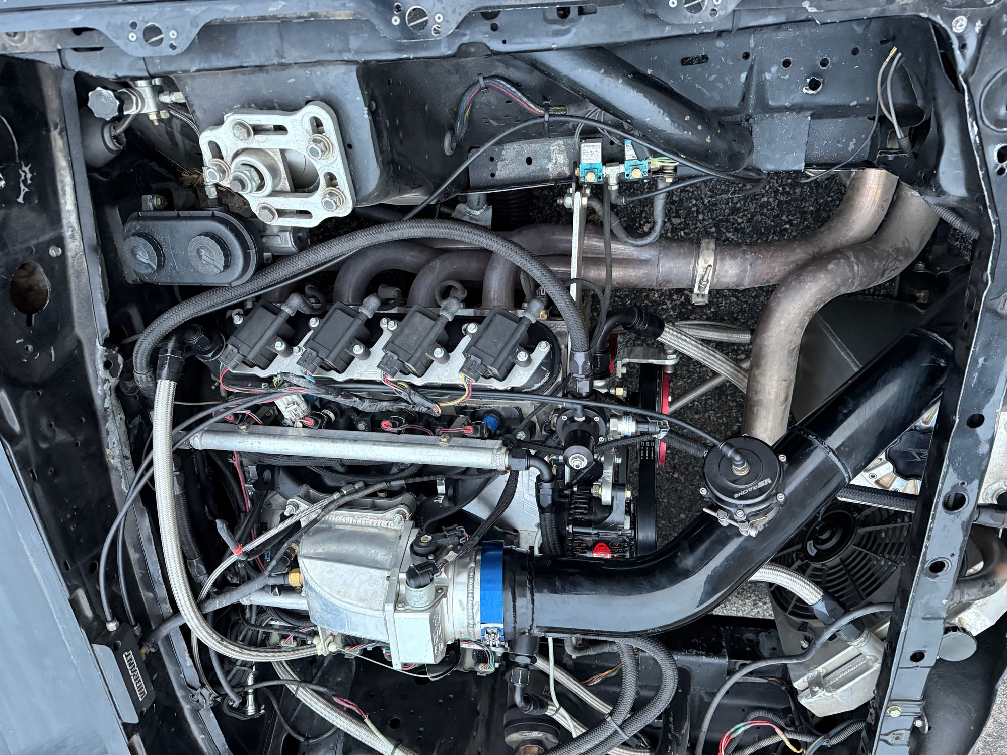

it now has a forged internals 6.0 in with PRC heads, 88 mm turbo, co2 boost control, Holley dominator, 220 pph injectors, methanol, power glide, etc.

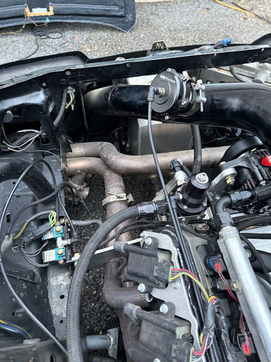

I’ve been itching to get it on the dyno and make some pulls there. We had a few issues that we had to resolve. Boost sensor wasn’t working. Swapped sensors and fixed that. Oxygen sensor wasn’t t working. Swapped that and fixed that. Springs in the waste gate were pretty heavy. Swapped those to lighter springs.
We figure that the motor should be good to around 1300 whp. On the last pull, we ran out of injectors. 84% duty cycle. I ordered a set of billet atomizer 550 pph. Last pull we made 25 psi. Head gaskets are mlx, so we are going to swap them as well. Ordered a set of Athena’s. The turbo pumps is going to max around 1300 hp. The shop had a freshened up 98mm promod, so I bought that and having that installed as well.
Car made: 1120.2 hp and 1220.1 ft/lb
next visit in a couple of weeks, I should touch the 1300 hp.

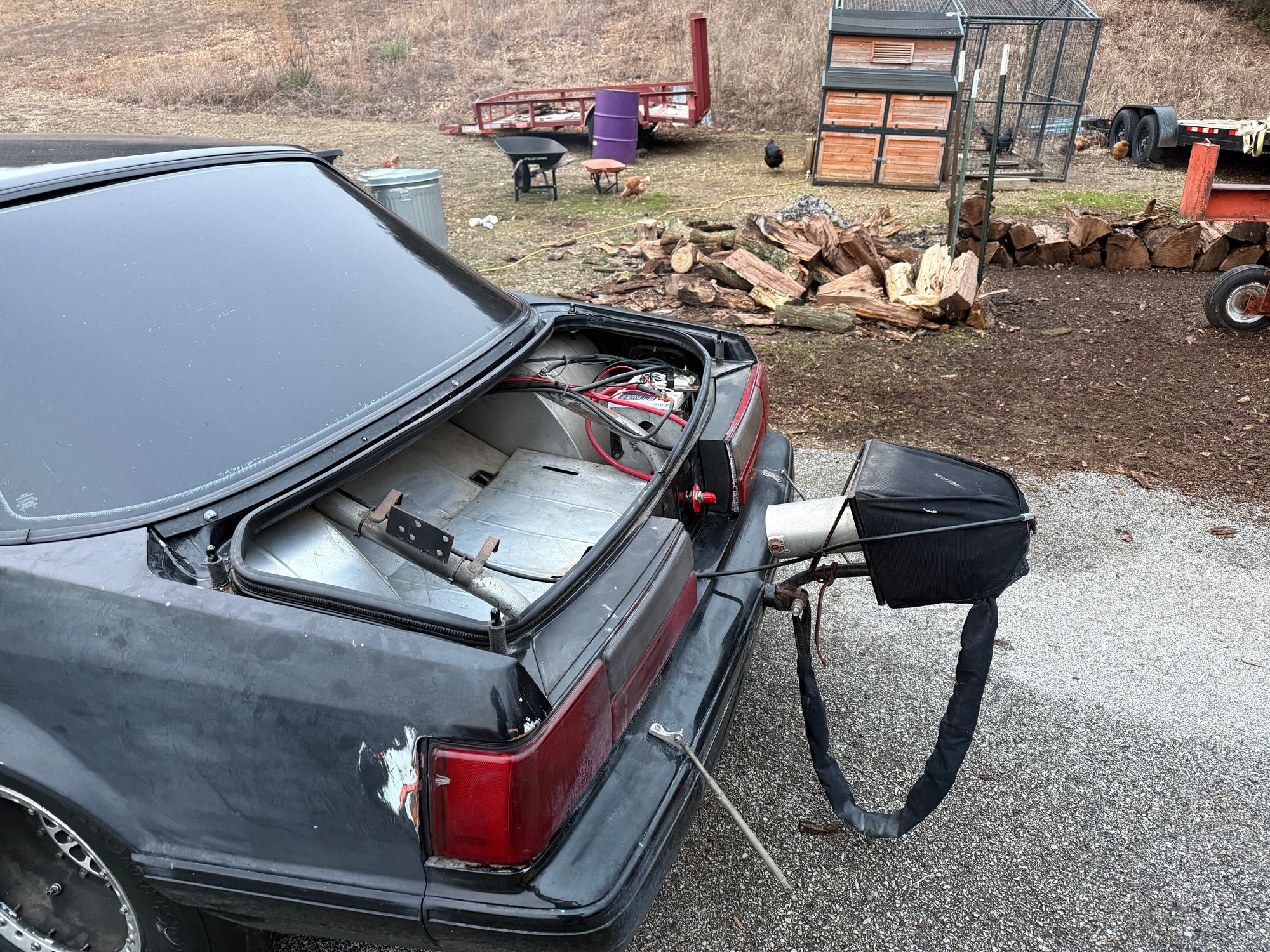

I've made A LOT of changes to the car vs when I bought it. Biggest change has been motor and turbo. Went with a 427 Mueller engine with pro mod 98/108 turbo. The motor is built to handle around 40 PSI. I added a lot of sensors. Davis VPS, DS speed sensor, Front shock travel, rear shock travel, exhaust back pressure, EGT's on the header pipes, then it had the basics. Changed the parachute to launch with a button via pneumatic cylinder or distance set via VPS.
