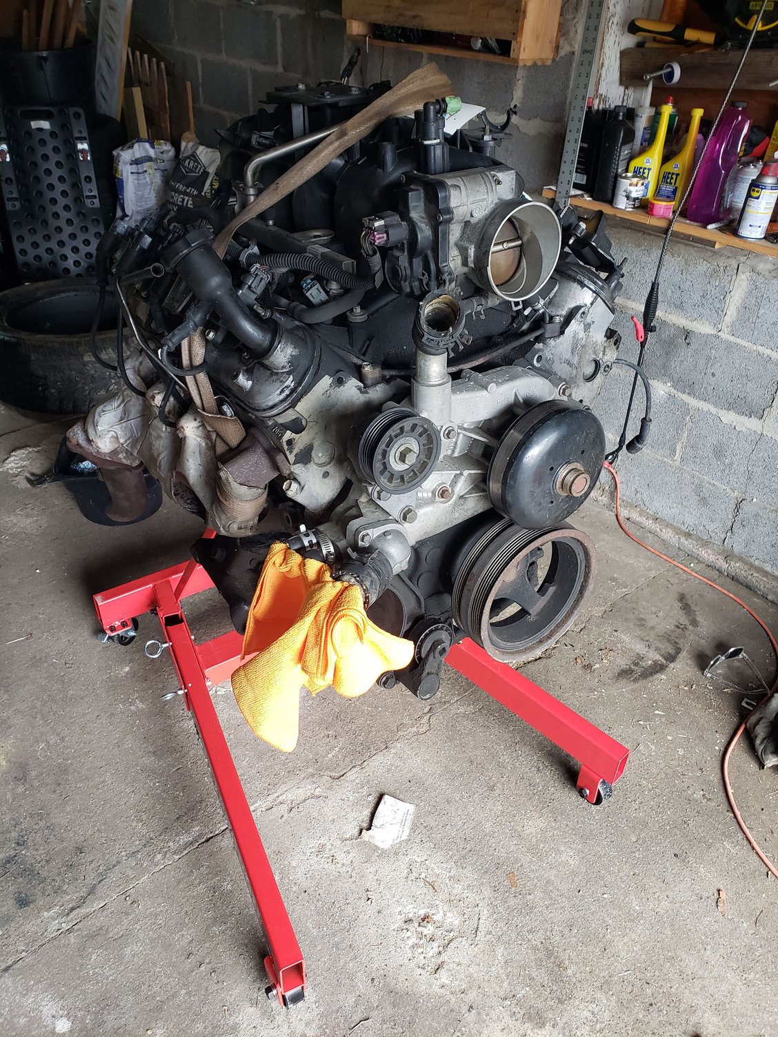

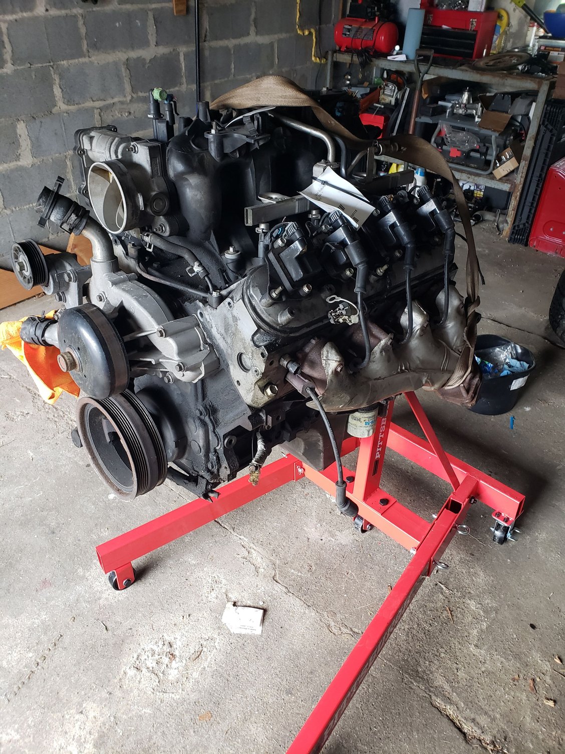

Just an update, I purchased this 5.3 from my local salvage yard. Its out of a 2005 chevy suburban. 8th number of the vin is Z so i am guessing that this is an 5.3 L59? I will post more photos when I start stripping it down. I will most certainly need some advice and guidance from all of you, Thank you in advance.
Old Aug 17, 2024 | 05:21 PM
TrendSetter's Avatar
Joined: Dec 2004
Posts: 2,177
Likes: 627
From: Florida
For your goals I’d open it up as little as possible. Leave the heads on, you can swap cams by flipping it upside down on the stand to keep the lifters up.
these motors really don’t need much, camshaft, pac1218 springs, good fuel supply, injectors and boost. Stock oil pump with a washer added to the bypass spring. Don’t over complicate it.
