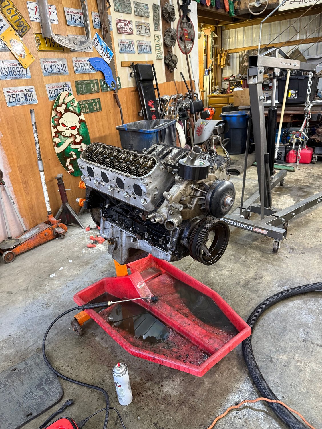

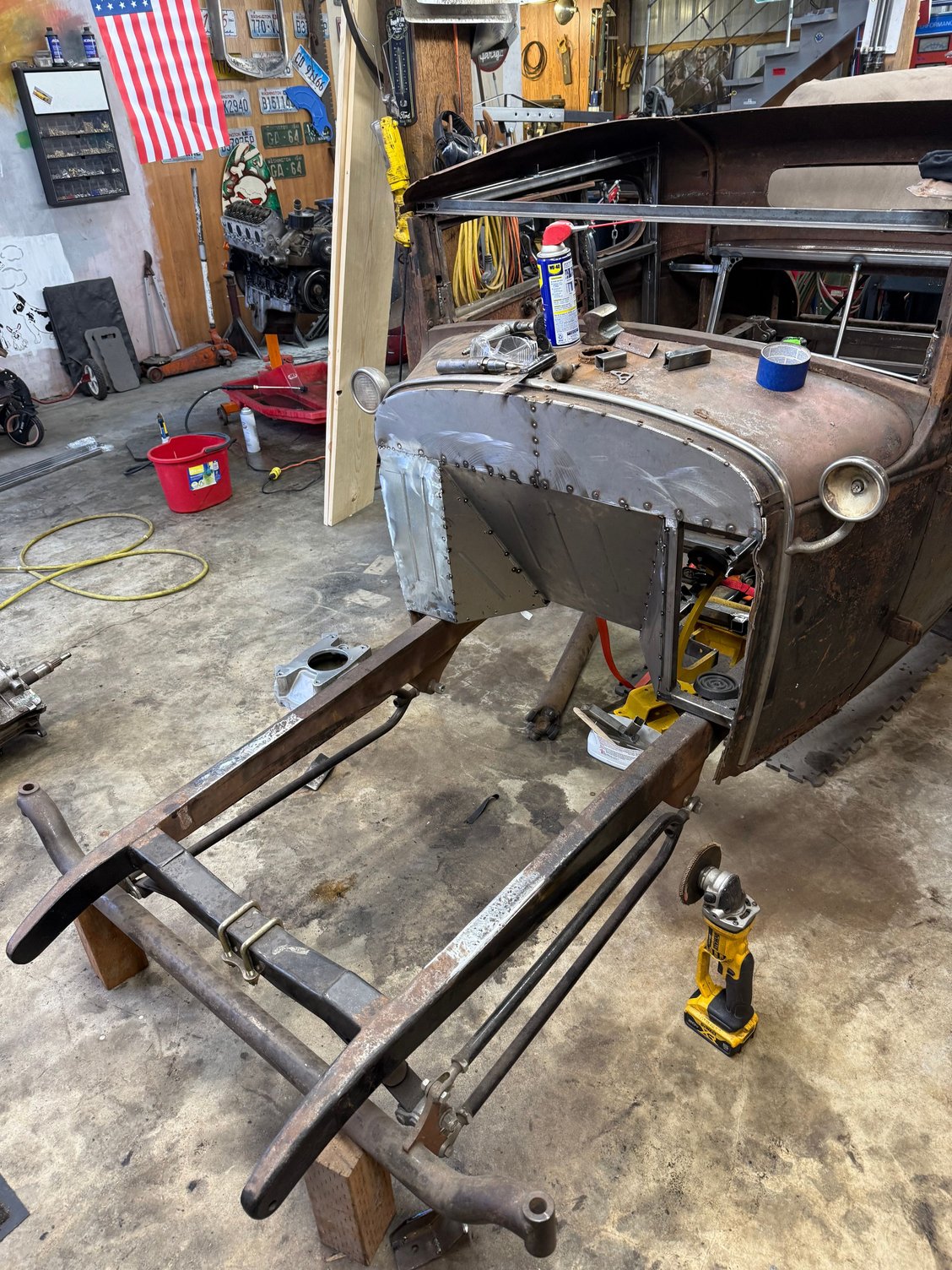

Hello! I'm putting a 200 4.8 into my 1930 Model A coupe with an S10 T5 (14 spline). I know...weak trans but that is what I have! Any pointers on a clutch/flywheel?? I ordered a bellhousing already (#3899621) as I read on here that is the one I need. Getting lost on clutch/pressure plate and flywheel. Any ideas?

Just curious, do you have the input shaft specs compared to a muncie/T10? Also isb the trans/bell bolt pattern the standard GM muncie?

I would contact the folks at Novak Adapters or Advance Adapters to see how they can help.
If you have the coin my first 98 Wrangler 5.3 swap I used a AX15 from a 6 cylinder Wrangler. Used swap parts from Novak and it worked perfect.
