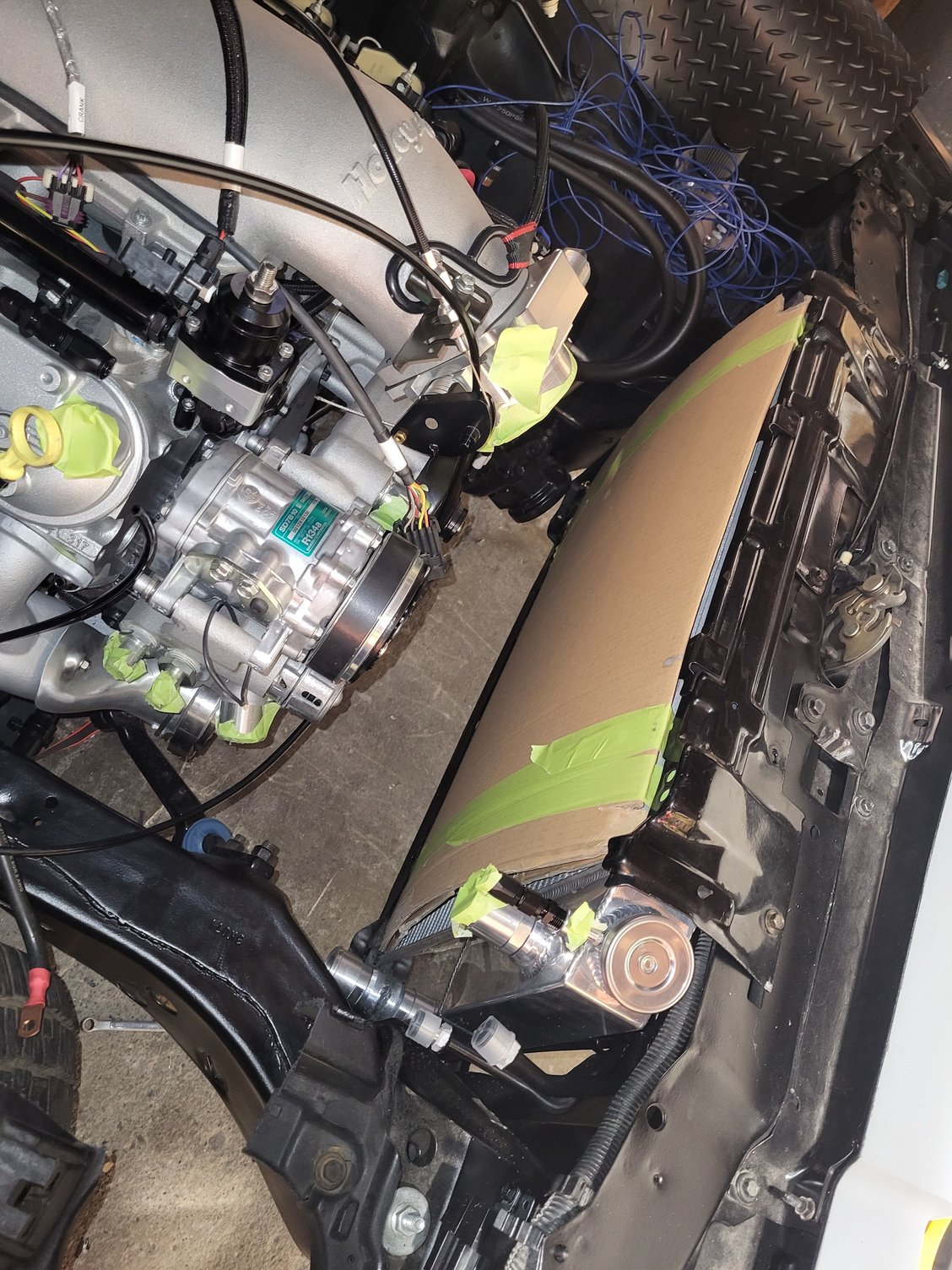

Does anyone have a database for OEM fans that will suit my size. I'm 24x17 and want an OEM fan that would either come from the junkyard or an aftermarket replacement.

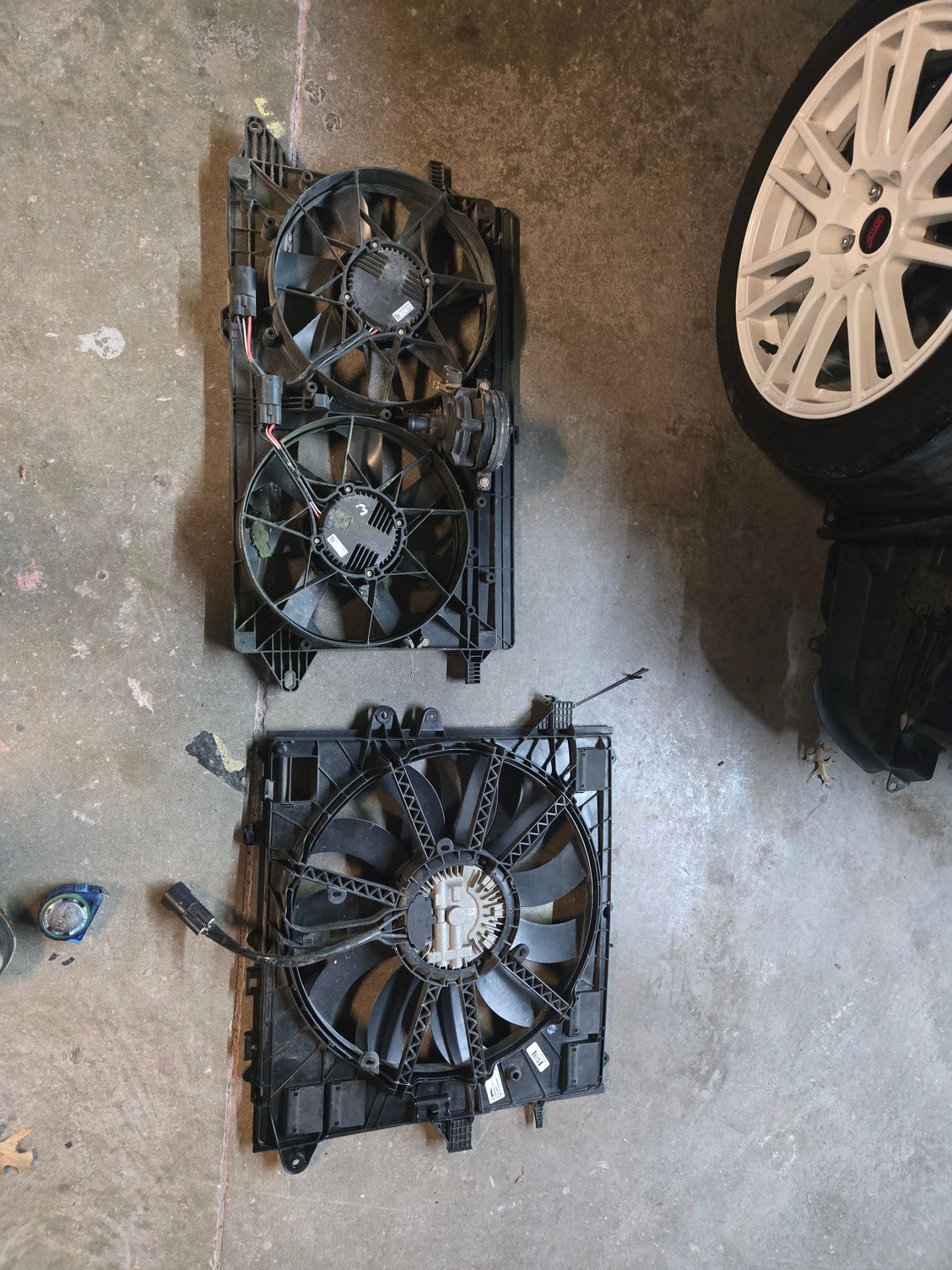

The zl1 fan might fit in there and it's a beast

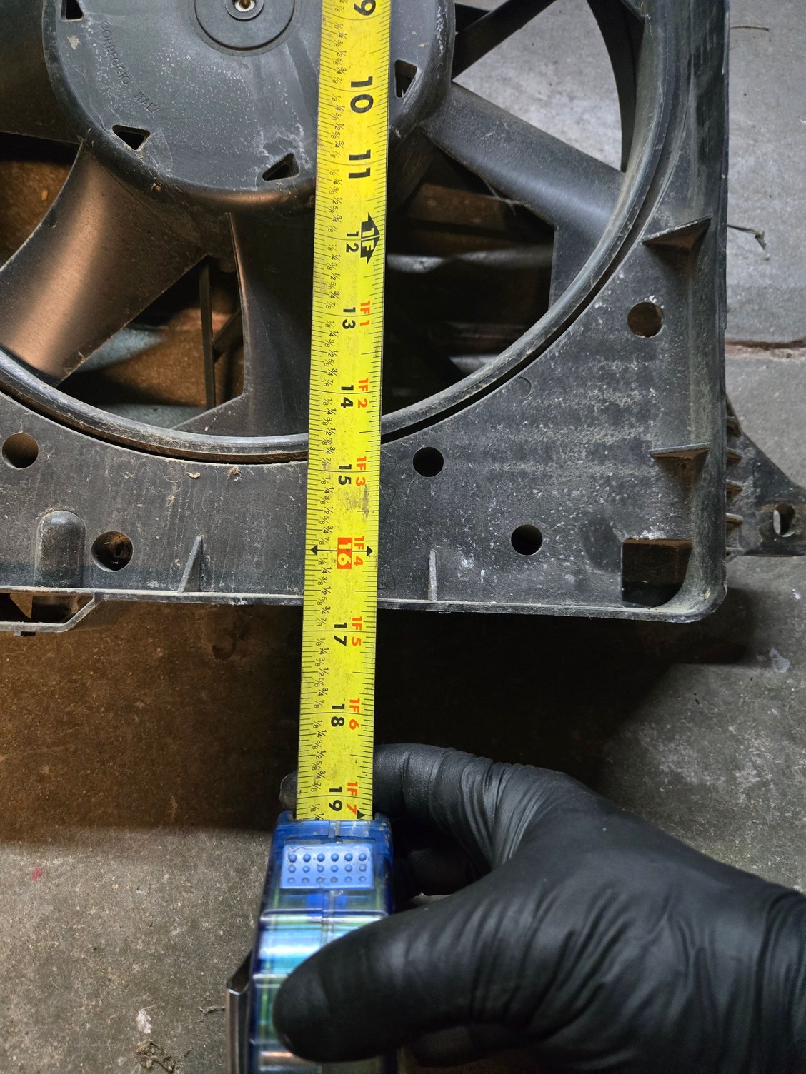

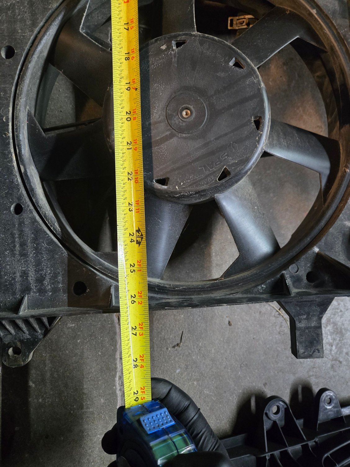

Old Mar 19, 2025 | 10:36 AM
Project GatTagO's Avatar
Joined: Mar 2003
Posts: 10,617
Likes: 1,883
From: Little Austin
The Volt fans are going to be tight. I can measure them later today.
Andrew
Old Mar 19, 2025 | 11:00 AM
Bbknucks's Avatar
Joined: Dec 2022
Posts: 444
Likes: 158
The zl1 fan is a little bigger than i thought 22x23...
The volt is 26.5 x 16.75 not including the mounting tabs sticking out
Old Mar 19, 2025 | 11:05 AM
Joined: Mar 2003
Posts: 10,617
Likes: 1,883
From: Little Austin
This link has some extra information:
https://forums.holley.com/forum/holl...hless-pwm-fans
