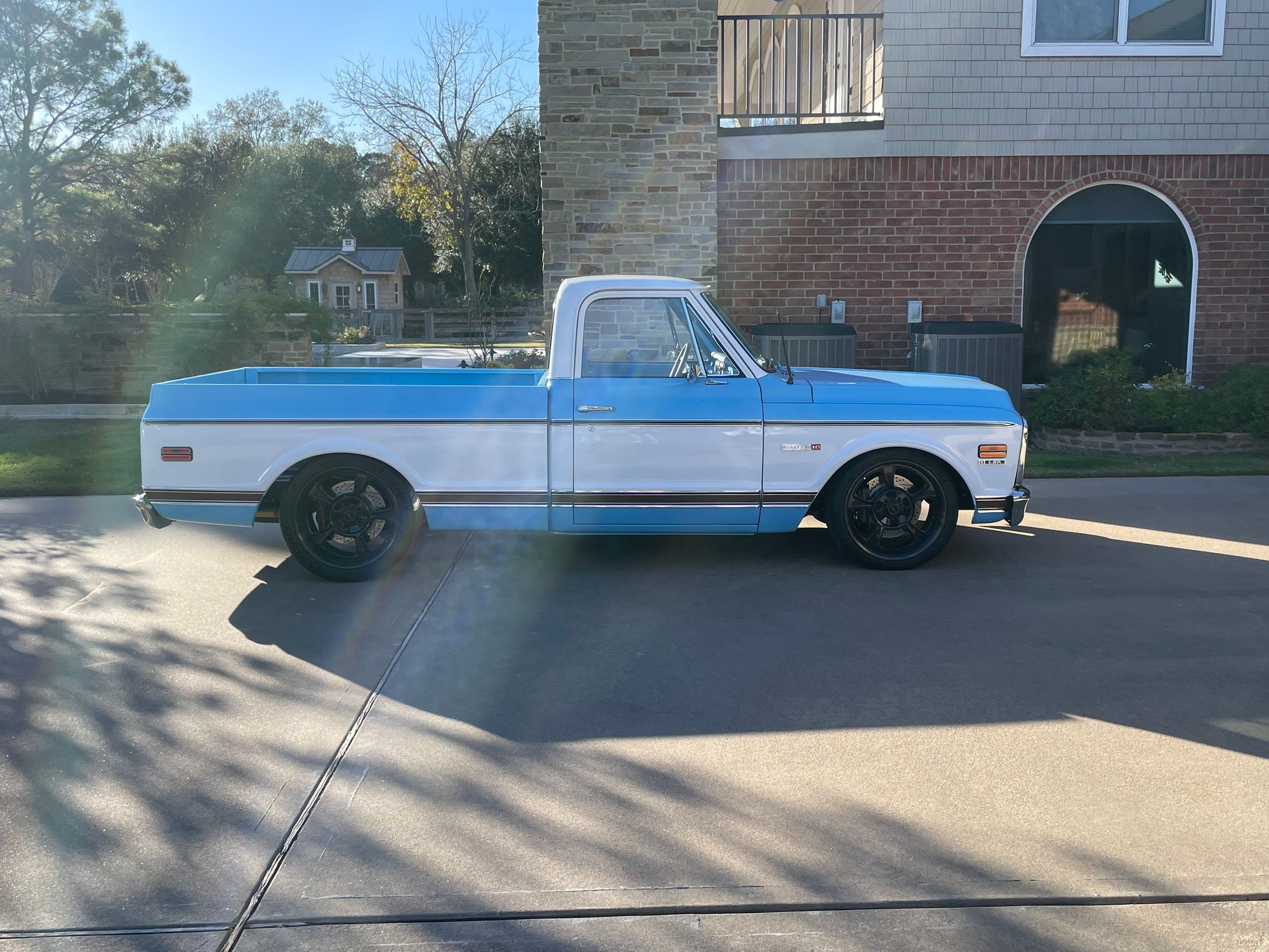

LSA swap in a 72 C-10. Running a Holley Dominator. Has a loss of power type miss that happens randomly in the 2500-3000 range. Has some popping on deceleration. Runs strong when getting on it, but I can’t figure out this random miss. What I’ve done so far: found that one of the coil harness grounds was loose on the back of the head. Tightened it up and things were better for awhile. Swapped coils around because #6 seems about 100 degrees cooler with a laser gun. No change in temp. Bought a noid tester and confirmed that the injectors are getting pulse. Had the injectors flow matched by Mr. Injector. Put all new plugs in. Still has the miss. Does this sound like a tune issue? Anything else that I should look at? Losing my mind over here.
