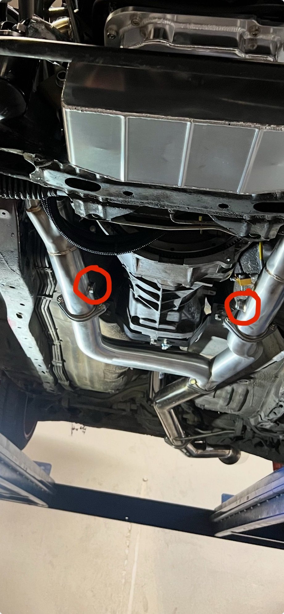

I’m running ISR headers on my s13, they came with a bung already in place. They’re at further back end of them. Right before the flange where you connect your y-pipe. (Assuming you’re running single side exhaust all the way out the back)
O2 sensors good idea to use. Catalytic converter depends on where you live and what you’re going to do with the car.

I appreciate your response! I do plan to go with single exhaust, for now as the current goal is to get the car running. Your picture helps, I just wasn’t sure if I’m supposed to have the bung on the headers or after the flange. Regarding the cats, I dont think I need them because in Georgia, cars older than 30 years old don’t need emissions

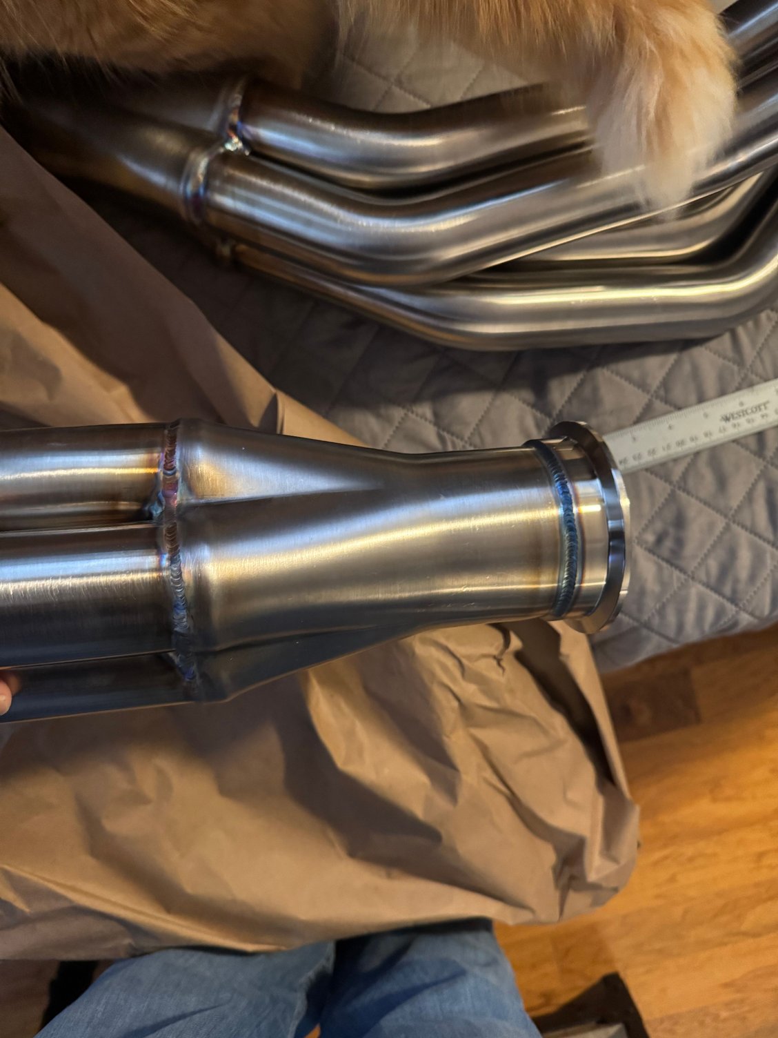

o2 sensors are require for fuel injected setups, without them the air/fuel ratio can't be determined. I think you don't need them if you have a carburetor. I'll post some pictures of the headers later on today.

Ok, I checked both of my headers, and they do not have the bung hole for the o2 sensor. Also, I don't think there is enough room to add the bung hole, see video, because it needs to be about 6 inches from where the pipes merge/collect. I would appreciate any advice on this.
