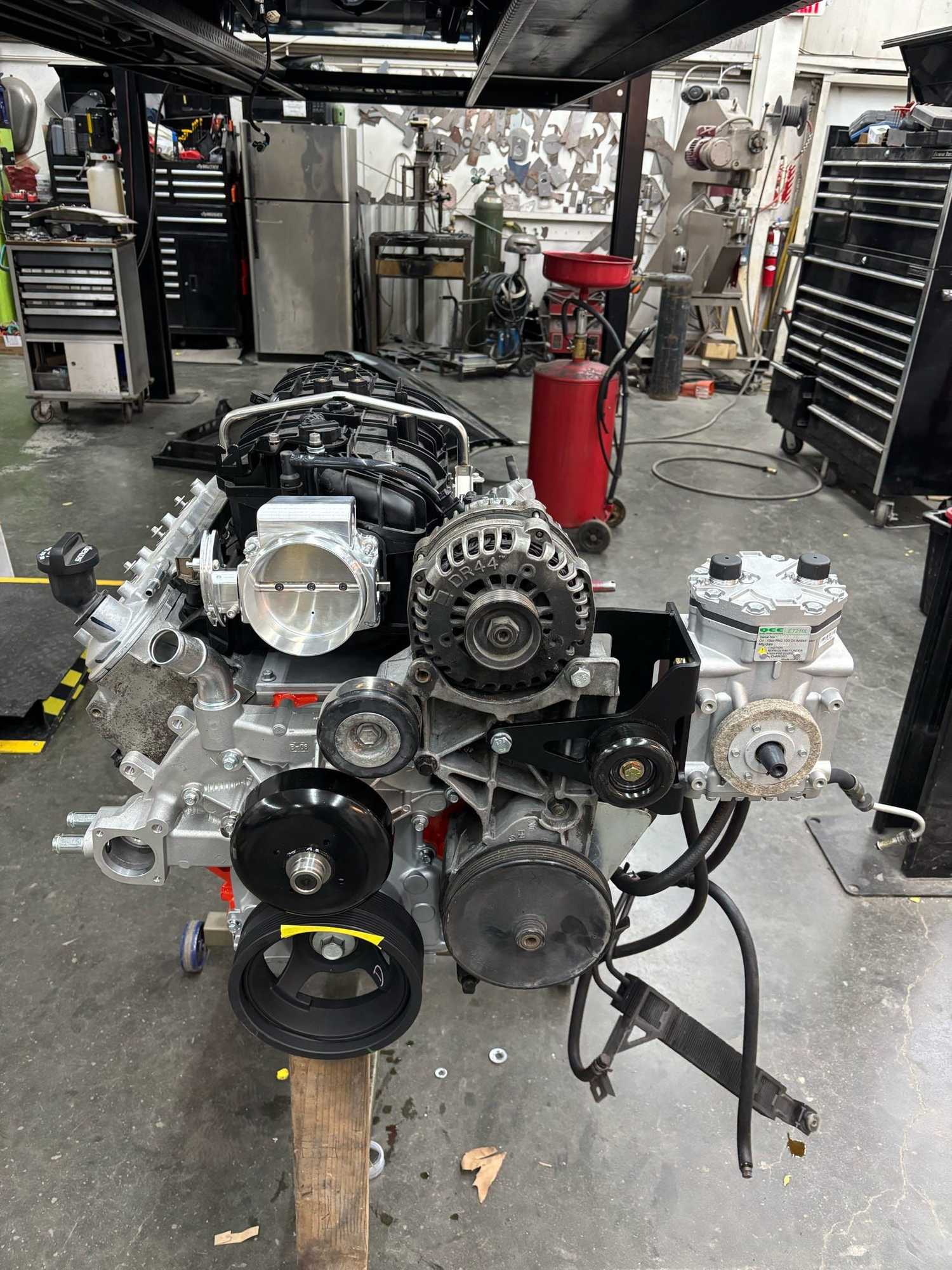

My LS swap bronco is getting ready for the engine to go in. I have a psi wiring harness and computer. Outside of hooking up all the sensors and gauges it’s as simple as starting it? Well and the tune for the camshaft. It’s a gen 3 lq bored .060 and a l92 top end. Cam motion truck cam.
Am I oversimplifying it? My fist LS swap so it’s a bit of uncharted territory.

Wire it up and fire it up! Actually I like to take small steps. First is to get the rear wheels off the ground. Last thing you need is to discover is the gearshift was not quite adjusted right. Prime the engine with oil and fuel. Oil to lube everything and fuel to check for leaks. Fire it up, look and listen. Look at the oil pressure and look for leaks. Listen for sounds that indicate a problem. No leaks, no funky sounds...follow break in procedure.
