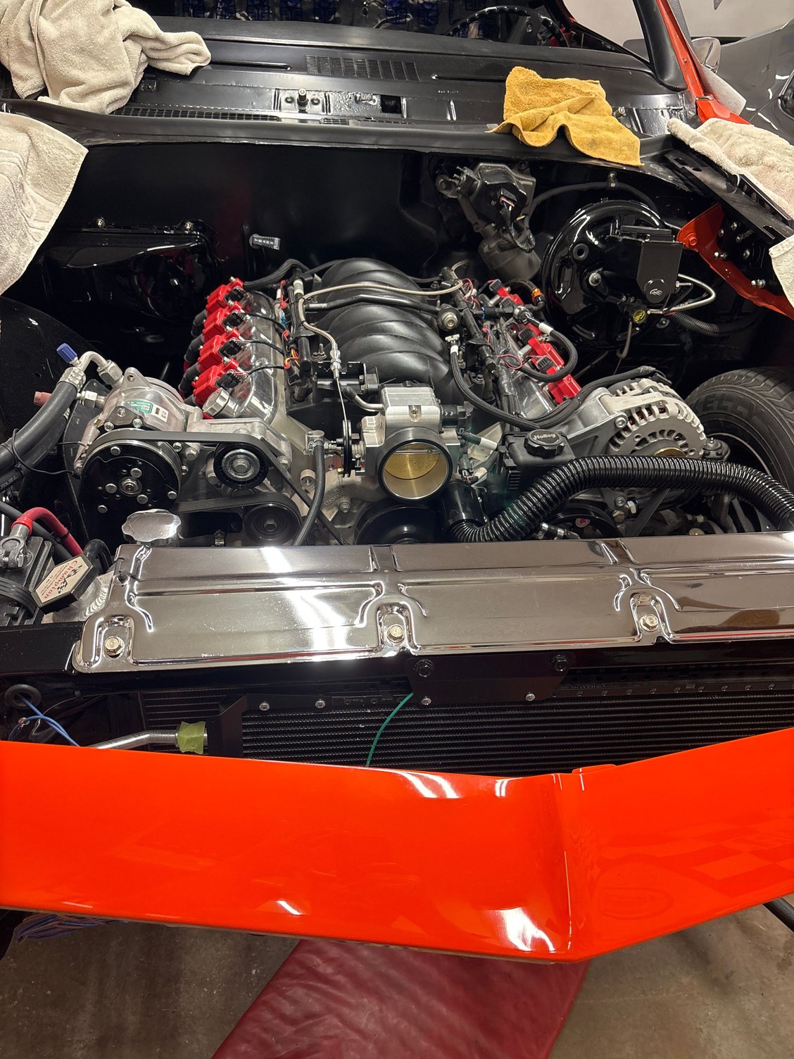

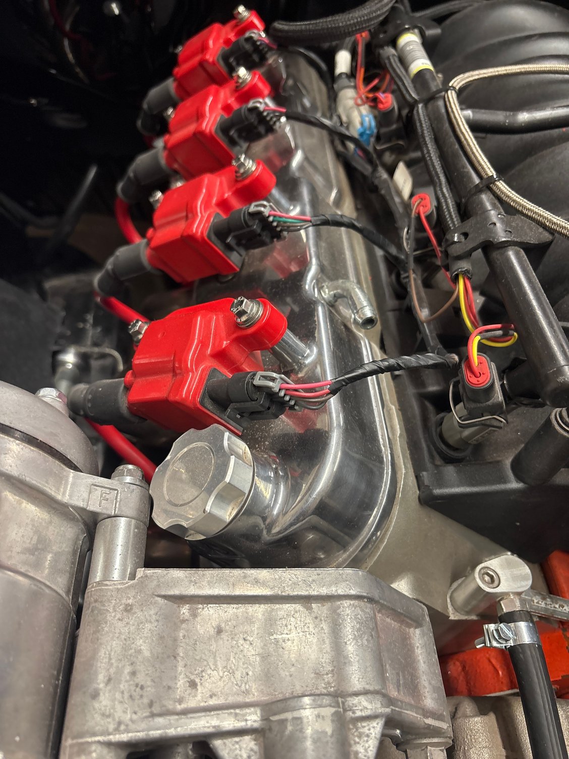

Hi guys, I’m in the process of swapping a 6.0L LS into my 69 Chevelle and the last thing to tackle is the oil catch can/ breather set up.
This is about 500hp n/a motor, that will be street driven. My valve covers both have a barb type fitting on them.. What type of system are you guys running, or what would you suggest?
is a system that hooks up to a vacuum source really necessary for a N/A set up??
TIA for any help with this,
Scott.

I have those same valve covers but I removed the hard lines and drilled and tapped for 3/8 NPT to 10AN male fittings and connected both lines to a breather can. This was for my 01 car and I did dual breather cans on the 99 car. I didn’t want to run PCV and utilize the intake port to pull a vacuum on the crankcase. Nope not for me, only fresh air through the throttle body enters my intake manifold for it's air/fuel mixture. You may be able to get away with standard 3/8" hose off of both valve covers to a breather can but it may be a little restrictive.
Another thing you could do is to leave them as-is and run a sealed catch can and use the intake manifold and throttle body or the air induction tube and run PCV. From the dtiver side valve cover through a sealed catch can and then out of the can through an inline PCV valve just before connecting to the 3/8" port on the intake manifold. For the passenger valve cover run a 3/8" hose from it to either the port on the throttle body or install a port on the bellow or air induction tube in front of the throttle body and connect the 3/8" line to it.

quick question what pulley setup/spacing are you using I'm slowly gathering parts for my 69 Chevelle swap and i like how you have the compressor on top
thank you for the reply, I might be thick, but I’m not sure if I get it yet.. lol
it’s a Holley set up, I’d have to dig out the instructions but I believe it’s their mid mount set up.

It looks to be the corvette style from Holley. It’s the shortest style IIRC
