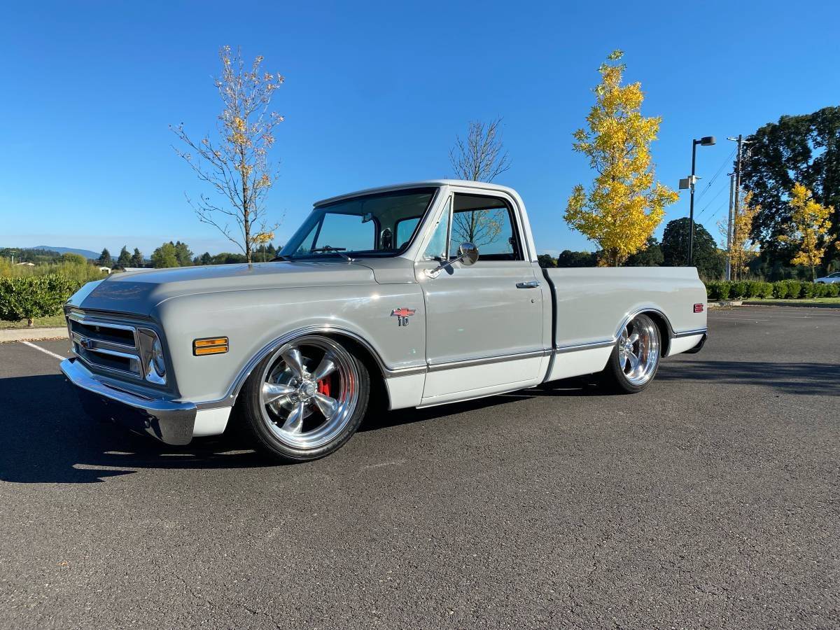

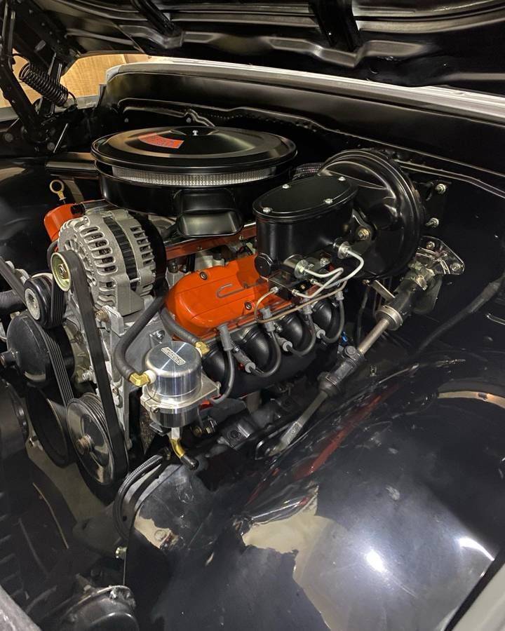

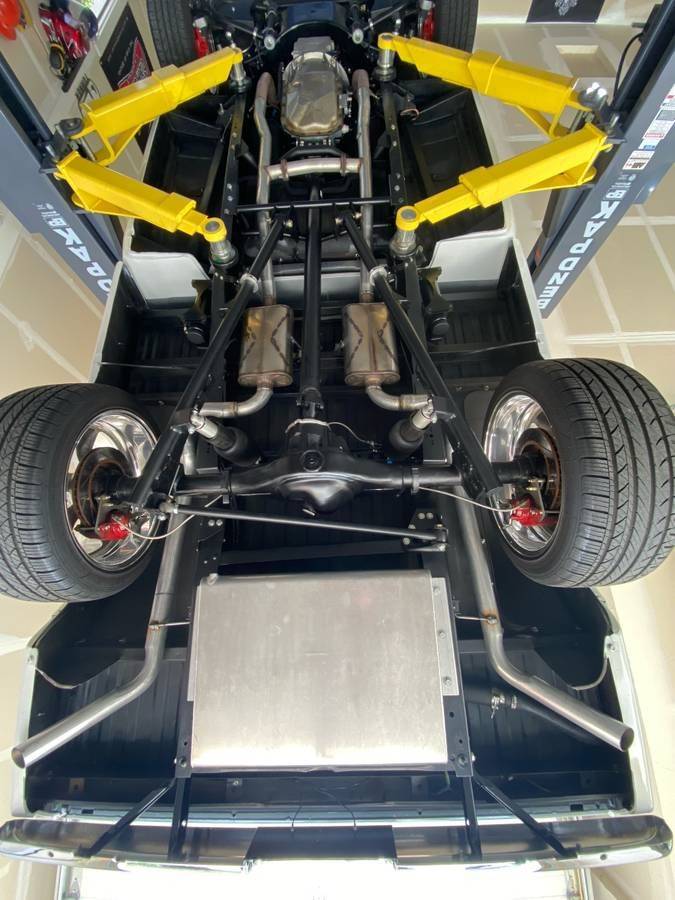

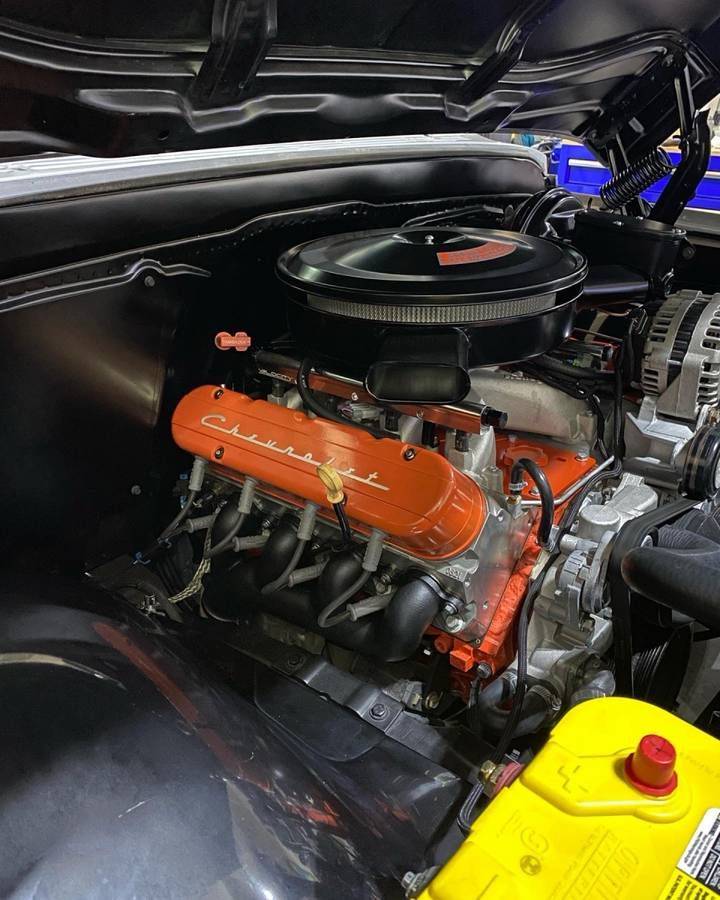

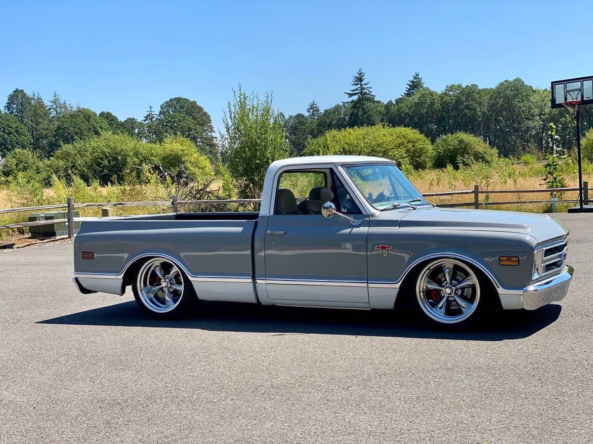

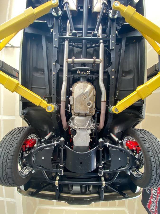

Few pics of the truck attached. It's a beaut! Now I just need it to drive like it has an LS swap...
