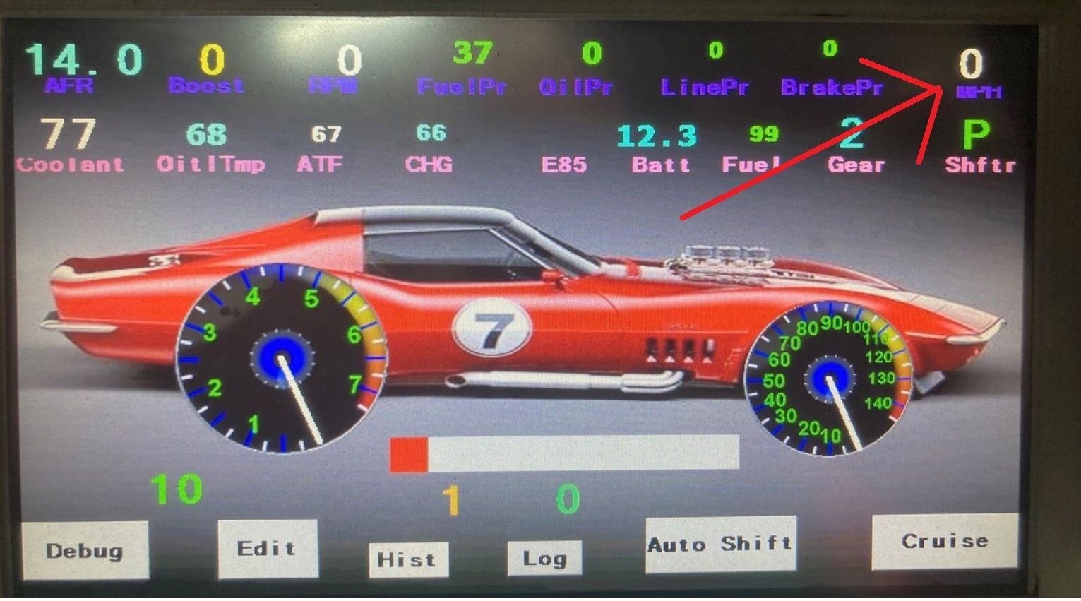

I had the same thing happen, although it was not with a Holley. Bad VSS sensor caused the transmission to downshift.
Lucky my 4l80E controller has an optional touch screen shifting option, so I was able to make it home at reasonable speed by manually shifting from the touch screen.

this is a fresh build, everything is un tested and this is the first bug we have came across. How was your able to come to conclusion it was vss sensor.
My touch screen said I was going 0 miles per hour, even though I was moving.
Swapped in a new sensor and never had an issue again.
BTW, if you get stuck and need to get home in an emergency, you can unplug the 4l80E connector and that should give you second gear.
