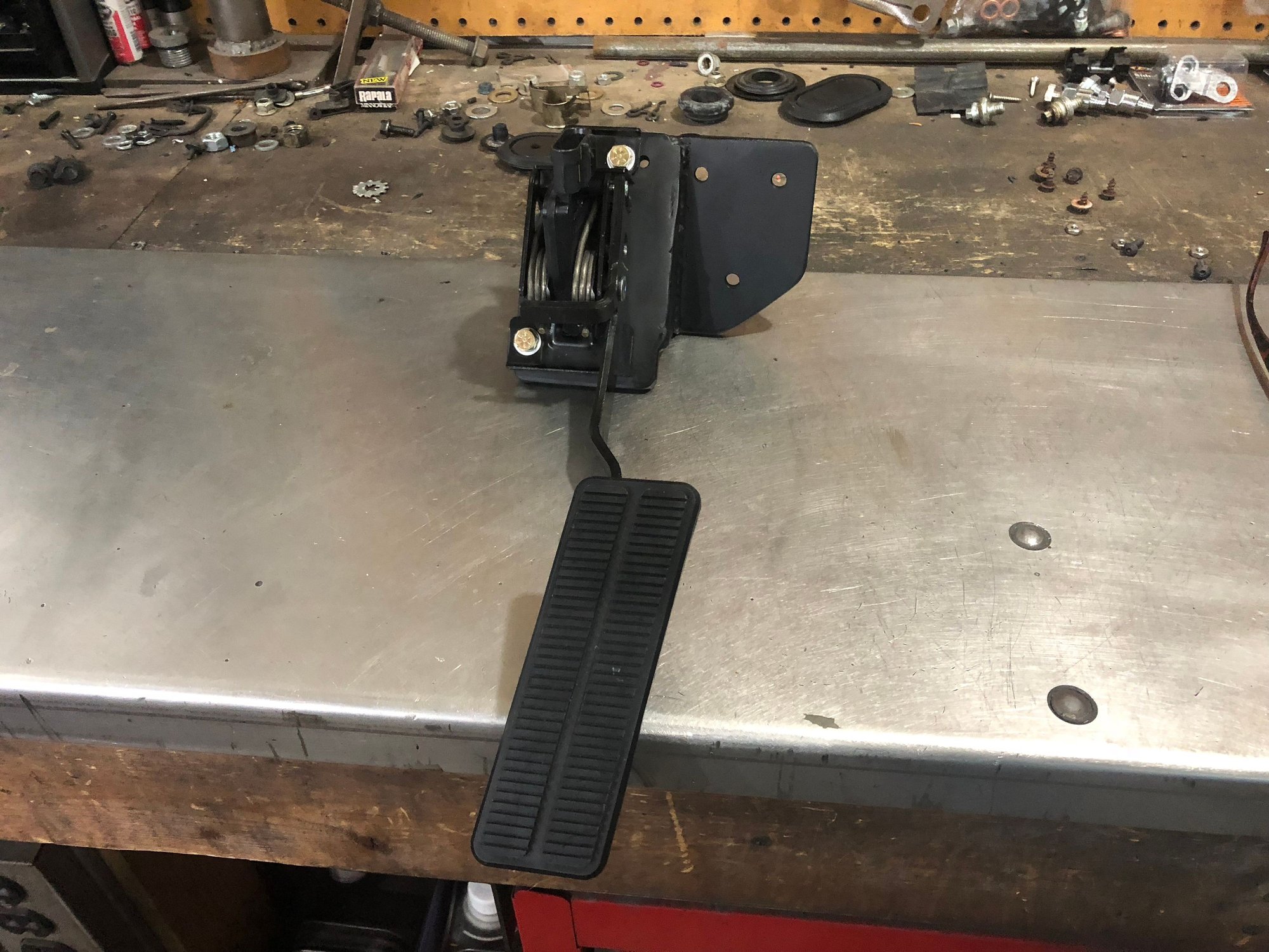

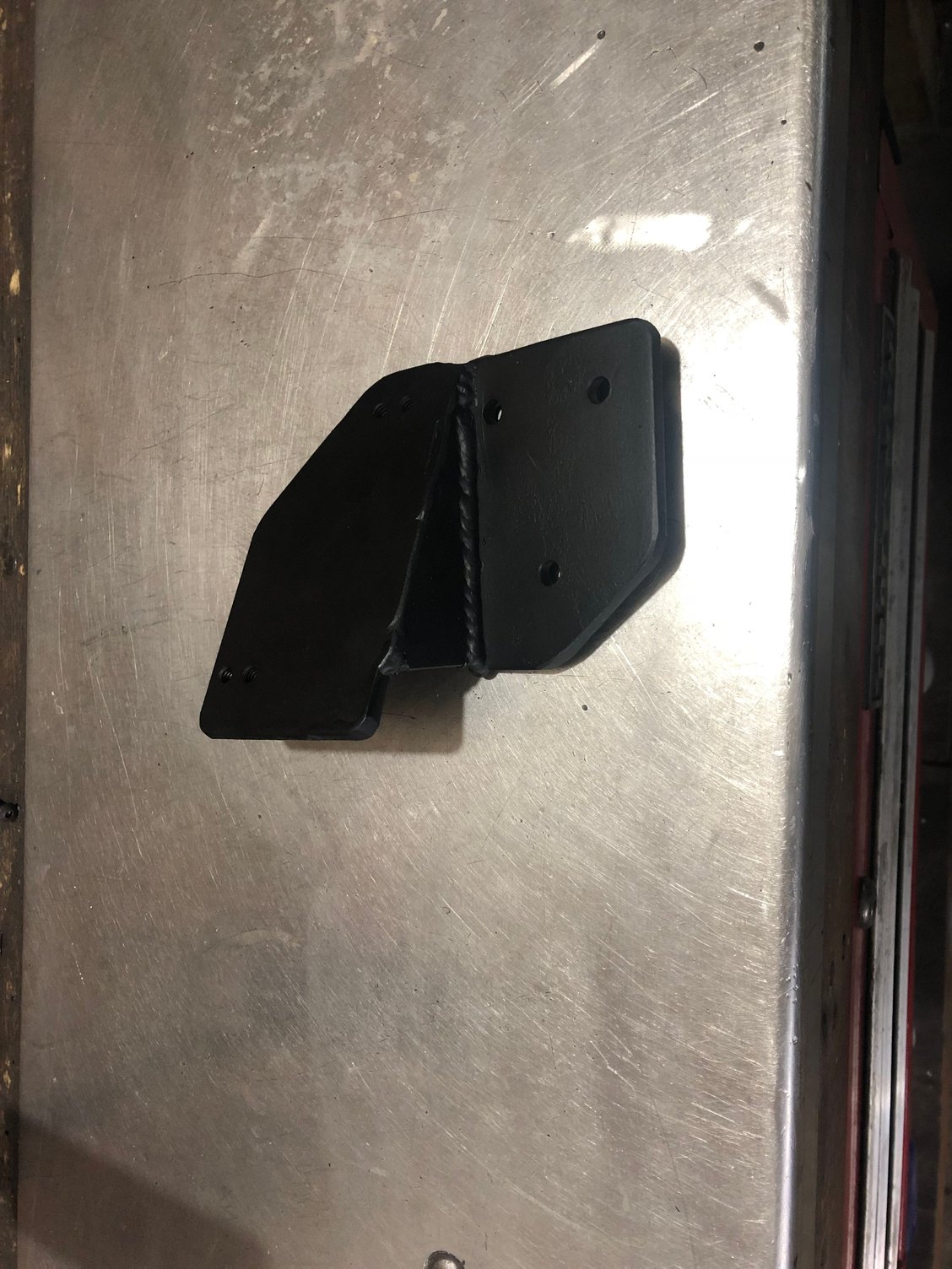

So don't know if this helps. I needed to fab a bracket to bolt in a DBW pedal in my 80 Camaro with a LS3 swap.
Pics.
Pics.
that does help, my firewall bolt pattern is similar. Thanks for sharing
