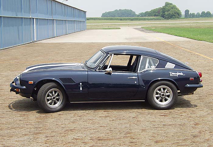

what's a Trimph Gt6?

Here is a pic of a gt6
http://www.triumphspitfire.com/image...GLibertini.jpg
Thanks for the info on the flanges, I'd like to make my own, I am a good welder. I think I'll go with stainless if budget permits, It's nice to not have to worry about coatings or painting. I am not sure if I'll go equal length or not, I'll have to see about routing.
Thanks for all in info everyone, I can't wait to get started on the project.
Feel free to suggest a color for the paint too, it's red now, but the paint is crappy and needs a complete redo.
