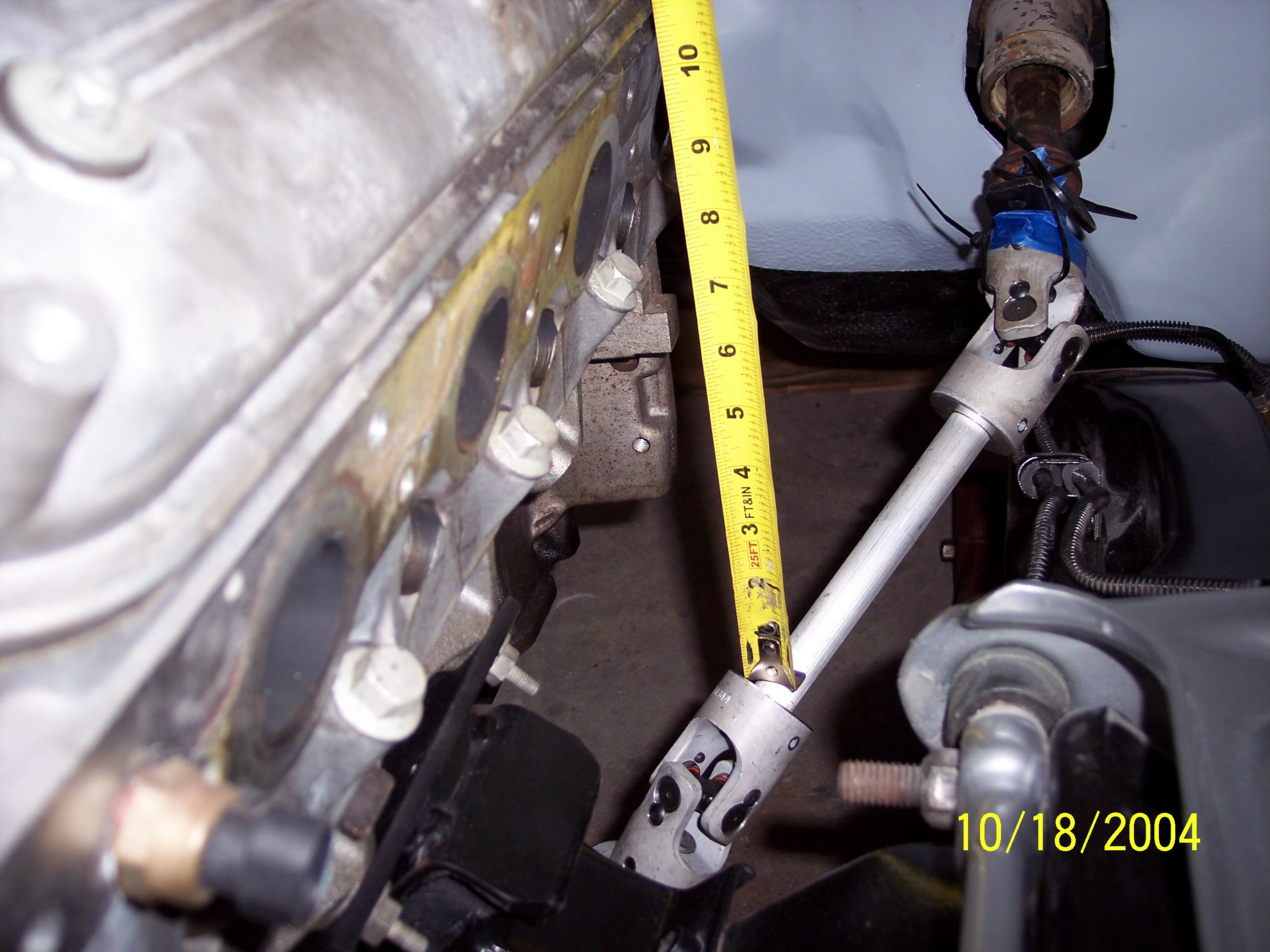

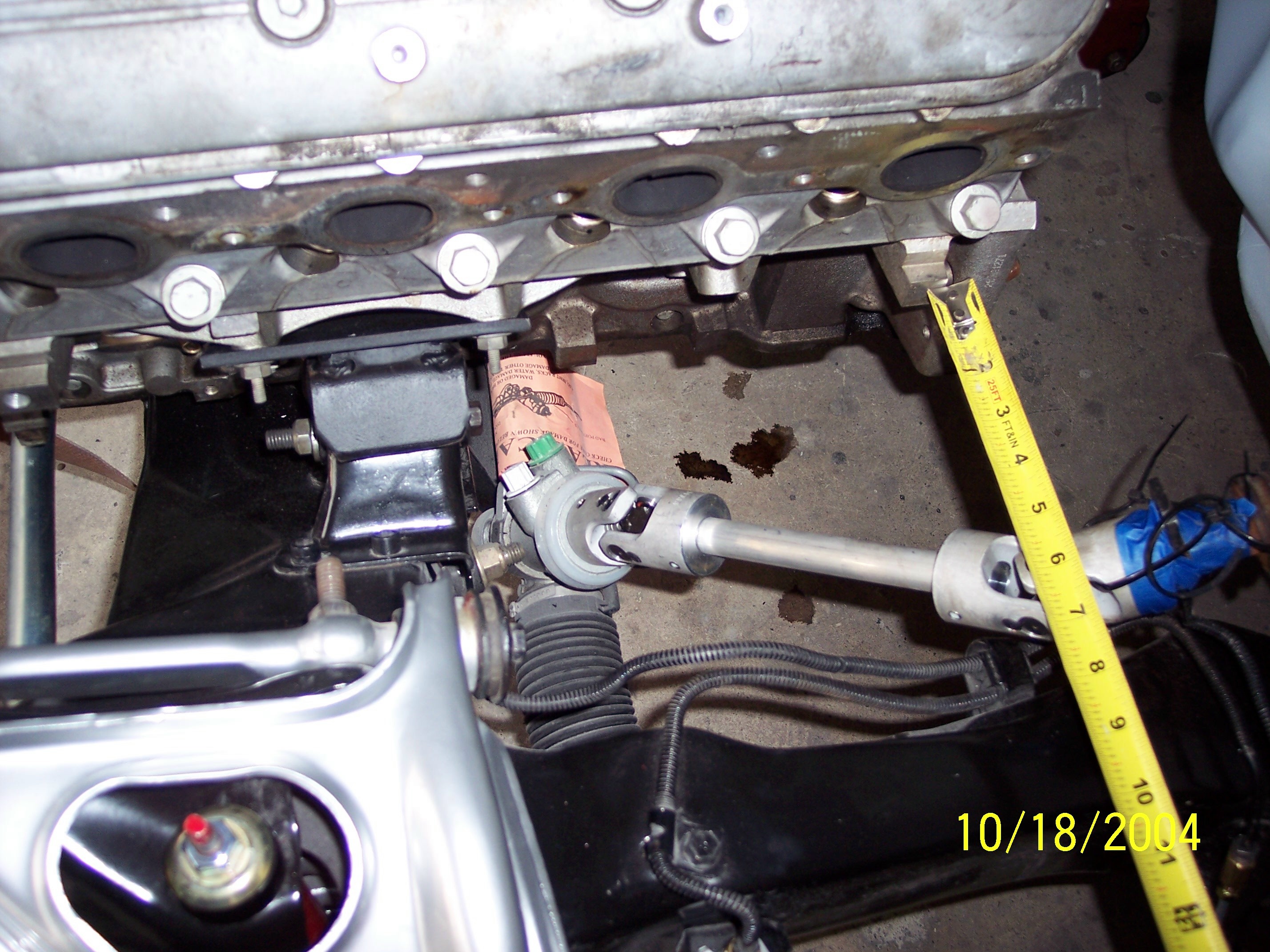

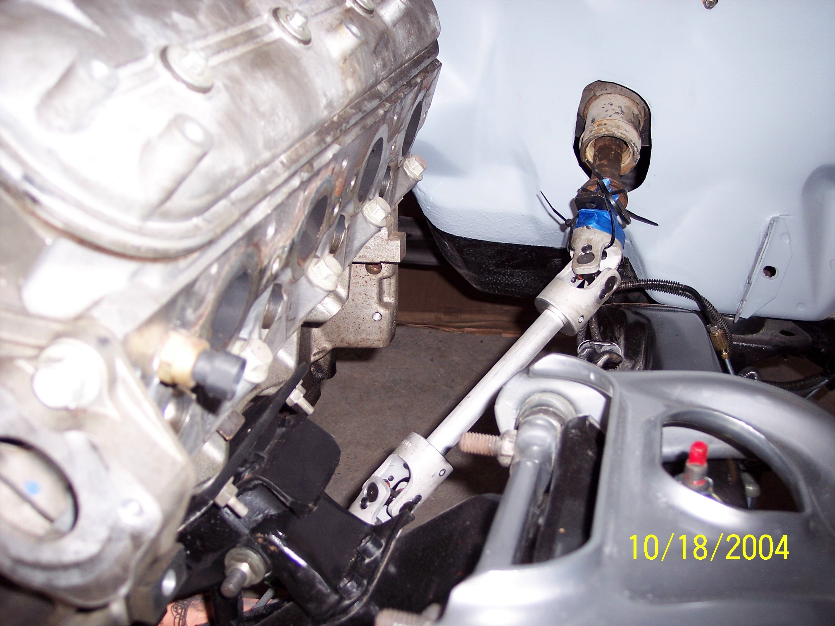

I kind of got the cart before the horse..etc. as this project started out as a LT1 powered car. Anyay, I am now doing an LS1. I am running the BPR motor mounts as I prefer tha ability to run stock accessories etc.
Anyway, I am test fitting. Please see the following pictures.
Is anybody else here running BPR mounts with a Steeroid system on a 1st gen? If so...what headers.
If not, can you tell from these pics if any of the other headers would clear my steering rod?

I have not been able to really get any answers on this. I talked to Steeroids, but they don't know of anybody doing the LS1 and their steering.
S&P and BPR do their own thing, plus $1K for headers from Year one is out of the question........so,
I ordered a set of Pacesetter long tube non-emission, NON coated headers for an 2000 Z28 for $250 from a web based vendor.
I know I will have to cut or change them, but that's okay at that price and they are NOt coated yet. I have a local ceramic coater.
So...let's see........
