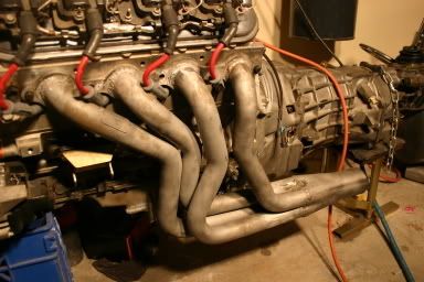

A couple folks in different posts asked about my headers. We finally have a driver's side header that fits. I posted before that I bought a set of Sanderson 1.5" headers as a starting point. The passenger side fit fine, but the #1 pipe hit the steering box on the driver side. I knew they would have to be modified when I bought them, and we thought we would just have to move the one pipe. After several attempts nad getting close after moving that pipe and giving it a pretty good dent, it still did not fit right. So my header fabricator Scott decided that the collector needed to move back a little bit to give some room. This meant modifying all the pipes. He brought his master piece back over this evening for a final check and it fits perfect! He took it back to finish up the internal welds and do some clean up, but I have posted a picture with it in place. It looks a little crude right now, but after finishing up and ceramic coating, it will look and work great. 3rd picture is the passenger side, it fits without modifications. 4th pic is how they looked out of the box. I will post pictures again once I get them back from Sanderson after ceramic coating. This has been a great week on the project, I also finished the trans crossmember and installed my gas tank.

awesome! I wish i had a TIG. be sure to use a 120gr flap wheel on an angle grinder to clean up those welds, they'll disappear. Awesome work, now just need pics of them coated and on the car!

Thanks for the comment and idea on the flap wheel. Actually those welds are Oxy/Acetylene, not TIG. Scott is a pretty talented guy. I am fortunate to have willing friends to help with the stuff I can't do.

WOW. That takes skill. Only things I can do with oxy acetalyne is heat and cut metal, and engrave my name in lava on any unfortunate rock I come across when I'm in the pyro mood and holding a torch. The flap wheel works great, I have 1 or 2 cuts in each of these tubes, I used a crappy flux-cored Mig, and they came out beautifully. I'd never used one before, but I must say i'm extremely impressed. Before i'd only used grinding wheels, and they kinda whack away material, flap discs just smooth it out.

Those look great Olly! I'd like to see them in the car too. We will go after mine with the flap wheel once Scott finishes up the welding on the inside.
