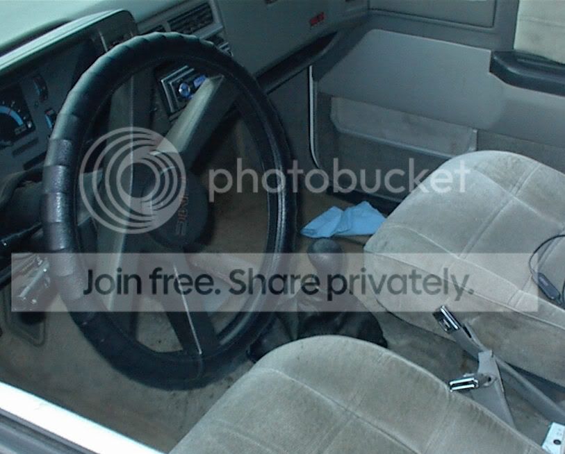

shifter from drivers point of view
shift ****
shifter from the pass side

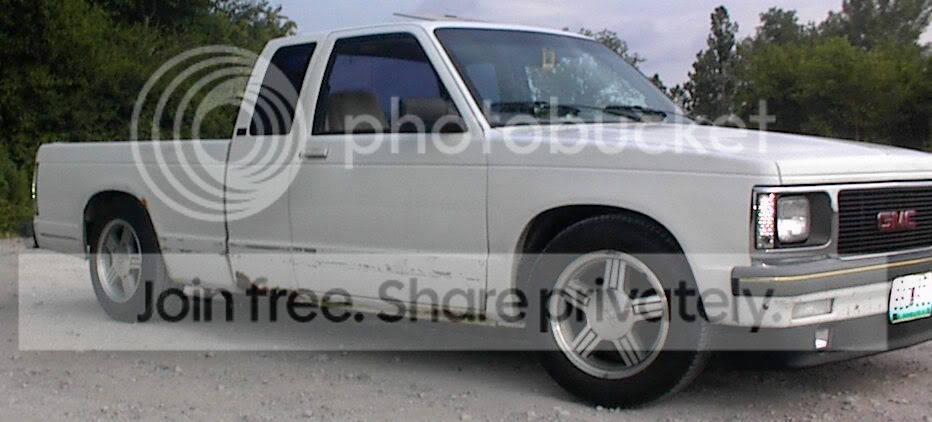

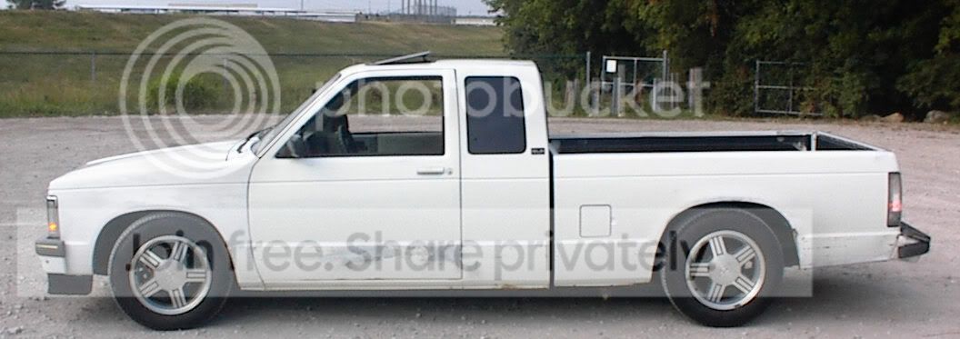

yes its t56'ed no you cant drive it
new wheels
