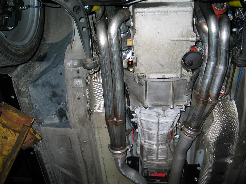

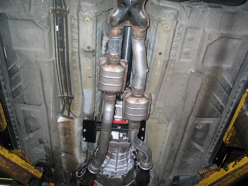

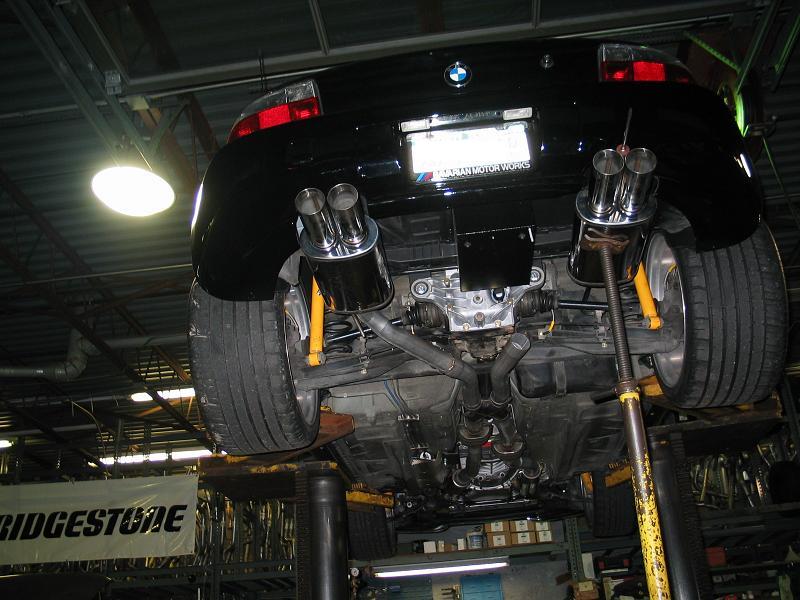

Drove her for the 1st time yesterday...1 mi up to the muffler shop with open headers and 1mi back with 2.5" Magnaflow setup

did you use the 4cyl rear or did you get an "M"rear? did you reinforce the rear diff. and mounts I have heard of some of the "M" roadsters that get driven hard will rip the mounts off the body. looks like it should be fun, nice job

Joe that conversion looks really slick. Those are CCW rims? What size tires/front back and rim size? Looks like lots of tire out back for sure.
Did you make the kit including the headers.... or did you use the Vorschlag kit?
Does the steering rack remain in the stock location? Any bump steer issues?
I'm curious about what rear diff you are running and gear ratio.

Hi Guys-
I'll take a crack at some of the ?'s I'll jump around a bit but hopefully not miss any
- Car originally had a 1.9l 4cy
- I upgraded to early 6cyl body panels (rockers, rear fenders, rear bumper cover, and M front bumper cover)
- I upgraded to 6cyl (larger case) diff
- I used Randy Forbes rear end reinforcement kit
- Battery is moved to the back
- The kit completely reinforces the trunk floor and is made for a dual mount diff (vs single ear stock mount)
- To use this kit I needed to use an e36 M3 rear diff cover with the e30 diff
- Gear ratio is 3.73:1
- I also upgraded to IE urethane subframe bushings (and IE motor mount bushings)
- Headers are from Nash Motorsports
- Motor sits TIGHT to the firewall with most of the motor behind strut towers
- Stock steering linkage is left in place
- Wheels are CCW Classic (street model)
- 18x8.5" front with 245/40 (need 245/35 or 235/40 for better fit though)
- 18x10.5" rear with 295/30
- Brakes are 4 piston Wilwood's with e46 M3 rotors (12.9")
- Mustang hydroboost mc
- Stock BMW clutch mc
- Centerforce dual friction 12" clutch
- LS6 intake
- GM Hot Cam
- LS6 valvesprings
- LS6 valley cover and PCV mod
- SLP hardened pushrods
- ASP crank pulley
- Speartech harness
- Aeromotive FPR
- Magnaflow mufflers (and x-pipe)
I believe I've answered all the ?'s but let me know ifyou've got any others.
