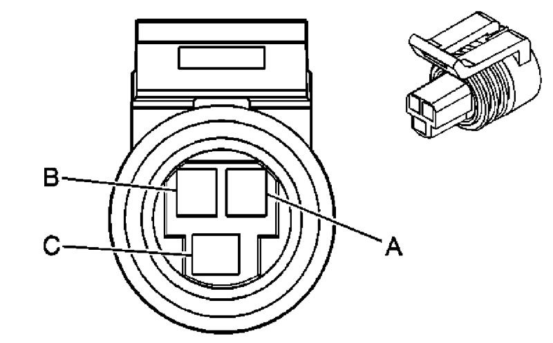

It seems to have originally been around the rear passenger side of the manifold, but no clue where. Click the picture for a seriously blown-up view:
It has three wires:
Red/Blk
Purple
Grey
I looked through my Haynes manual and can't find the little bastard anywhere. Have no clue what it is supposed to go to. Anyone recognize it?

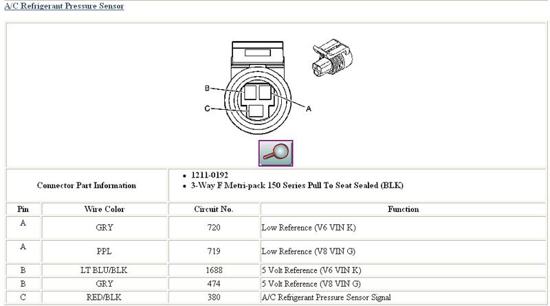

This may help:
