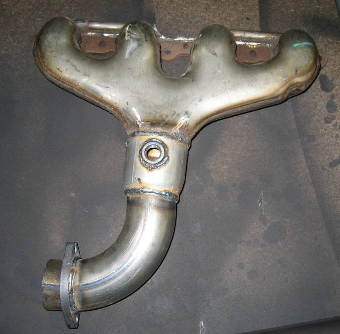

I cut up some pressed steel Corvette manifolds to make the under body system that's on it at the moment. Much easier than building another set of headers and it'll probably just be on to get through enginnering and rego.
Cheers
Michael
