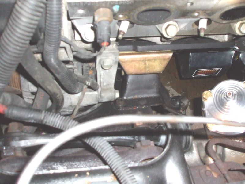

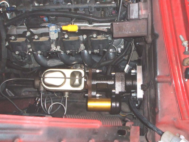

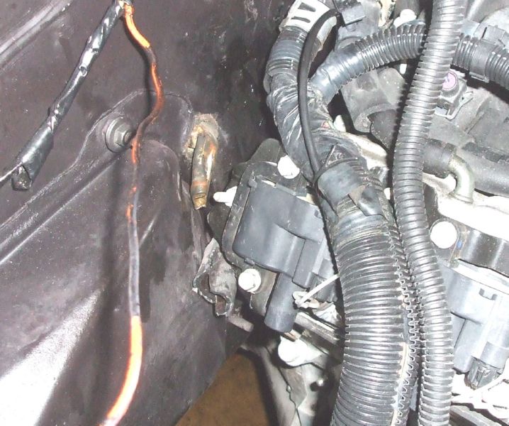

I started with Hooker plates, didn't like the lack of clearance, and switched to ATS style plates.
Here's an example of the Hooker clearance:
There's also an issue with Fbody alternator bracket clearance with the Hooker plates:
Here's an example of ATS clearance:
