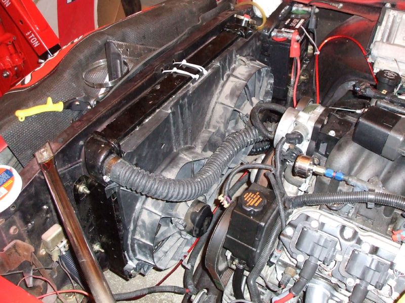

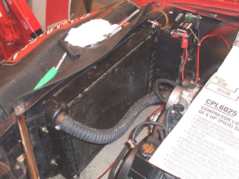

i got a 67-69 camaro US radiator from classic industries long ago. it has brackets welded to the top and bottom already for fan mounting. not really a cheap radiator, its listed for $519, i honestly dont remember paying that years ago.
i went to lowes and got some aluminum angle and drilled some holes in my f body fans. im just going to have the outlets and inlets changed. here are some pics.
