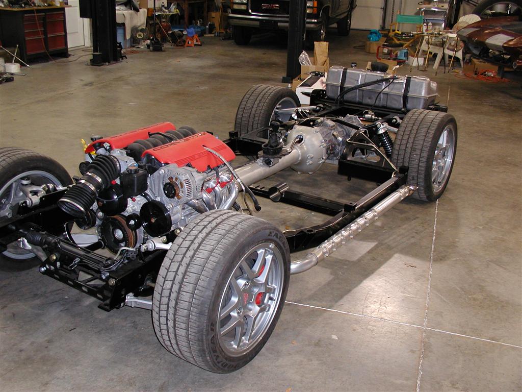

New to site, but have been lurking for a while.
Saw the 66 GTO L92 / 6L80E Street Project thread and problem they had with the 6L80E 6 speed transmission an thought sharing my project problems as project moves along may be of benefit to at least those that might want to use the 6L80E in their mid year Vette. Where the 66 GTO project using the 6 speed auto was abandoned due to time constraints, I have to keep going, but some of you might not want to order one just yet....LOL
Haven't even got the chassis and all ready fighting first problem with one.
[IMG]
[/IMG]
[IMG]
[/IMG]
[IMG]
[/IMG]
[IMG]
[/IMG]
[IMG]
[/IMG]
![](http://i258.photobucket.com/albums/hh276/jere-64/Trans%20crossmemeber%20and%20shifter/P2130021Small.jpg)
When I ordered my Resto-Mod frame, engine and trans from Street Shop Inc for my 66 Corvette back last October, I had two goals in mind, one was not to have side pipes but 3.0" exhaust out the back and GM's new six speed auto.
Knew going in there were only a few cars/trucks that had been converted from 3 or 4 speed automatics or manual transmissions to a 6 speed auto and all would have their on conversion problems that would be different form installing one in a Mid-Year Vette.
Got a call from Street Shop telling me I had a problem with the transmission and exhaust, reguardless if I use 2.0", 2.5" or my 3.0" and I might want to reconsider using Side Exhaust instead of out the back exhaust and for that matter, consider not using the 6 speed auto, but 4L60E automatic instead of it my 2nd frame package.
As you can see from the pictures the pan on this trans extends farther back than other GM autos so there is not enough room to get exhaust pipe thru even a 4.0" opening. While pan is 2 inches narrower than the 4L60E trans in the pan area and that helps fitment issue caused by wider pan, pan depth is about 1 3/4 inches deeper than the 60E's and extends back farther. Pan may hang below the frame making speed bumps, etc threats to take out the pan if one is not real careful.
What I'm also afraid of is due to the 6L80 not sloping down as much as the 4L60 right at the bellhousing, the trans will hit the tunnel at the fire wall using an LS engine as it does not have the 2.0" of space between back of engine and bellhousing like older style engines do. That probably would not be that much of a problem to deal with as if it hit tunnel where the mount is. Any modification to the firewall would not be seen. Moving the engine forward 1 1/2 inches using Street & Performance adapter plates is a possible option solution for that problem, if the adapter plates don't have a fitment issue with low mounted A/C compressor.
Because I refuse to use side exhaust due to noise level of them, friend an I drove over to Street Shop Inc and spent about 2 hours last week seeing what could be done to get exhaust out the back. Tried moving the engine forward 1 1/2 but still not enough room to get 3.0 inch exhaust pipe by trans and thur the opening in crossmember, but that still may need to be done if where the bellhousing and trans meet, it hits the tunnel at firewall with engine mounted in stock location (Believe this was part of the GTO's problem).
We decided that the only way and best way to deal with problem to maintain max exhaust to ground clearance, was to have Street Shop make a new crossmember and move the openings for the 3.0" exhaust outboard of their stock locations so exhaust will not have to be bent like standard Mid Year exhaust to fit through the openings.
In order to do this and not have interference problem with the floorpan, top of the pipe used for exhaust openings has to be dropped down and welded in flush with top of cross member so they clear the floorpan. This will put the bottom of the openings at about the same depth as the bottom of the transmission's pan, and with it's more mid car location make it more of a threat to hit/hang speed bumps than trans pan. Looks like I may need to start thinking about making and fitting a skid plate to protect the Transmission's pan too.
As soon as I get the chassis, I'll let y'all know if there is a fitment issue at firewall. At this time, I don't believe there will be and issue with the trans hittting the top or sides of the tunnel even at the back where the tunnel is the narrowest. Only time will tell if I guessed right on that.
Should have the chassis in hand 1st of April to sit the body on to see if there will be any trans to body interference problems that will require the thunnel to be modified to accept the trans.
Jere

This much I can tell you and give you a couple of pictures to look at as reference.
The C/L of the tailshaft it'self is approximatly the same as that of a 4L60E from the mounting surface to it. The bottom of the pan is about 1.75" to 2.0" inches lower than the engines bellhousing, so it may be lower than bottom of the Vetted frame rails, how much if any, I don't know at this time.
What I do know is the bottom of the 4.5" pipe used to run the 3.0" exhaust thru will be approximatly 4.75" from bottom of floor pan to bottom of opening for exhaust pipe. Same openings that are in the stock crossmember are only 3.5" below the bottom of the floor pan and stock exhaust does not hang below frame rails.
Now those measurements were assuming the bottom of the floor pan has at least .250" clearance between it and transmission crossmember and that Street shops transmission crossmember is in stock location and not rasied or lowered. That pan is sitting somewhere from just inside frame rails or as much as 1 3/4 inches
![Barf](https://ls1tech.com/forums/images/smilies/LS1Tech/gr_barf.gif)
Had no way to measure actual pan to road clearance as there were no wheels to rest the chassic on and I forgot to get down and look to see how much below the frame rails pan might be.
That's why I mentioned I might have to make a skidplate to protect pan and will have to keep the car at stock ride height.

I've alway known I might have to modify the vette's tunnel to get it to fit. Budgeted for that, but if it get's too complicated I will backtrack to a 4Lxx transmission.
I have a second frame that hasn't gone into work yet that I haven't ordered a trans for, but plan for it is LS3 480HP crate egine with the 6L80E trans too. Got the engine in for it last week. Want place trans order until I know just how much of a problem this one is going to be.
Jere

One thought on gaining more clearance for the exhaust under the floor-pan would be to use an oval shaped pipe in those close areas. There is a company called Dr. Gas, who makes most of the NASCAR exhaust pipes, who can ovalize up to a 4" pipe.
Best of luck with the project.

I used one of Tray's frame set up in my 65 Vette. LS1w/4L60E. I had plenty of clearnce at the firewall. Every thing fit like a glove. I am running side pipes.
Having him move the openings in the crossmember farther out should take care of your problem. What I see of yous looks good so far.

Have to say Tray has been very patient with me on this chassis combination. He has gone out of his way to help me an keep me from screwing up but to no avail.
I think he thinks I'm a little out of my mind for using the 6 speed this early in the game and my just having to have 3.0" exhaust out the back when side pipes would have been much easier, but I didn't want the noise are the fact 2.5" pipes stuff both LS7 and LS3 engines up. If I going to pay for the HP they can produce, I want all I can get out of them, even if I can't do anything with it but roast the tires...LOL

Frame arrive Friday so we got started this morning doing a body to transmission fit.
First thing I wanted to check was ground clearance as this is a deep transmission and pan depth along is 3.3" deep measured. Looks like with stock truck pan I have 5.25" of ground clearance. Haven't verified it but rumor is Pontiac G8 and Caddy use one that is 0.75" shorter than trucks. If so, I could get 6.0" of ground clearance by swapping over to one.
![](http://i258.photobucket.com/albums/hh276/jere-64/6L80%20body%20mods/P3210057Small.jpg)
![](http://i258.photobucket.com/albums/hh276/jere-64/6L80%20body%20mods/P3210061Small.jpg)
The 6L80 also is a fat transmission from front to back. It has the same fitment issues as a 6 speed manual in a 63-67 Mid Year vette and requires tunnel modification to accommodate it.
![](http://i258.photobucket.com/albums/hh276/jere-64/6L80%20body%20mods/P3210063Small.jpg)
![](http://i258.photobucket.com/albums/hh276/jere-64/6L80%20body%20mods/P3210075Small.jpg)
![](http://i258.photobucket.com/albums/hh276/jere-64/6L80%20body%20mods/P3210085Small.jpg)
![](http://i258.photobucket.com/albums/hh276/jere-64/6L80%20body%20mods/P3210086Small.jpg)
![](http://i258.photobucket.com/albums/hh276/jere-64/6L80%20body%20mods/P3210087Small.jpg)
![](http://i258.photobucket.com/albums/hh276/jere-64/6L80%20body%20mods/P3210088Small.jpg)
My transmission crossmember for 3.0" exhaust has to be redesigned also so that exhaust can go through it. This time the left and right foot wells are problem. We had to notch out the pipe for the exhaust to pass thru to get the body to sit on frame mounts. Looks like it down a another 1/2 inche and outboard around 2.0 inches.
