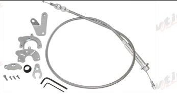

Old thread, but I have the same issue now in October 2024.
Just bought a Monte Carlo SS and need to connect a 700r4 to 5.3 truck motor.
Does the bowtie overdrives kit still exist?
Is this the correct kit to use?
https://www.bowtieoverdrives.com/cat...BCAT&CATID=WA5
