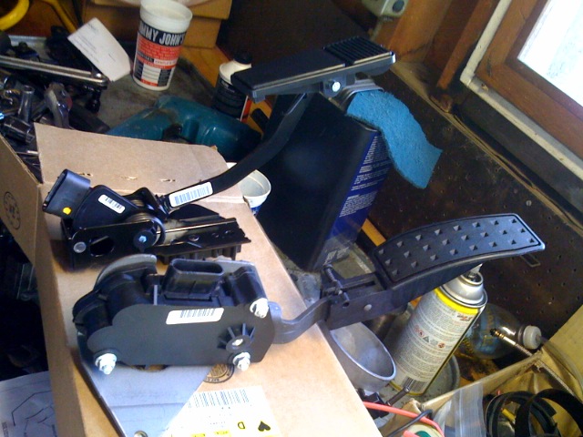

There should be a 3 letter code, like E67, etc...
You do not need a controller, just the pedal. I will sell you the pedal on the right in the picture, cheap.
The pedal on the left is the Monte Carlo SS pedal. Double check that you have an oval connector with 6 pins.

That pedal is ******* awful. I don't know what GM was thinking when they included it in the harness kit.
I can actually take a picture of it in my FC.
Andrew

P.S. We typically use the C6 Corvette pedal here at work. It fit great in my FD. Look at the last pics of the first post. It shows the Corvette pedal with a chromed up footplate.

yea that doesn't look too bad. I would still have to modify it to fit the pedals I have in the car but I think that might be doable. How much do these pedals cost? I was reading on here that they need controllers to work? Is this not true?
