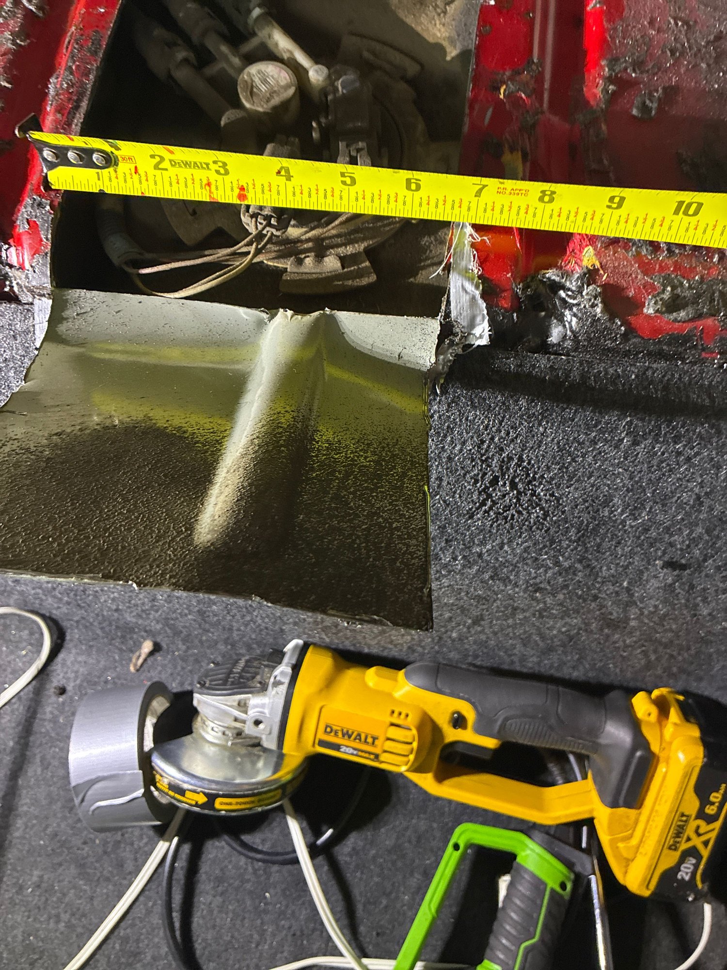

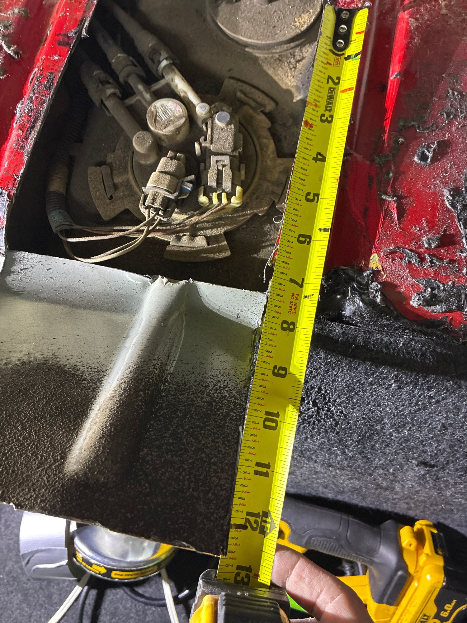

The measurements that were going around, I duplicated it on the floor in my convertible Trans Am using those two big creases off the center and I come up with 6 1/2 by almost 9 inches long. I’m gonna send a photo if someone can get back to me I would appreciate it. Let me know that I am definitely on the right track. I would appreciate it. Thank you so much for everyone’s time on this. It’s just that before I cut. I really want to get other people‘s opinions to be a photo attached.

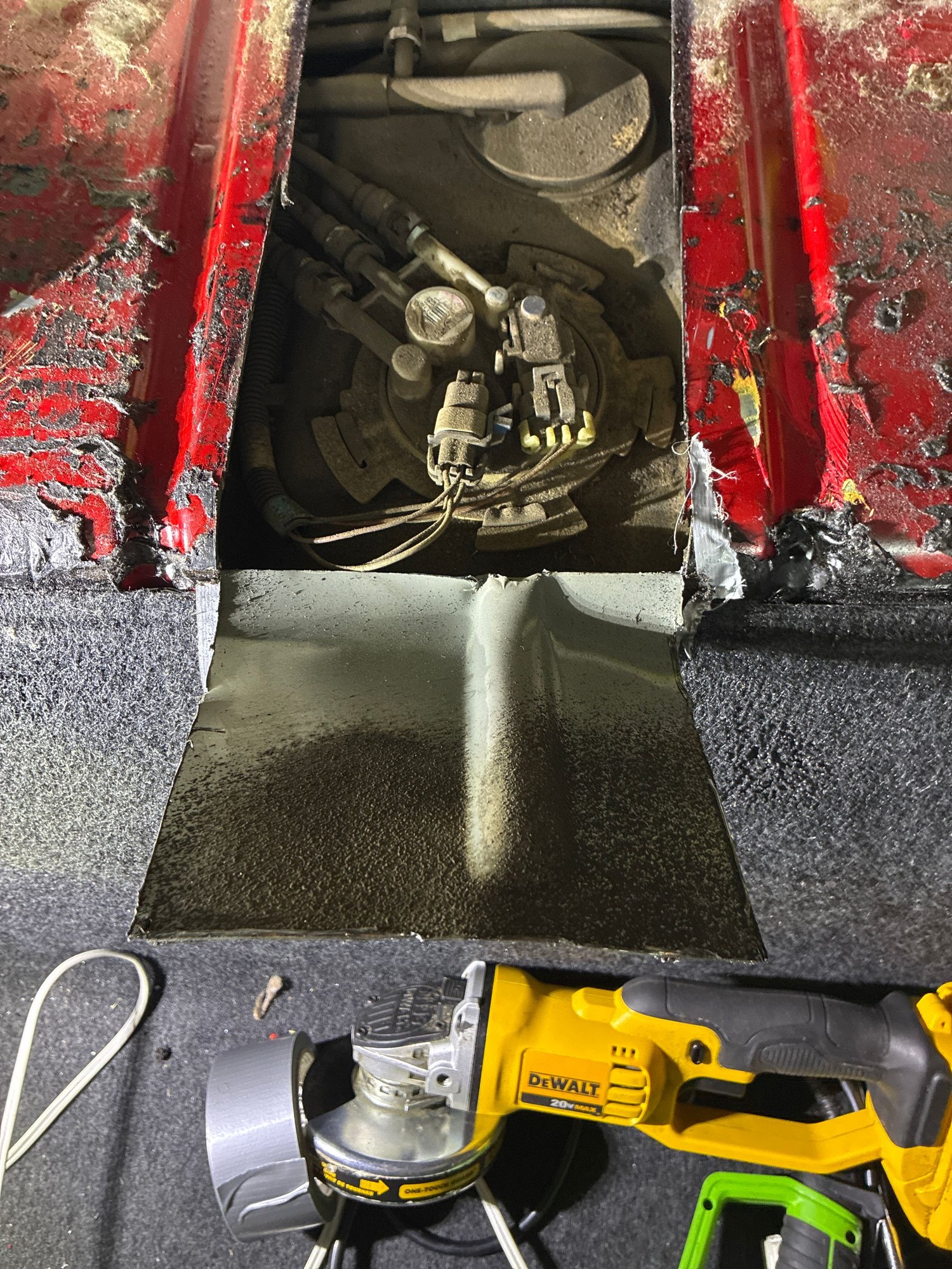

The cut on a GEN 4F body convertible with the updated plastic fuel tank (ONLY) will be when the sheet metal bends down to the thing they call a trunk from there. You want to measure of the crease 6 1/2 inches to both sides of decrease. I will have photos to better understand what this all means the measurements that are posted are for the metal tank which are correct for that application but if your tank is the plastic tank, then the measurements I’m posting are correct which is for the plastic tank 99 to 2002 always always ask around to get the correct tank application on the plastic tank The pump further back towards the the bend on the panel ( see photos )
7 1/4 inches up to the backseat on both sides using those two creases that are even the floor pan has guide you want to measure approximately.

Nice job, thanks for the follow-up. So its about as far back as you can get on the flat portion of the hump over the tank, and nearly to the ribs on each side.

The cut on a GEN 4F body convertible...don’t cut from the specs that the people are showing out there. You’re gonna be up by the canister no way near the pump.
To be clear for anyone else reading this in the future, the above is incorrect. The specs & pics (higher cut location) shown earlier in this thread are absolutely correct - for a 1993-'98 car. It has nothing to do with being a convertible, nothing at all. The difference is that you have a 1999-2002 car. That is the difference. But you are correct about the lower cut location for your 2002 (as well as every other 1999-2002 car).
Again, being a convertible has nothing to do with it. It's all about model year and the fact that GM changed the gas tank for the later cars. If you had a 1998 convertible and cut in that lower location, you would find it was incorrect.
