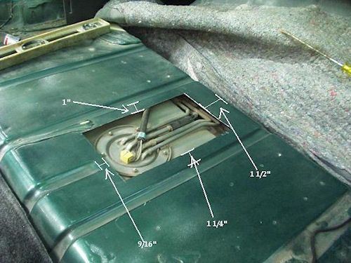

Thanks for the update. After having done this, do you think there would also be room to do this on a 1998 or earlier? Here are images of the cut location for the earlier steel tank cars as reference, it's closer to the back seat:

Here I was thinking I hope to god I never have to cross this Rubicon in my car, then RPM_WS6 goes and posts those pictures of exactly where to cut for a pre '99 car, WITH MEASUREMENTS, That looks MUCH less daunting than dropping the axle to get the tank out. Thanks bud, now I have one less excuse to avoid this job.
