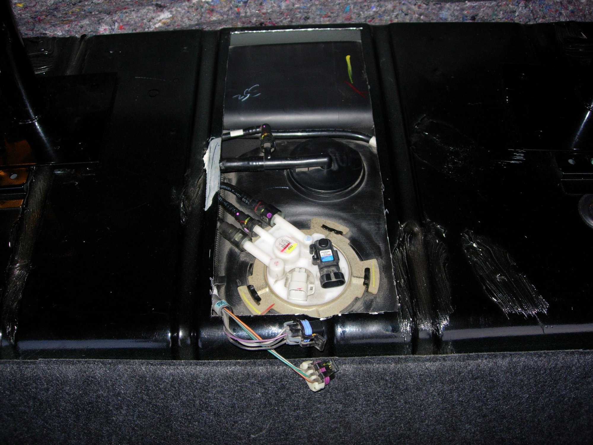

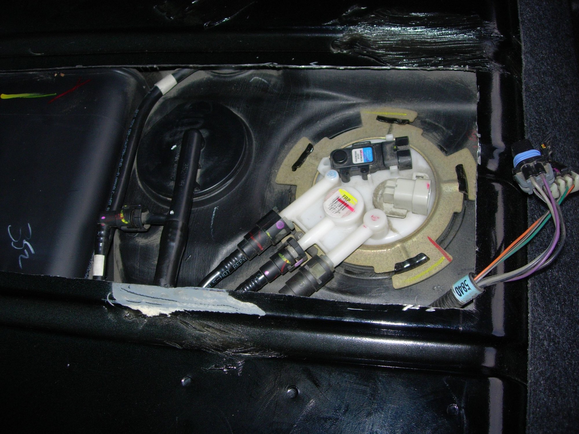

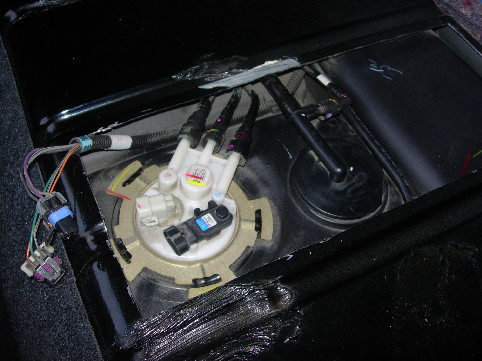

Just did it this last weekend..... On my convertible. Its a 2001 but yes it will work. You will have more room to pull pump in a 98 since the pump is more towards the seat back on that year.
