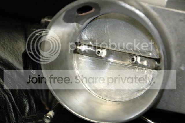

I ported and polished my TB last weekend. I have seen a million pictures of the F-body TB. Does any one have pictures of the vette TB after being ported and polished. I am just curious to see how my work looks compared to some others. I have noticed alot of people just port them and do not polish. After I removed all the material and smoothed with a fine grit I went over with polish compound and buffed it. Thanks

ported only:

Thats a good job bro. My Tb is different, so I am assuming the Z06 had a different Tb? The inside of my Tb was shaped differently on the inside and had larger holes on the inside.
Thanks. Your Z06 TB is the same as in the pic. It will have just one opening instead of two as on the F-body TB. To take it apart you'll need security pin torx bits.

Ok I looked at your picture a little more carefully. You used epoxy and from the angle it looked dissimilar to me. I see now..

those that filled the void area with epoxy, did you just drill the hole back into it after it dried?
Yep, 1/4 inch drill bit.
