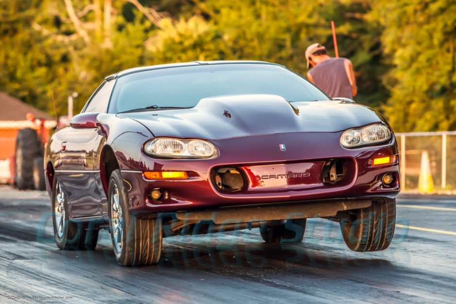

I have timeslips/pics/videos to prove everything. The car is a sleeper on the 16 inch snowflakes. Said pic.......
