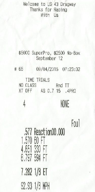

Default 383 stroker time
3600 race weight
strange s60 w/3:73's (35 spline axles)
a4 w/ 3k stall (PTC)
26 inch hoosier DR
Why will this car not mph???

small stall for 1/8 mile on a relatively heavy car for a 4th gen active racer...

So the stall accounts for a 3-4mph drop?
Should the car not be trapping 96 or better?

a higher stall will help it get into the meat of the powerband quicker and stay there throughout the pass , no I am not saying it will add 3-4 mph to the trap by itself but it will help.Scott5 brought up cam , you didn't mention cam but sice you put the effort to do a stroker motor if you also did a cam upgrade they will be a turd without a stall that lets it quickly match rpm to that cams powerband (usually 4000 stall or higher for optimal with aftermarket cam which generally raises powerband across the board including needing to rev higher than stock cammed setups)
Like HCI2000ss is saying what was the DA , poor da can easily rob a couple mph as well. Drag Times da calculator doesn't list that track (us43) but I grabbed the same time from your time slip(7:00) , same day (9/4/15) at another track in TN and it was 88* and the da was terrible 3100 feet.....
you also list an s60 rear end which is an awesome upgrade but has more parasitic loss than a 10 bolt but when you get your 60 foots in the sub 1.5 range its nice to have that durability.
you also mention 373's , been too many years since I had my 373 geared car to the track (stock internals full weight 1.8 60 ft 7.7@90 in 1/8 12.1 @112 1/4 mile) but I imagine your crossing the traps in 2nd ? at what rpm ? to optimize for 8th it should be at or close to redline crossing the traps.
