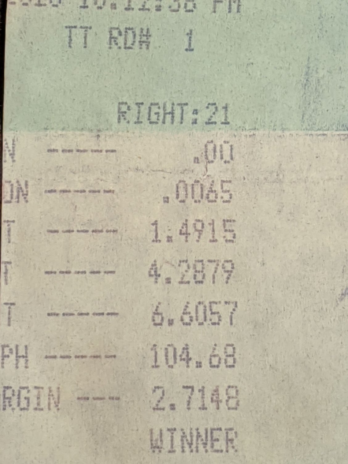

Finally a good first round.
Forged 5.7
Lingenfelter ported 243 heads
Fast 90 mm intake
90 mm TB
242/248 110 lsa cam
Yank 3600 stall
Longtubes with 3 inch exhaust with cutout
Sam Miller tuned
Lightened car

6.60 is rolling for a NA 5.7!

Thats blasting. Have you ever weighed the car ?

Damn that’s a healthy cam for a ls1! Similar to the size I’m going with in my stroker engine lol nice run! Curious to the weight of the car too
Old Sep 6, 2020 | 06:58 PM
qweedqwag's Avatar
Joined: Dec 2016
Posts: 665
Car weighs 3200 lbs. Yep,cam is a little big, i will be changing it out next season. It still runs well tuning is everything.

With that mph I don't know that I'd change the cam

Prolly not smaller but with a different lobe profile so it's easier on the valve train, this cam is an old comp cam called Trex. it kinda slams the valves closed

Well. let me rephrase, its older technology, Cam motion has almost the same cam but it's easier on the valve train, Also I need a cam with more vacuum, I have shitty brakes as this cam is making 8 inches of vacuum, it needs a least 16 to make the brakes work better. Is there a way to make to tune in more vacuum?
