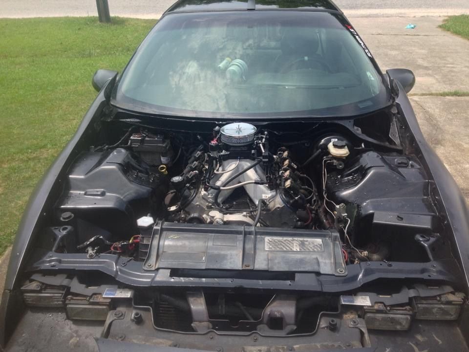

Aren't race car's fun haha. Your clean up looks good! I had to ditch my passenger wiper when I SBC swapped mine, plus it has a tall single plane. I ended up fabing up a pivot to run the linkage back so I could keep one wiper for that just in case moment, and some of the random street car class rules around here say you have to have functioning wipers to run in the lower classes. I'll see if I can find a picture of how I did mine.

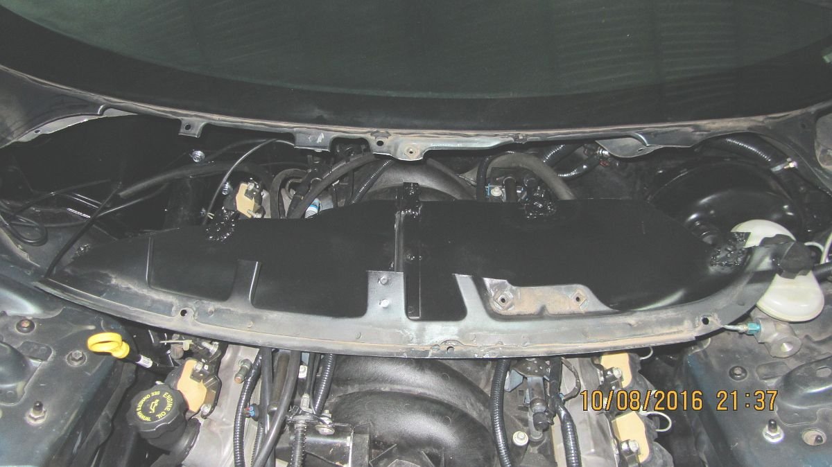

I cut mine out in one piece when the engine was out and welded tabs to it so it bolts back in and the wipers all go back in and work like standard. I keep the cowl/wipers removed when I know I'm going to be messing with the engine or racing.

There's 5 tabs across the bottom section in total and they sit above the sheetmetal on the car, and it slots in nicely and I also welded nuts to the tabs so it just bolts straight in with M8 bolts, no need to hold the nut. The two tabs on the outer far edges (difficult to see the left one in that pic) do a great job of keeping it from sagging. Once the wiper arm is bolted on in the middle, it ties it together so well that's it's literally as solid as never having been cut. My wipers work 100%. And the plastic can go on if I want it to. GM should have made them this way to be removable.

So I only got the one picture, I'd have to take off the wiper arm and the plastic cowling but this should give you an idea of what I did. After a bunch of scrolling and searching I found this you tube video
and this thread https://ls1tech.com/forums/drag-raci...pers-carb.html I combined the Ideas in both and hacked the whole wiper mount off and made my own pivot/holder for the original pivot mechanism. I attached it to the cowl with some screws, careful this right under your dash pad...I shortened the two connecting rods to get the correct amount of travel, it took some time and I kept having issues with the ball and socket mounts popping out when a load was placed on them. I got some super cheap small 1/4x20 rod ends so I could bolt it all together, works like a freaking champ.

^ that's a good idea for single plane intake setups.

Thanks guys, that picture is with the bow tie vortec style intake, the vortec's for whatever reason have a slightly higher carb height to begin with vs a traditional SBC. Plus it's a tall *** intake, I could of BARELY kept the wiper with the carb but no air cleaner would come close to fitting. A few weeks ago I swapped over to a regular SBC victor JR intake and it's about an inch shorter so now I can run a full 3" air filter.
